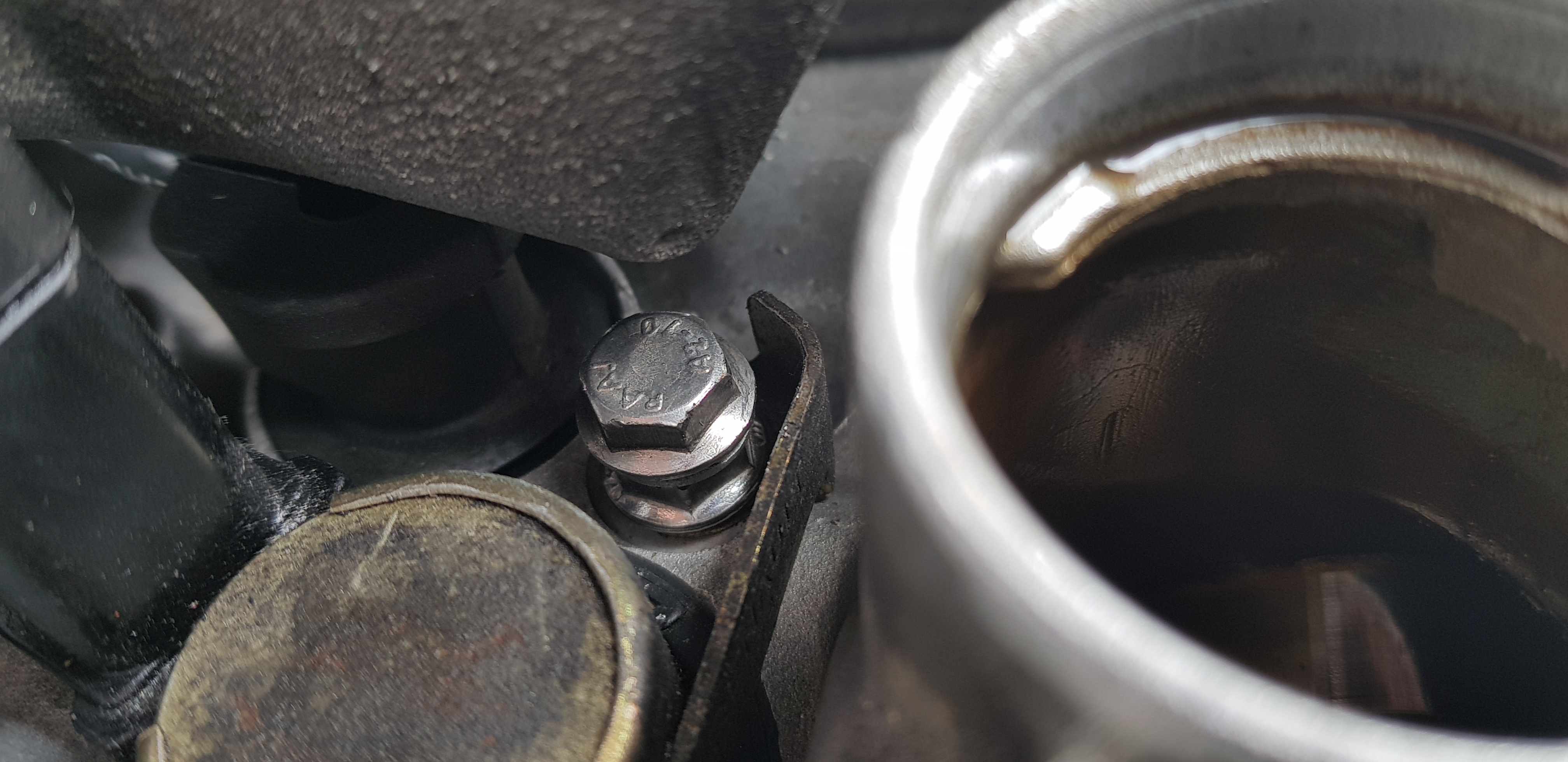

I'm at cadwell park. I was giving the engine a check before going back out and I noticed the dephaser bolt is missing. How serious is this? Can I run without it? And does anyone know what size it is?

Ok its held in place by the seal, could nick a bolt out the inlet manifold i think.
Its an M6 bolt about 1 cm long. Most of the engine bay bolts are this size - take the bolt off the panel behind the brake reservoir in the engine bay and use that.

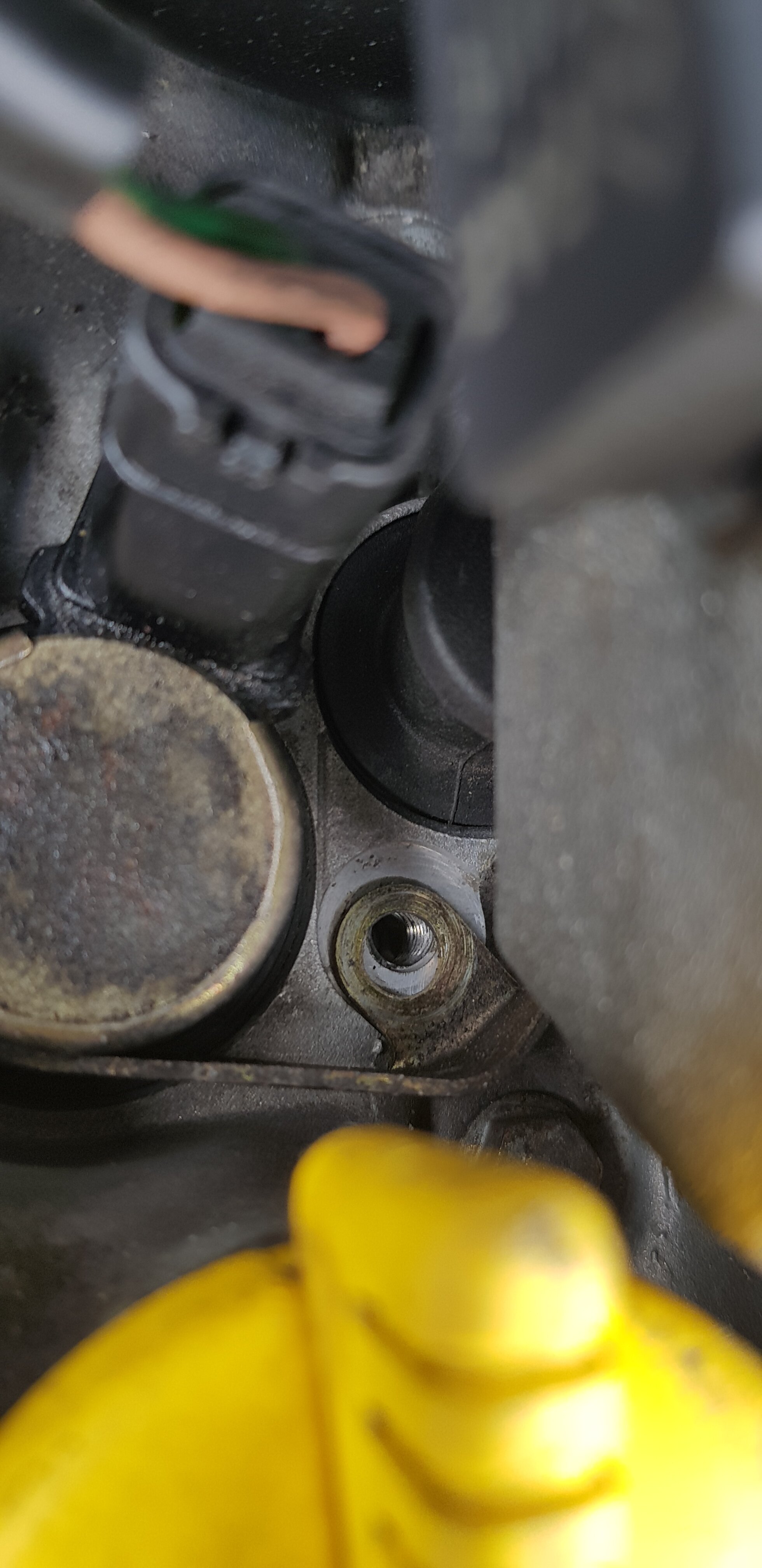

Thanks, I've managed to bodge it with a longer bolt and a nut. Definitely easier to do with the inlet off!
