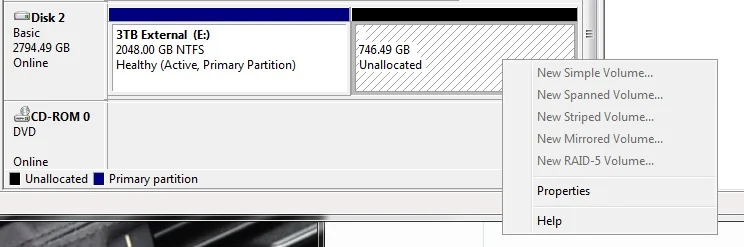

Shows as 2048GB NTFS and 746.49GB Unallocated

There isn't an option to do so.
I think its because I formatted it to mbr which can't go above 2tb and I should have used gpt. But I don't know how to get back to gpt.
