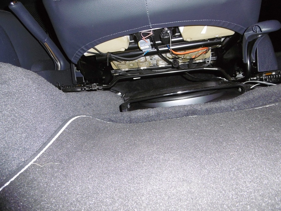

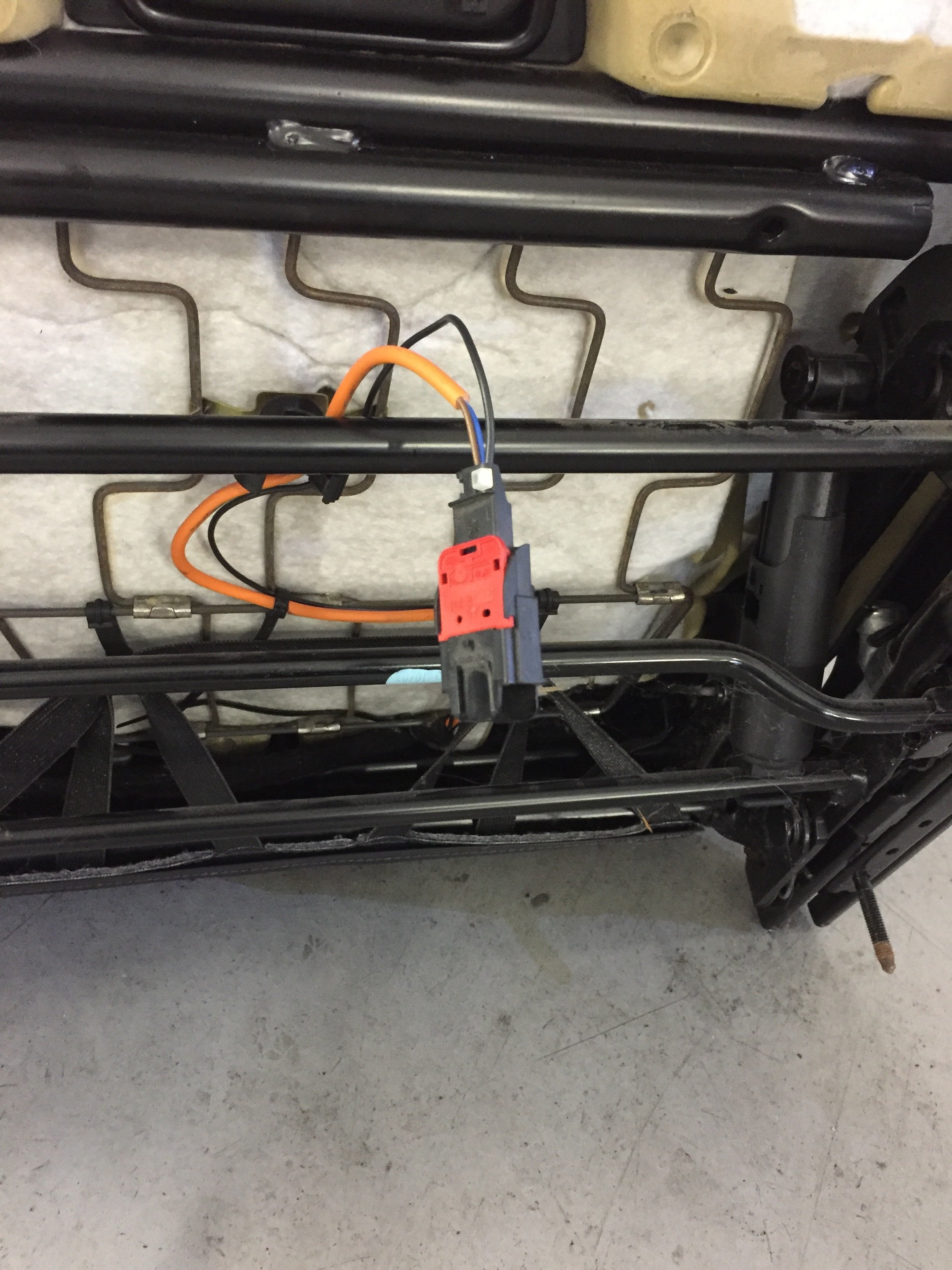

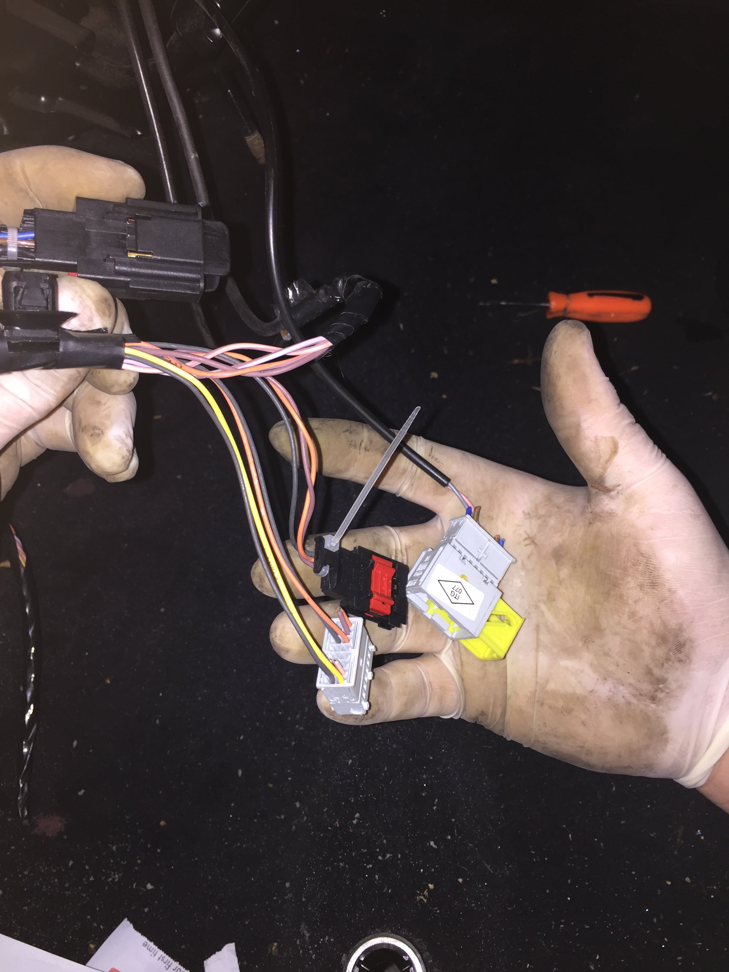

Replacing my seats for other standard seats, 172. Can anyone tell me what each of these plugs/wires are? It looks like theyve been fiddled with before. Its the same on both sides.
The new seats just have the one plug..
Help please, i'm in a cold garage! :(
So the old owner of my car has fucked the old wiring, and the old owner of the seats has kindly just cut the seat sensor and pretensioer.. What do i do :(

I will try and find a better pic but that is a standard 182.
Looks like your car's wiring is for seats with airbags built in (i.e. half leather/alcantara) and the new seats don't have airbags?
I managed to fix it. Well my friend did. Both seats had airbags, so that wasn't the problem. He ended up snapping off the seat position sensors from my old seats and reconnecting them to the new seats, and made up all the wires. He also did something with the pretensions and used my old seat belt sockets. All lights off and all working as they should. Still no idea why my old seats had cut wires hanging out of the plugs though!
