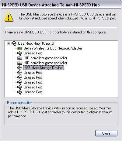

For some reason all of my USB ports are running USB 1.1 drivers, no hi-speed 2.0 :(
Everytime I put a USB device in, it reminds me :dapprove:
Is this easily resolved?

After installing 'NVIDIA nForce 550/570/570/590 SLI System Drivers', then inserting a USB Device:

Still using 1.0 then it seems. Go to the Nvidia site and try the latest drivers there rather than manufacturers site. One thing that might be worth trying is boot into safe mode and remove all the USB devices/hubs from Device manager.
Also check the BIOS some boards I have seen have an option to enable/disable USB 2.0
