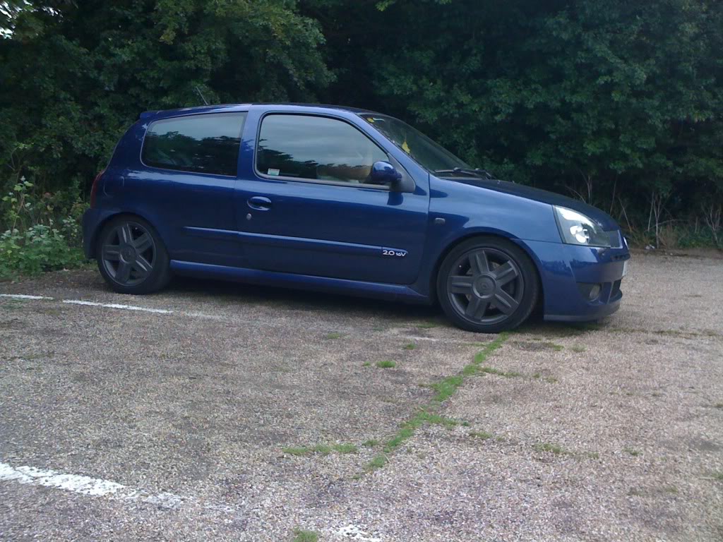

Mines like this at the mo on just Eibach's (I think)
Edit I have pretty coloured diamonds on the caps now :) ;)
