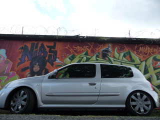

wound all the way down on the rear, settled down a bit more aswel, this was after havin them on a day
