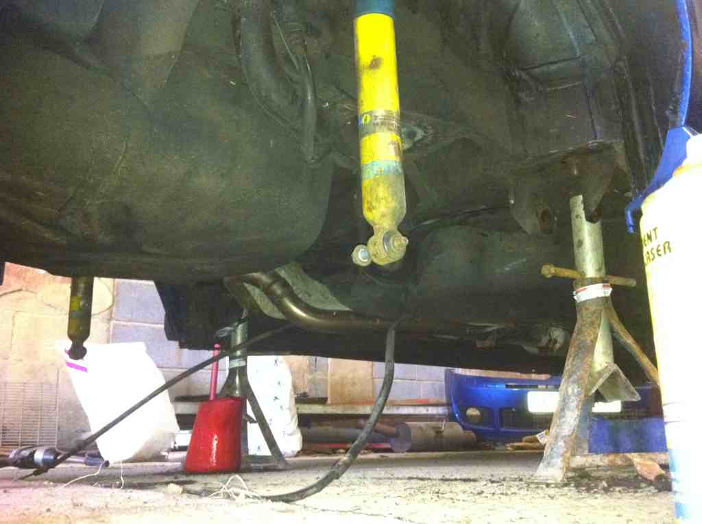

So after pulling the B14's off a few weeks ago and putting the standard suspension back on I've tracked down someone who can service the dampers. Fred at BTM is gonna send em to zee Germans
All packed and ready to go tomorrow.
going back to the standard suspension hasn't been as bad as I thought. They are pretty good standard, although the ride height looks c**p now. The car dosent feel as planted
Refurb will cost approximately £120 each, but it's better than buying new ones! I was planning on going to Oulton Park on the 17th of Feb. But I'll be waiting now just incase the Billies don't come back in time

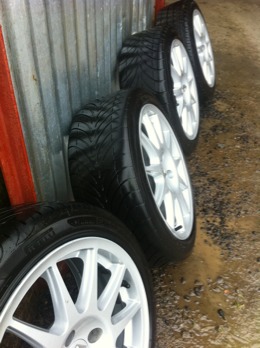

Bit of progress already -
Gave the cup a good clean before she was tucked away in the workshop

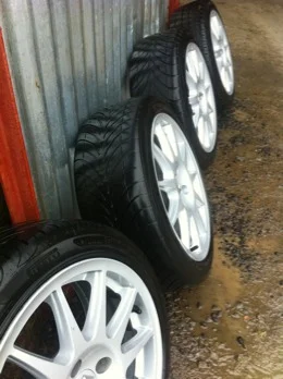

Turinis cleaned, planning on selling these. Holding them for someone who has already enquired.
They look so good! Don't wanna sell em really but no point keeping two sets for a wknd car.

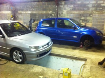

New 306 -
I was tidying it up today and while pulling the hideous back spoiler I smashed the glass to pieces!!
It's insured thank god!! Autoglass fixing it on Sunday :)
Both together - 90 bhp vs 183 ;-)

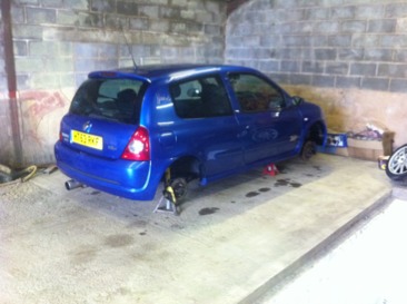

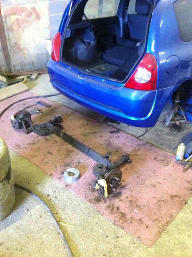

Took the rear axle off today, Bit of work getting some bolts off! Had to give Fred a quick call to see how one bolt would come out by the fuel tank. His answer was to drop the fuel tank. Job done :) cheers Fred
Plan is to sand blast it back to bare metal and Respray it yellow or red. Torn between the two really? And I might fit camber shims while it's off.

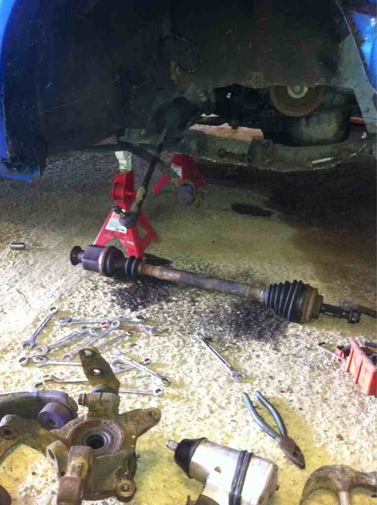

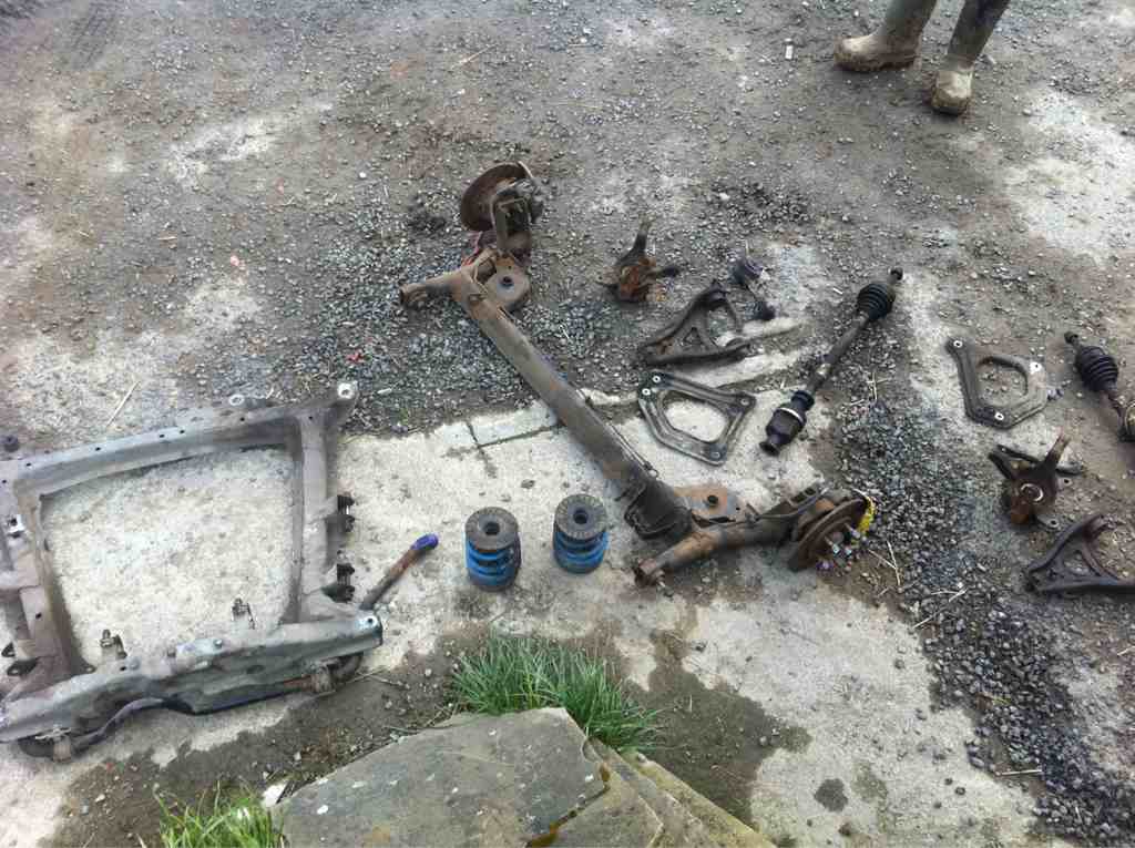

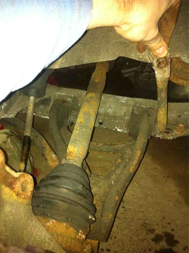

Removed the brakes, wishbone, hub and driveshafts today. Same plan as the axle really. Sandblast and paint.
I am on the verge of removing the subframe as well. Does not look too hard as I've done the hardest part (I think).
Underneath the cup will look mint all cleaned up and sprayed yellow :)
Seeing as the power steering unit is so close and easy to changeover for a dci rack I might do it. Any thoughts / opinions on this?
  172 cup RS2 - 330ci

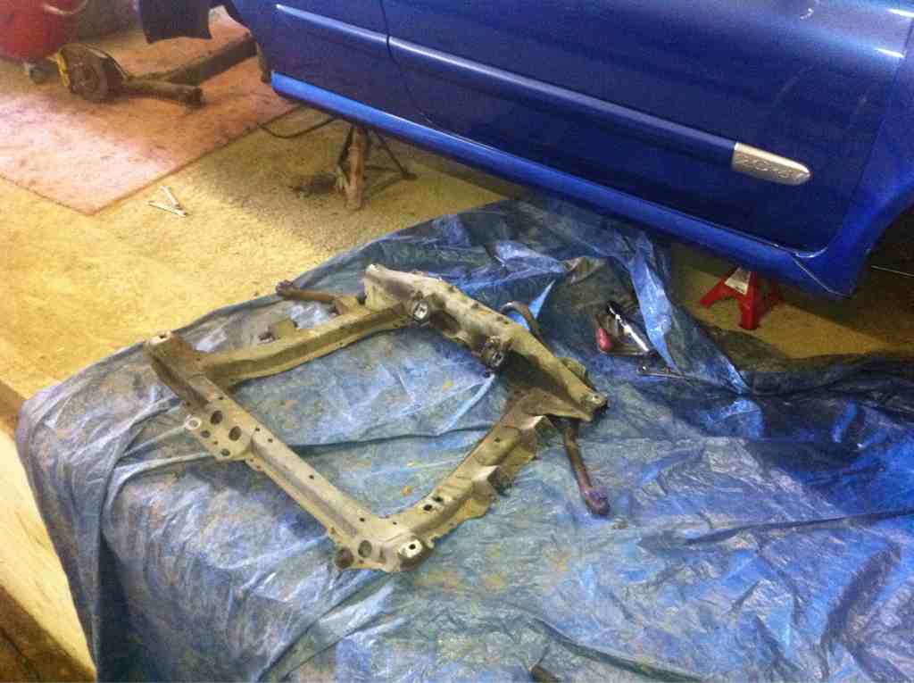

Subframe dropped today, wasn't too hard. The steering rack was the most awkward to get off. I think it will be frustrating putting it back!
Got all the parts together and steam cleaned them. Used gunk to get some grime off the same time. Need to locate a sand blaster now :)

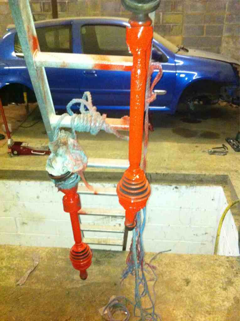

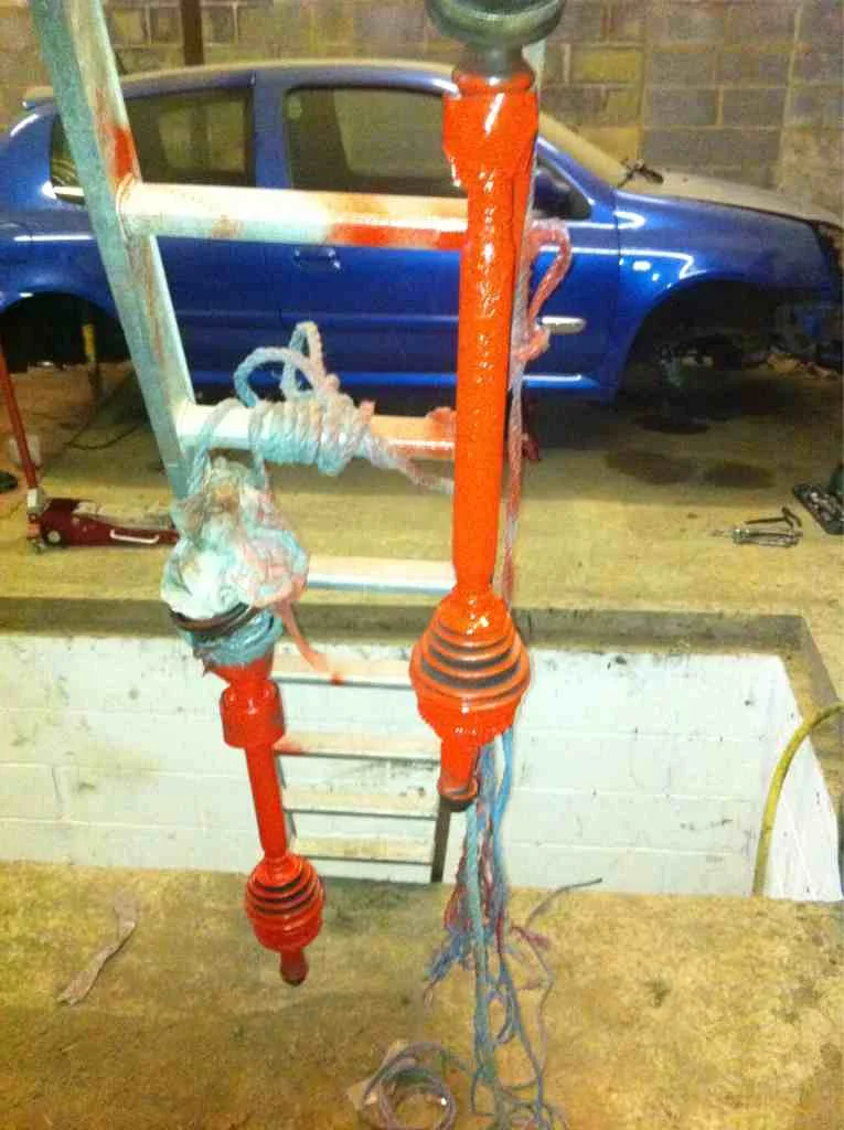

Parts have been dropped off today for blasting. I have bought bonda anti rust zinc primer, been advised it's very durable by the paint shop. As a top coat I've gone for a flashy yellow. Called Iveco IC089 Giallo Scuolabus. Hopefully the finished items will look good!
I haven't took the driveshafts as the sand would have damaged the bearings. Cleaned them up and gave them some red VHT crinkle paint
Need to change the outer cv boots before they go back on

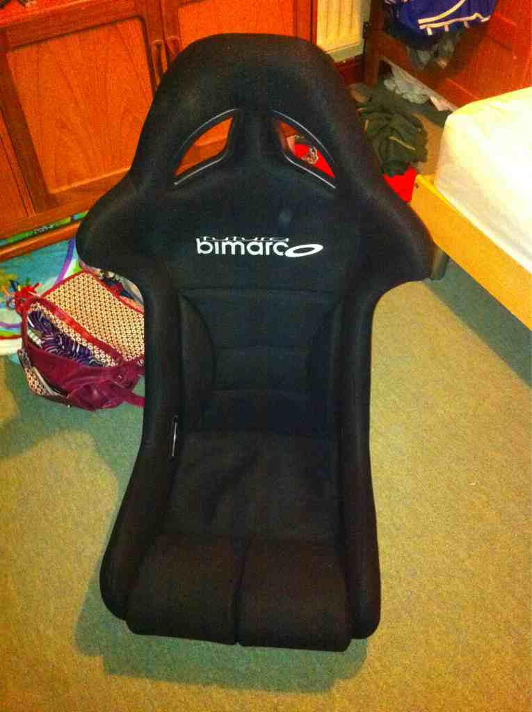

Seats have arrived :)
Been sitting in it playing forza 4. There so comfy :) Can't wait to get them fitted
