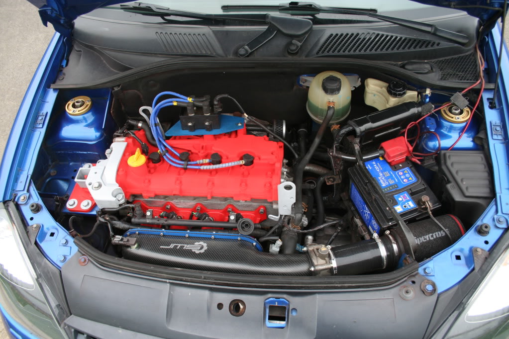

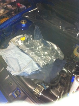

Thanks mate, I hope it will be worth the effort, I've got normal red VHT paint as opposed to the wrinkle effect, I do really like the wrinkle effect but I want the paint to match up with the manifold if I can. Cross fingers, did you do yours when the engine was cold? and then start the car up to dry the paint?
Yes mate; once it was cool enough to strip a couple of bits off it was sprayed.
Then put it back together and started it to get some heat :)

did you leave the rocker cover on whilst you painted it ?
Yeah, just made sure I covered absolutely everything in the engine bay before I started!
That's how I started it, but covered more after as it gets everywhere!! Lol

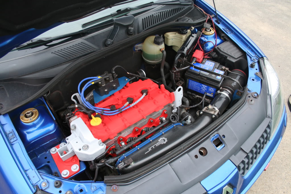

How did you get a straight line? And is it the crinkle paint stuff?
Looks good either way
Straight line with the head you mean? I just made sure I covered everywhere I didnt want the paint to hit, simple really. No this is just normal VHT Paint, I chose it as I thought it would match the Jenvey manifold better

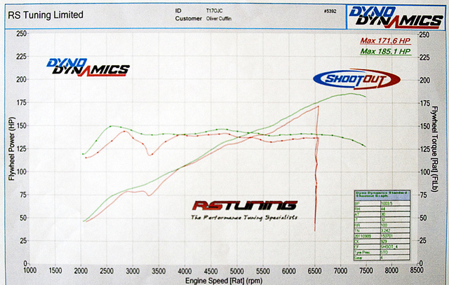

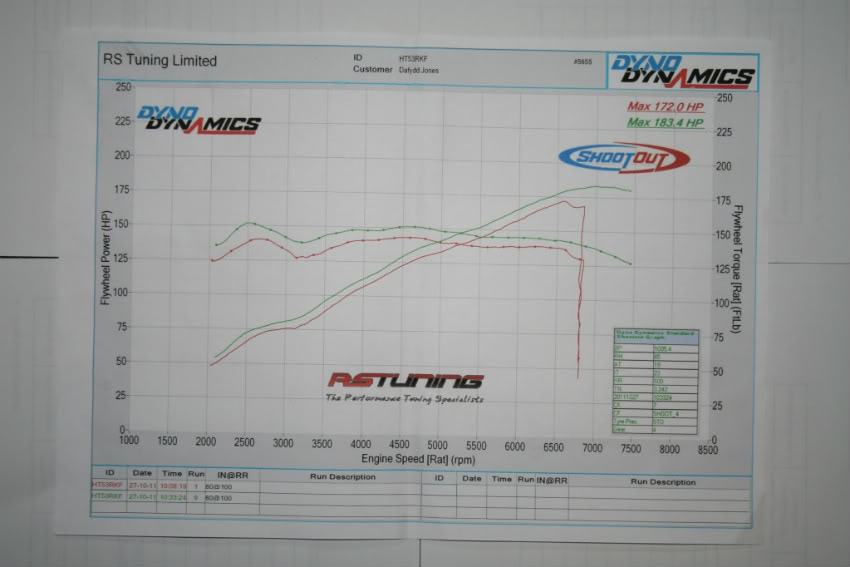

Car went on the rollers at RS Tuning on Thursday and it went on with 172bhp pre map and came out with 183.4 bhp and a max torque figure of around 155. Graphs to follow. But the car has transformed
  172 cup RS2 - 330ci
Above is the result you see above from RS Tuning, I am pretty happy with how the kit has preformed. The car pulls like a train and the new rev limit makes driving the car so much more exciting. I honestly cant wait for my next track day, I think I'll be scaring a few cars with the RS2 and R888 combination :approve:.
The car hasnt reached the higher HP of some other RS2'd cars but I have been comparing my graph with other RS2'd cars and mine seems to be strong lower down and mid range. If I'm honest I had my doubts on the RS2 setup before fittment, but you really need to drive one to understand how the power is delivered. For me it was a worthwhile investment and its put a smile on my face. If I was to go back in time I would take the same route.
