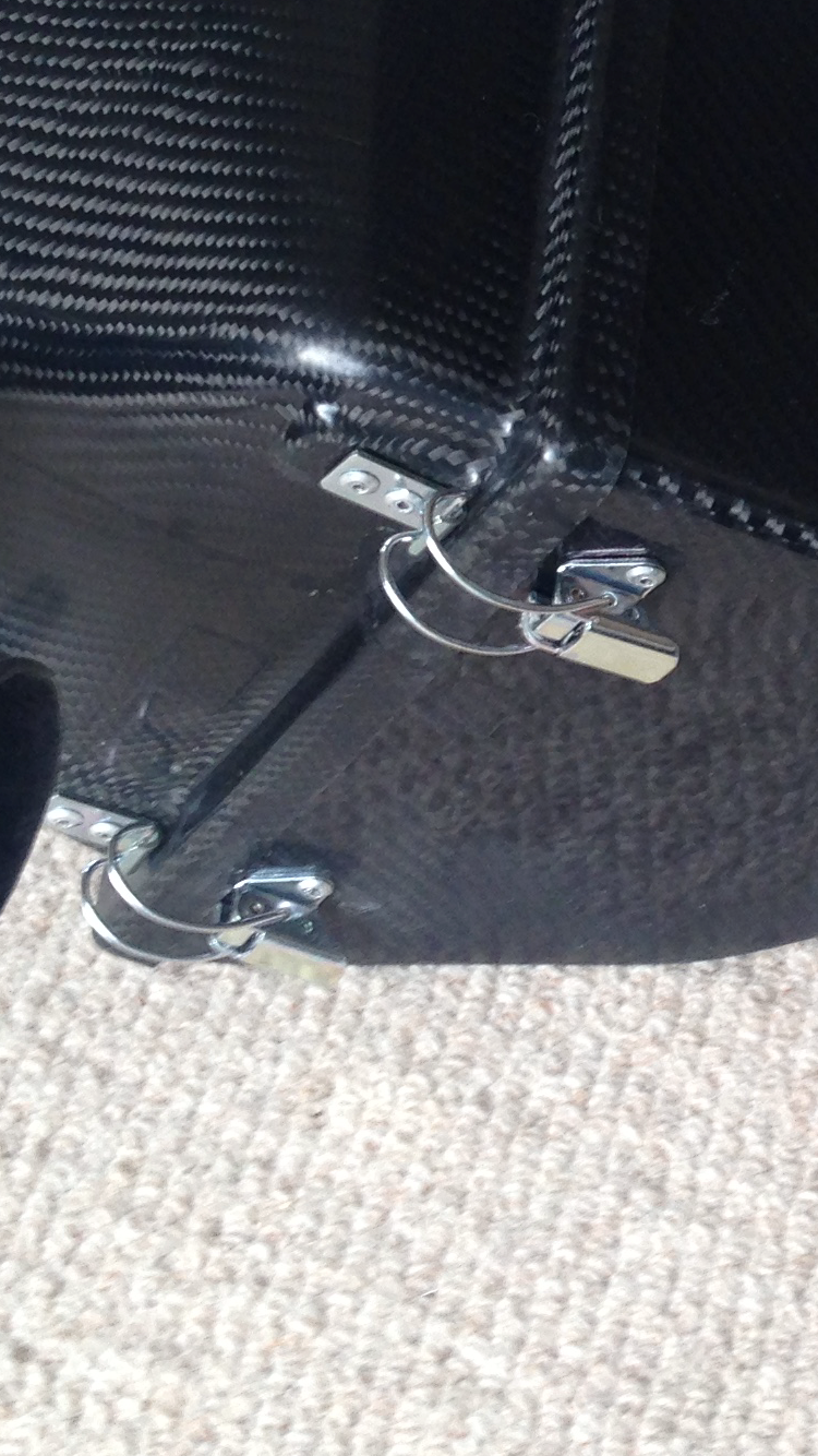

Here's how my maxi evo Carbon airbox is held together.
It's a cheap and cost effective solution.
Thanks, looks like decent solution !. Is there necesseity for additional sealing of rivets, so there would be no airleaks ?

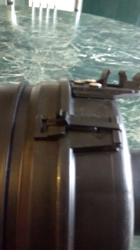

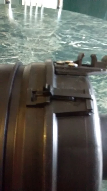

All fitted now, that's how I did it :) I have drilled small holes in upper part of the box, in the locations where original clips supposed to be attached. Then I have run zip ties through drilled holes, and the holes for the clips in the lower part. Maybe it is not completely OEM, but I guess it is ok compared to running zip ties across whole box ! :) with ties being black it is not so apparent in the engine bay. Also the integrity of the box is intact, in case I will come across original clips at some point (which I highly doubt ;) ).
