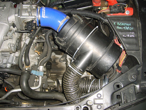

Do you just take the ducting to the bottom grill? Is there something to zip tie it to? Going to pop into renault tomorrow to get the box ordered :)
  Golf GTD Mk7
the 102 ducting won't fit down into the arch on the FF, but not sure about the cup. You'll have to remove or modify the horn location, remove the acoustic valve and see. Both easy jobs. There will be no need to zip tie as it will more than likely be a squeeeeeeeeeeeeeeeeeze.

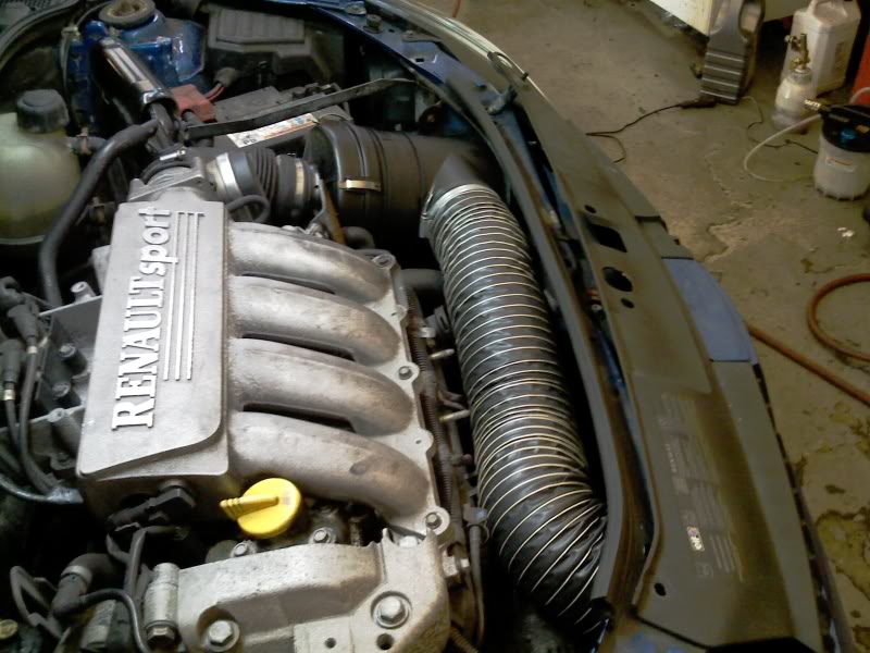

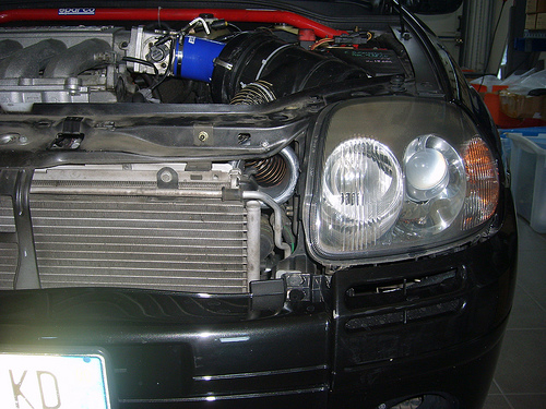

i tried to run mine down by the arch but the ducting is far too big how have people ran it past their grill? anyone got any closer pictures or can get some?
cheers

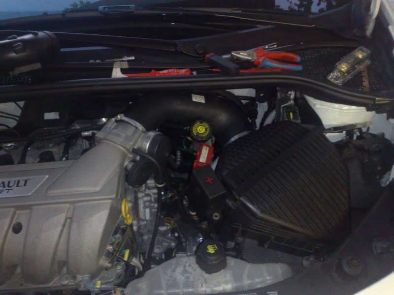

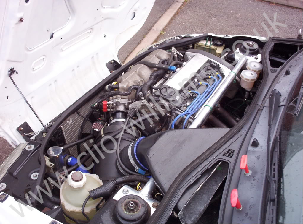

Here's mine...
With this, a Ktec stealth exhaust, R-Sport ECU, and no power-steering it gives a consistent 186 bhp. Fitting this and removing the power steering gave me 10 bhp, so that's about 3bhp or so just for this filter.
cheers

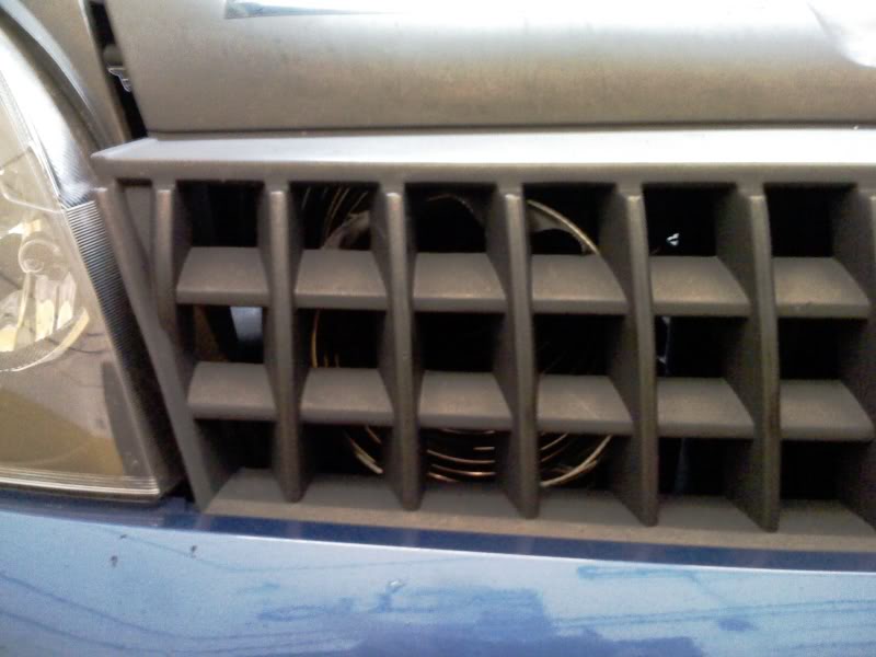

Mine ends here...
It's strictly for Cup owners only though unless you rip out your air-con.
You've got to be happy with losing the fuel rail guard as well.

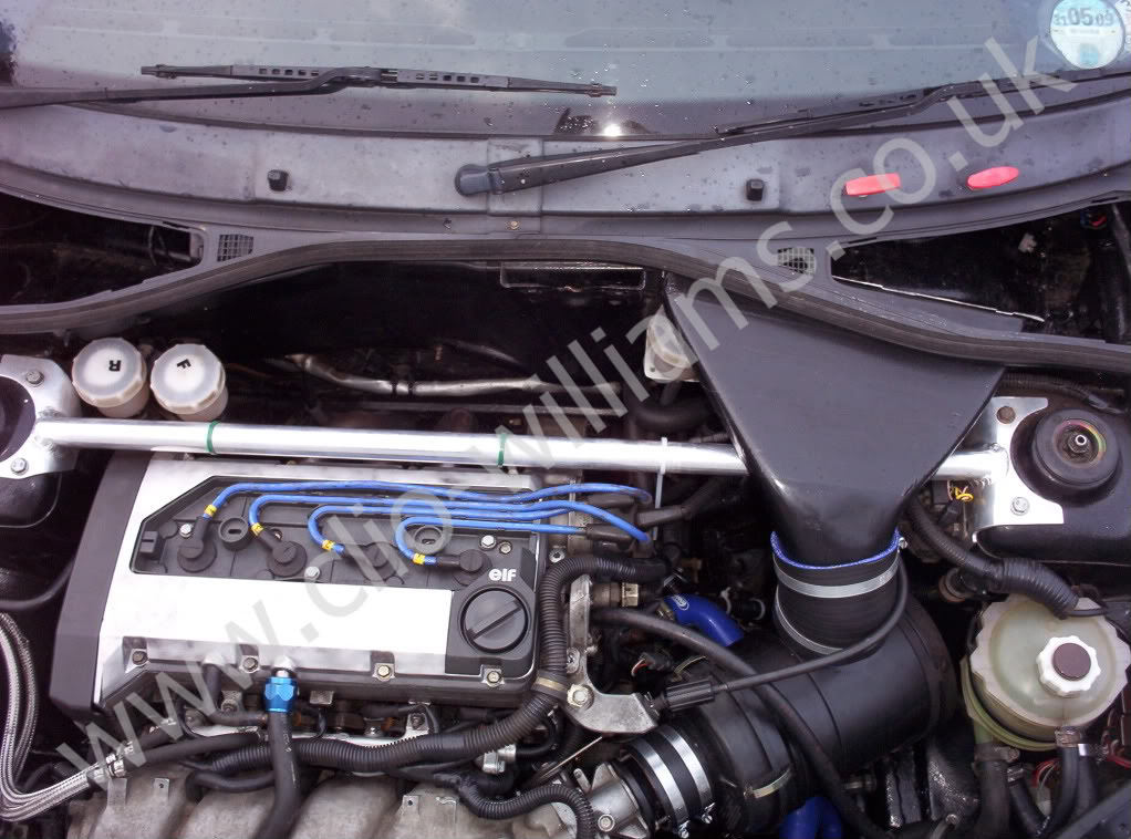

Fitted into the standard airbox location. That & a ktec stealth gave me 177bhp at Surrey Rolling Road on a 172 cup.

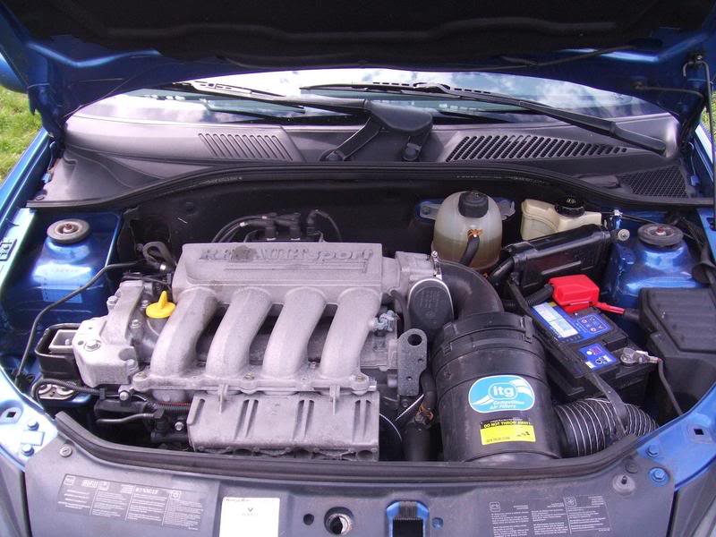

Been a while since i've been round the 'in' mods on the 172's. I used to have a Maxogen on my old Cup

I think it's better phase 1 airbox...have 2 small hole but the area are in total bigger than V6...i'ts better 2 small because the pressure remain too high...it's the same case of water...

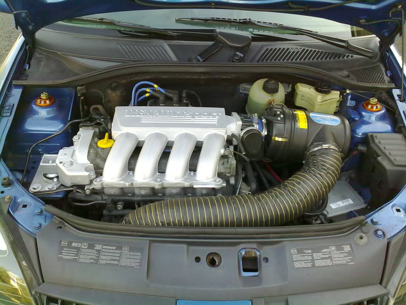

This is my setup...with the pipercross CAF
