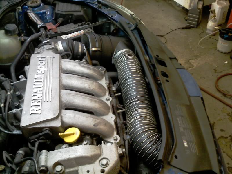

Ive tried quite a few methods, ive found that the type of piping used there which is commonly available gets very hot with the engine.

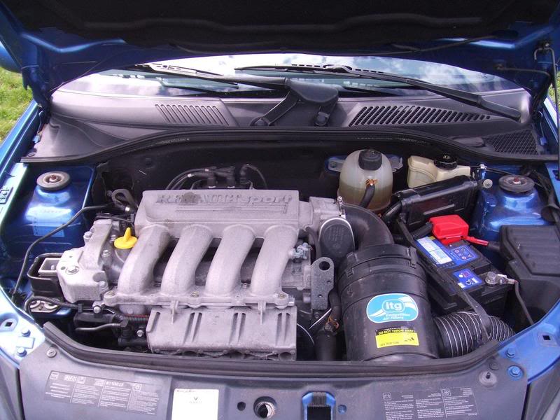

would it fit in the normal posistion? as i still have the battery under there and cant be botherd to move it for the sake of an air filter.
Is that the ali style piping?? Try getting some of the fabric stuff that comes with ITG filters, you can get it direct from ITG!
Yes the fabric made piping would be ideal, ideally the same stuff that renault use but a lot wider diameter.
Yes :)
quite a tight fit with the standard elbow, i had to move the battery as far back as possible to get mine to fit

Does anyone have any pics of this setup without having to relocate the battery to the boot to prove it fits into the standard space? Im doubtful to say the least! :)

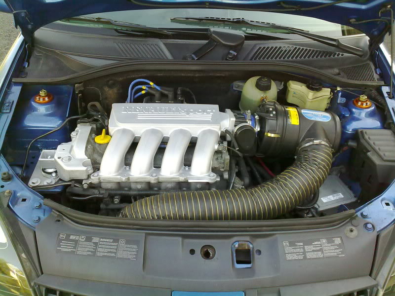

When you want to fit this box , using the standard elbow, you will have to shortern the elbow by a bit to be able to squeeze it in !

Here's mine...
With this, a Ktec stealth exhaust, R-Sport ECU, and no power-steering it gives a consistent 186 bhp. Fitting this and removing the power steering gave me 10 bhp, so that's about 3bhp or so just for this filter.
