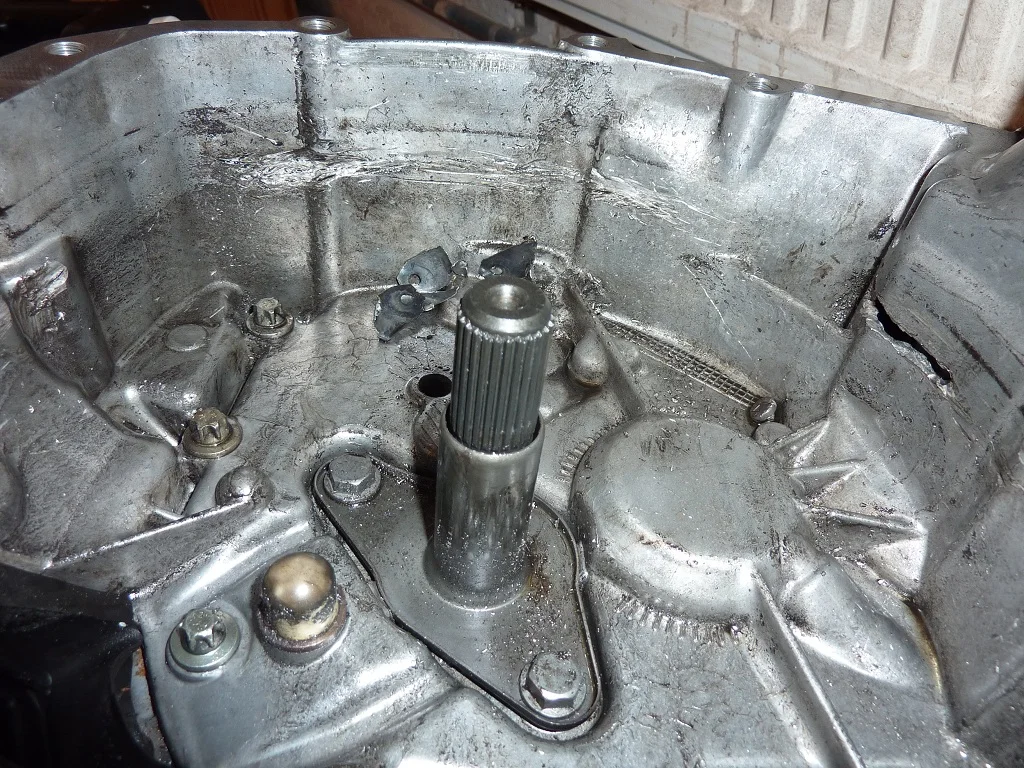

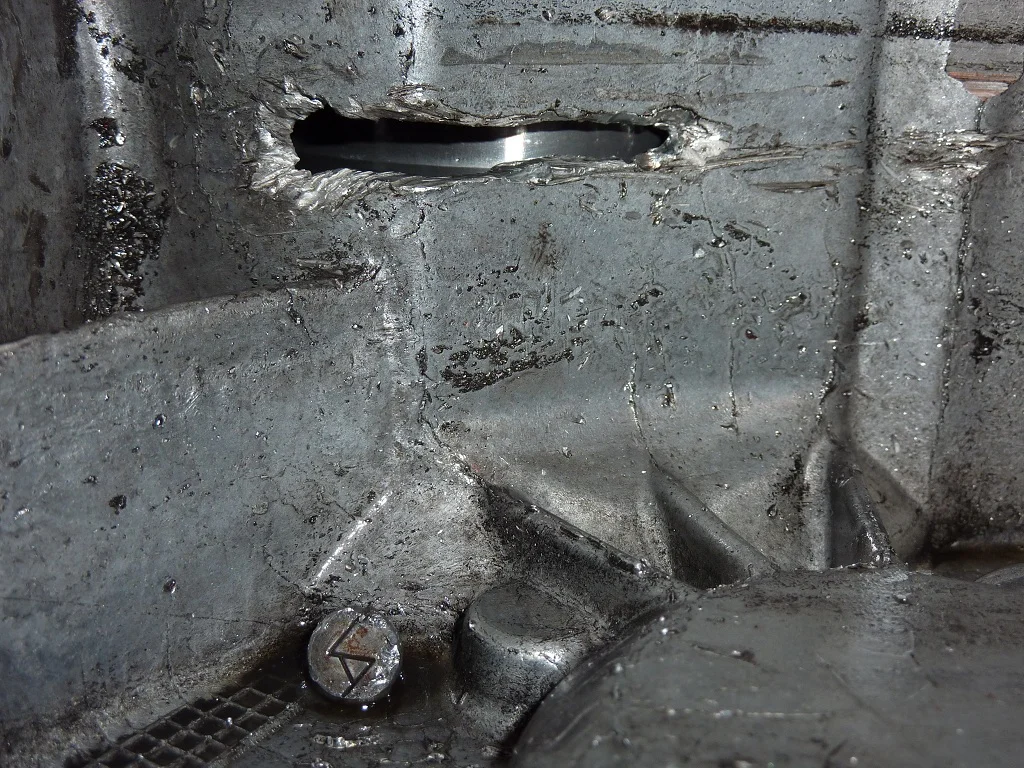

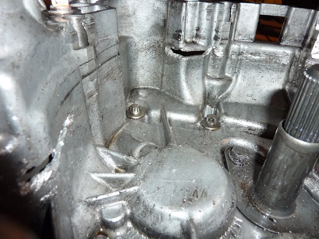

Mounted a new Valeo clutch to my car 3250km (2000miles) ago. Apparently there was something wrong with it as you can see in the pictures. A rivet had a crack in it, snapped and wasted the whole gearbox.
After waiting for more than 2½ months (!!) Valeo came with a first statement. Off cause Valeo don’t want to take any kind of responsibility, who would have guessed...
So I’ve just had it with their sh*t so I might as well show it all. So now you all know the value of Valeos product warranty and the way they treat their customers.
To be continued!

I agree I understand these things happen for every clutch manafacturer on the market occationally. But they should take responsibility for it. Thats the key thing.
Just look at it, the text is even left on it. Like brand new and still it broke. What are the odds that it started craking when in my car? Kind of slim imo.

The clutch has been bought through one of the biggest Renault specialists in UK. They have been very supportive and are on my side in this, "obvious component failure", to make a quote. Valeo and the distributor give 1year warranty, so I cant see the problem here.
Their explanation was that the car was believed to be modified. Speculation is not what i would call a good reason? Imo this is typical behavior from manufacturers when something fail. Try to stall the process as much as you can and use every loophole to avoid paying. I’m sure Valeo have their own insurances to cover these kind of things so I don’t see why they mess with this.

When the Renault gearbox warrants a torque of 200NM , the clutch (Valeo is OEM i believe) must also be ? And you are not making that torque i believe ?

No explanation at all. But it’s not too farfetched to draw the conclusion that it has something to do where I bought it. They had to say something to avoid paying so I guess they thought it was a fair chance that it actually was modified.
I will not give up, trust me.
I gave them a fair chance to solve this quiet and easy. Not saying or writing a thing about it anywhere. But now after waiting since the beginning of April (that’s when Valeo had it in their hands) and they now start f**king around I've had it.
Valeo is OEM yes.
