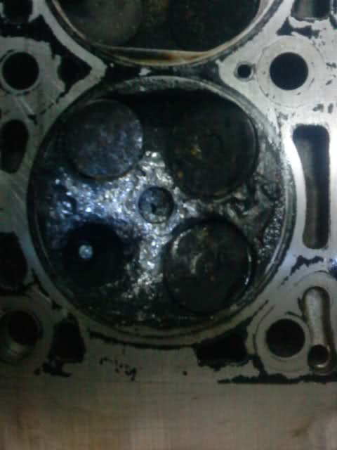

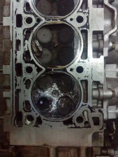

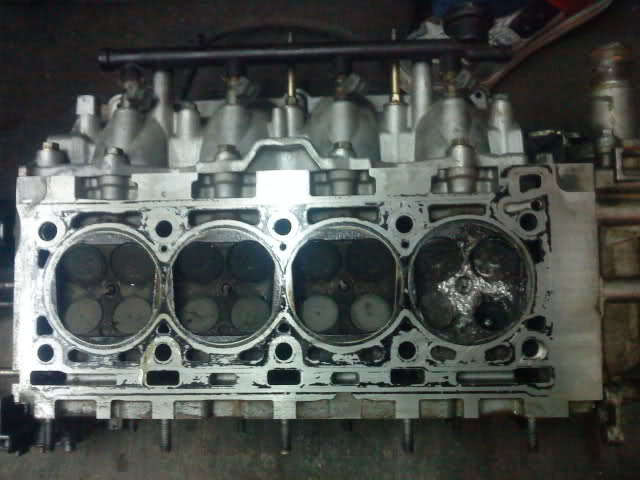

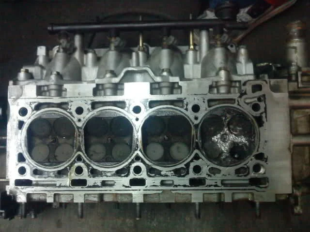

Jesus christ, the head is done for, the combustion chamber of that (the same) piston is destroyed and the piston is even worse... ill upload pics later
Exhaust valve broke at high rpm and destroyed everything, im installing the head of my street clio (including all pulleys), ill get measurements to see if the head was over-milled.
