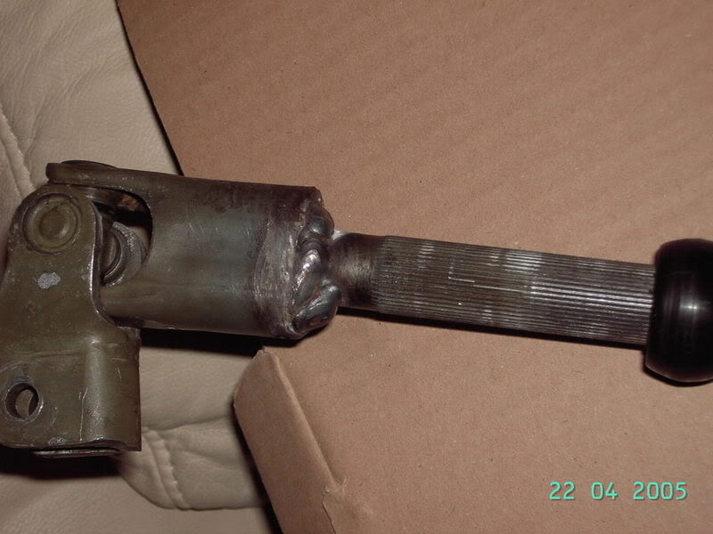

There is a Universal joint at the bottom of the column where it joins with the steering rack arm, theres a rubber bush inside that joint which wears and causes play in the steering. You can weld it in situ, or you can get hold of a 2nd hand column and change it yourself, its not that hard - I did it and i have all the mechanical prowess of a badger.
If you want to weld it however, here is where it needs to be done. Most garages wont want to weld it with the column in place however as space is tight behind the pedals and theres a nice risk of melting lots of things around the footwell.
