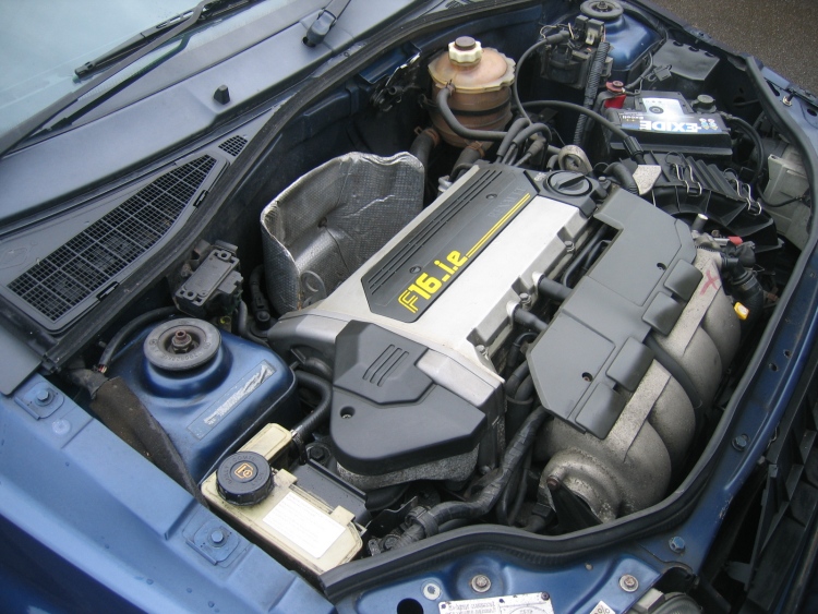

can anyone point out where the MAF sensor is? MAP Sensor? illustrate where i should be looking for leaks?
I have just been down to the car and the pipe is intact! i managed to get enough time to run the engine and see where the air noise was coming from, its coming from the Induction/throttlebody area, you get some weird popping noises too?
Just been told it could be the ISCV (Idle Speed Control Valve), and that it needs to be taken out and cleaned, any chance someone could tell me/show me where it is and what i can clean it with?
and is this it?
Hey mate if it's coming from the TB area take the airbox off and the TB, check the gasket is intact.
Also check the pipes connecting to the ISCV are intact. To clean the ISCV just disconnect it from the rubber pipes and spray lots of brake cleaner into it, while pushing the inner spindle round with a cotton bud. Keep doing this till the spindle is free from crap.
