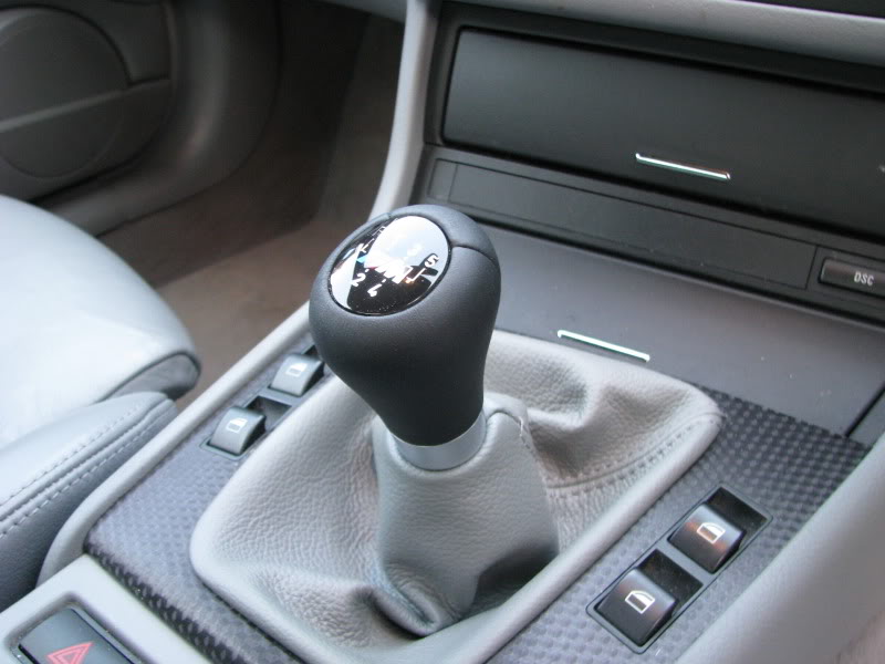

Bought some new gearknob and handbrake gaitors from a company on eBay, not genuine BMW but absolutely spot on! I ripped the old covers off, superglued the new ones on and all OEM!
Also got a clubsport gearknob which is such an improvement on the driving style!

Link to gaitor please, i have a Clubsport knob to go on as well, but dont fancy paying BMW £60 for a small piece of cows ar5e.
Dave was from here on ebay:
http://www.ebay.co.uk/itm/BMW-3-SER...arts_Vehicles_CarParts_SM&hash=item519b242a64
Might look cheap but exactly as I got above. They come with elastic fitments to go around the original frames but I'd recommend supergluing them as my dad had some beige ones in his 320 and never did glue them and it was a pain.

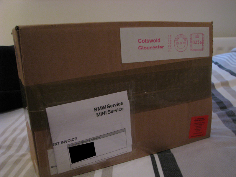

I had a few more eBay items come through the post this week!! My bargain First Aid kit from an 06 BMW and also a brand new First Aid box from CotswoldBMW.
Both look like so:

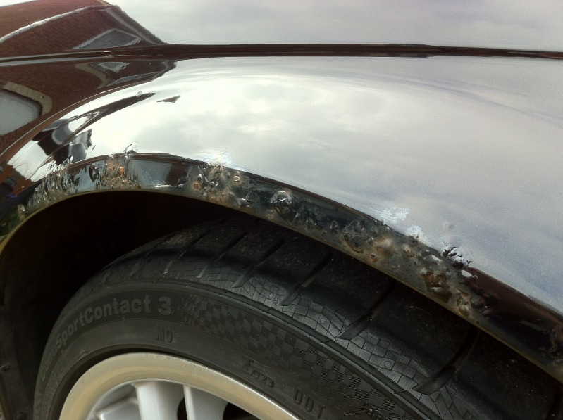

Gave me a chance to look at the rust on the wing properly...
...but don't worry, a replacement wing is all new and boxed up in the garage ;)

Amazes me how bad these Bimmers are for rusting on the front arches! I take it crap gathers around there easily?
Sir_Dave
ClioSport Trader
Yup, they're lipped, so crud gathers on the inside & they rust from the inside out. You would have thought they'd learn from the rear arches on the e36, but no ... still, its not that hard to change, bolt on, bolt off iirc.

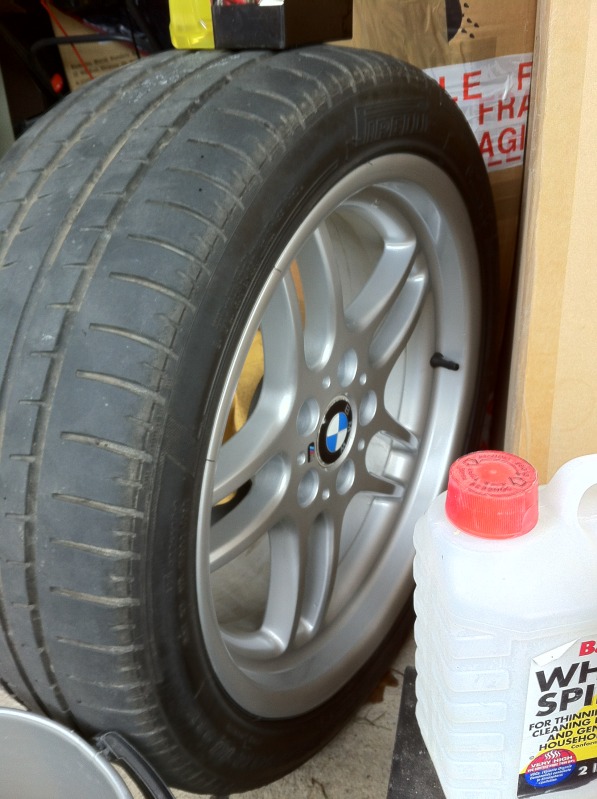

So it's been in the garage a couple times, already had the ABS sensor sorted and they've popped the sideskirt back in as I thought I'd buggered that up completely and I've bought a set of new wheels :D.
Unfortunately people ask silly prices for the MV1s individually and I needed a new wheel ASAP as it's a daily so found some nice M-Parallel reps (boo reps!).
Only problem is they're a lower offset (from a 5-series) and I'm awaiting some spigot rings to correct the centre bore!
But I should have some dish :D
Anyway, (crapp iPhone) photo time!
New Wheels

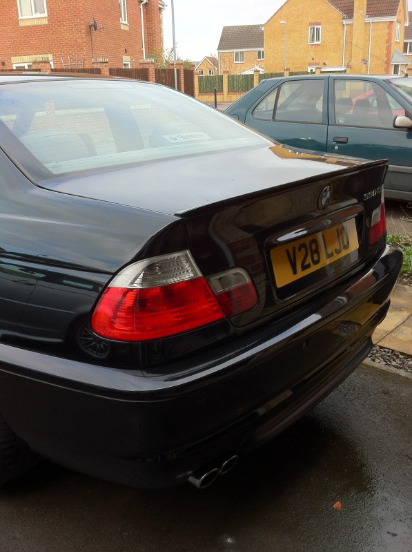

Rear, did the tail pipes which I thought were quite good

Thought I'd keep you updated with the rust!

No pics of it on the new wheels?
Shame you ruined one. Look on BM autosport, they have singles occasionally under 'USED' etc
Nah not quite yet! I daren't fit them without the spigots and it's going in the garage to get all the geometry done as the last garage I took it to were amateurs (the wheels are straight but the steering wheel is on the piss slightly and it pulls slightly so needs sorting).
Does look good though, they're an ET20 and standards are ET35 so it will be interesting to say the least, can always sell them on before MOT time!
Ouch look at that wing. I reckon mine will start to go in my time of ownership. Where did you get the gen wing from?
