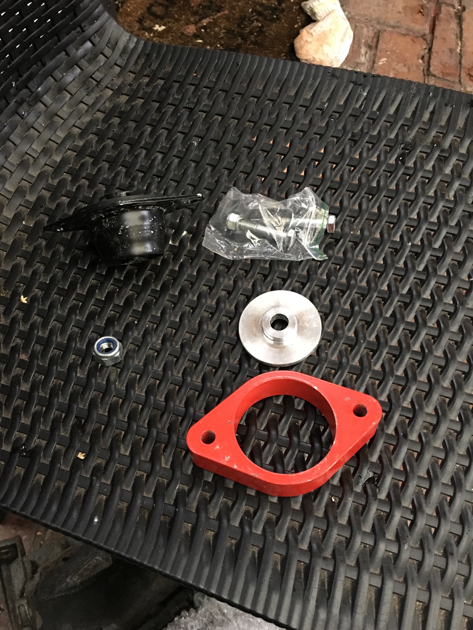

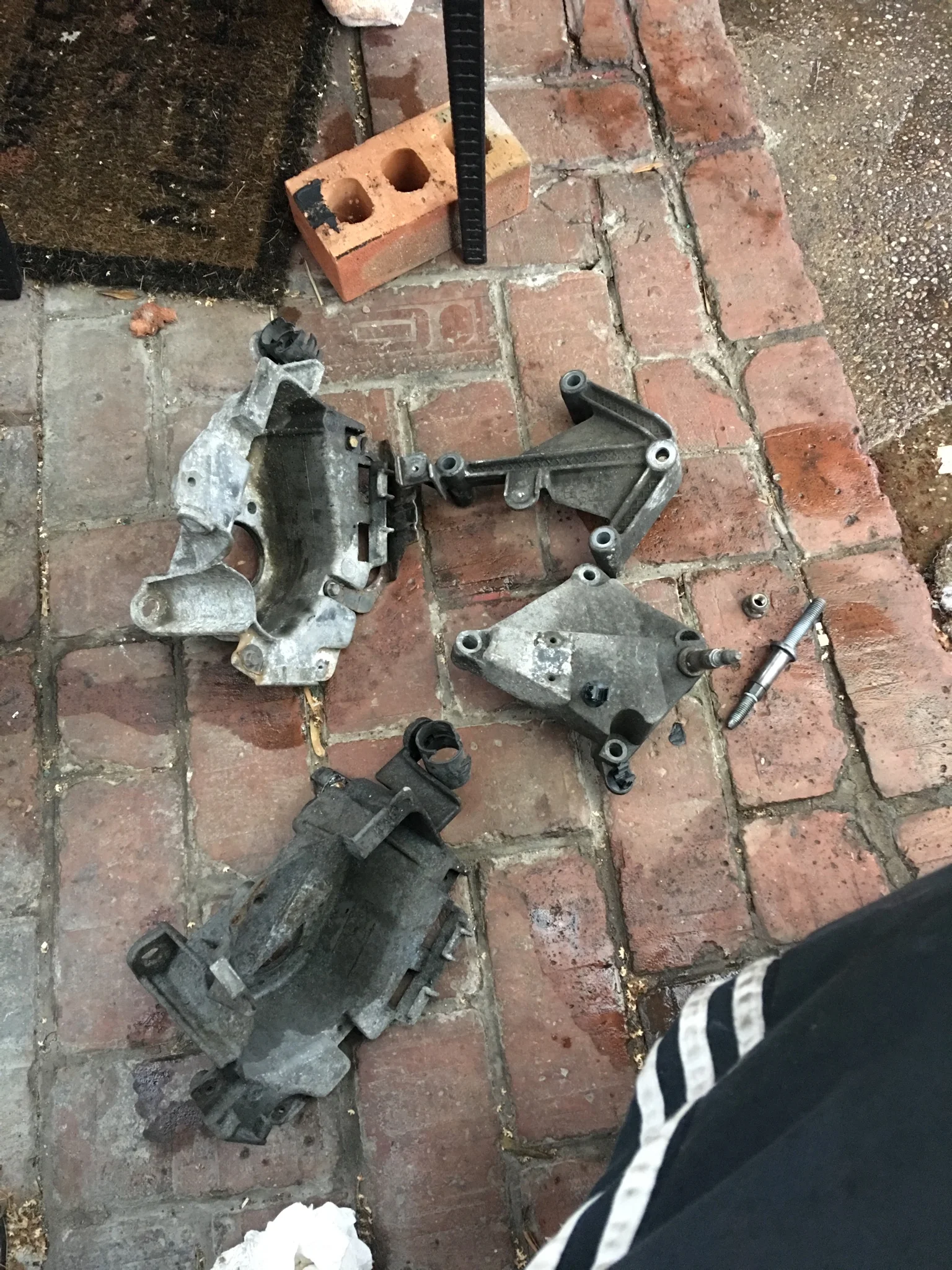

Bought a set of mounts from a member on here but unsure if it’s all there for the gearbox mount. Can see online that there appears to be another part but I don’t have it
This is what I have

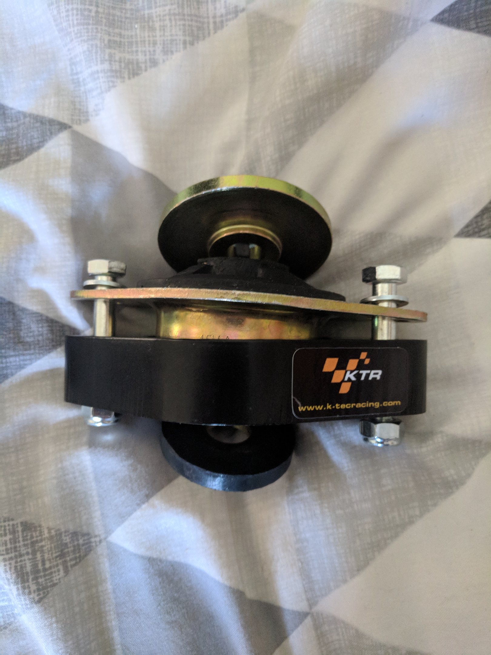

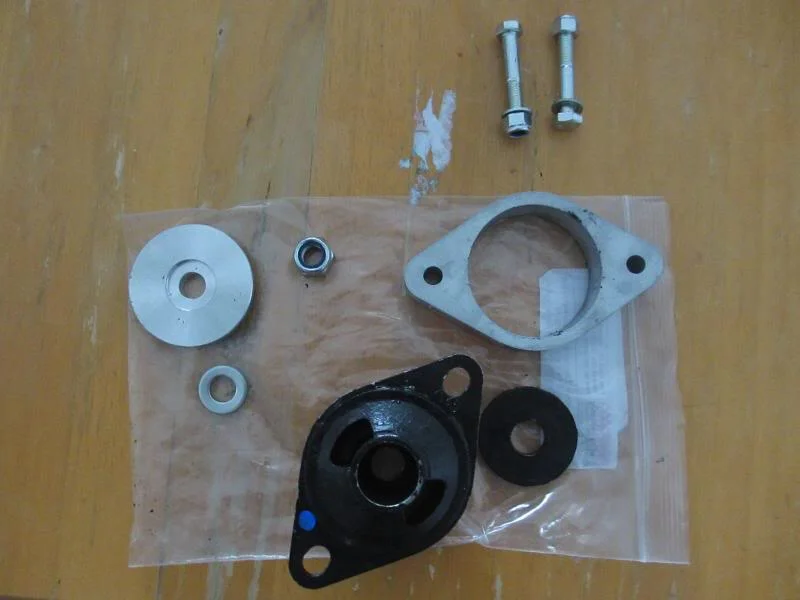

A pic I found on the internet

You are missing the spacer which sits under the mount.
I was in the same boat as you, and just substituted a couple of washers, as they don`t ( or didn`t) supply the spacer separately.

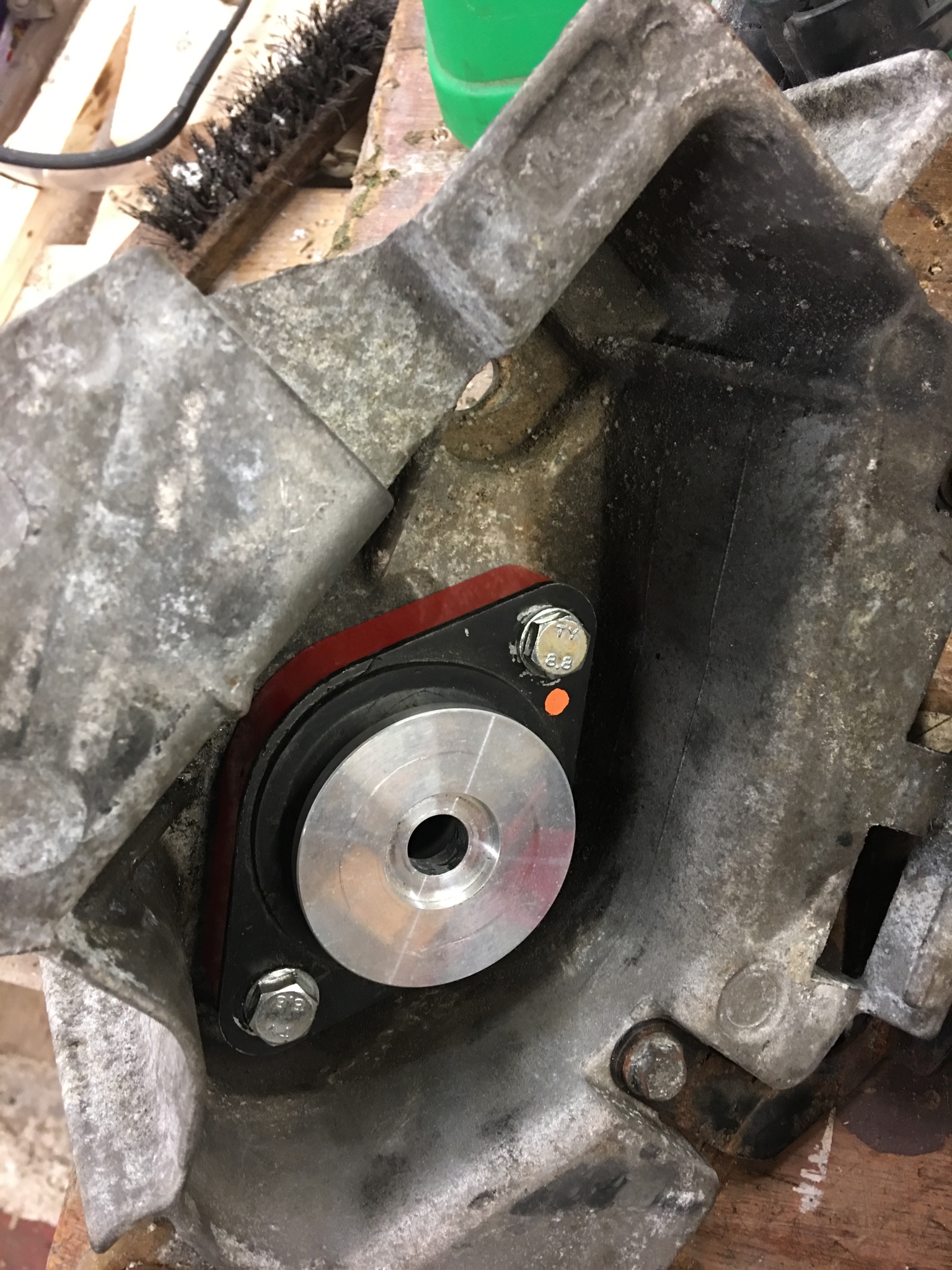

Sound. At least it’s nothing ridiculously specific. Been sat here for 5 mins figuring out the b*****d order[emoji23]

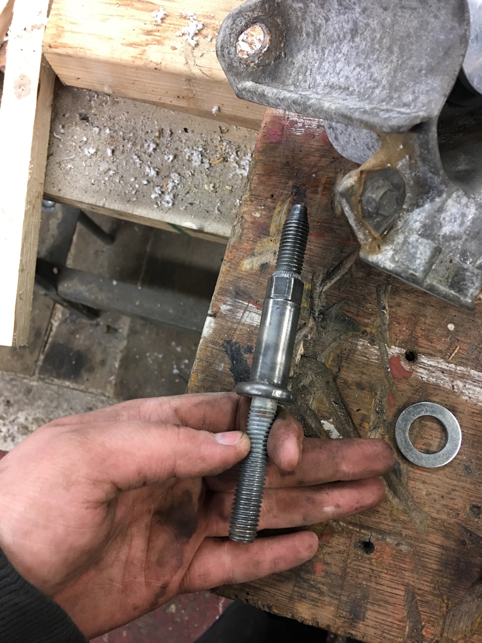

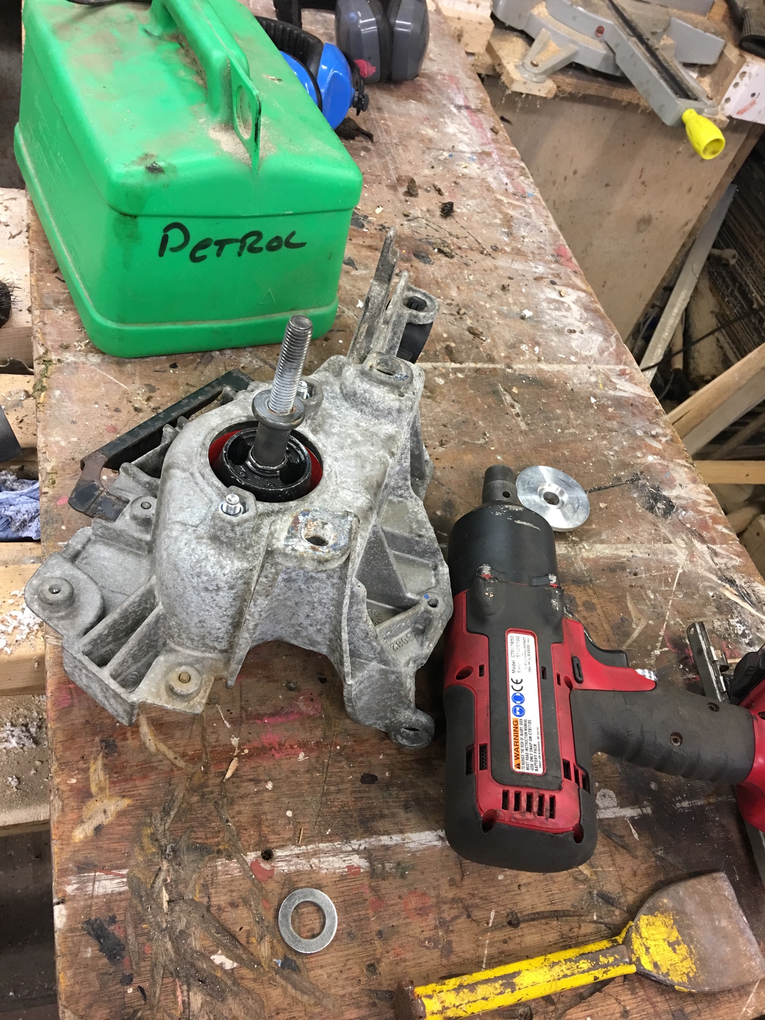

I’m sure I have it the correct way now, just the gearbox spider bolt that’s being a turd. Can either of you double check this way is right and I just have to get heavy handed with the dead blow hammer to knock that little s**t in?[emoji23]
