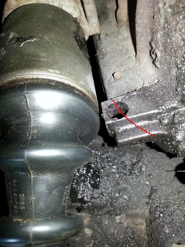

All 182 driveshafts are the same length, 655mm left hand gearbox side, and 730mm right hand.
J & R supply both 7.5 & 15mm width ABS rings with their shafts.
There have been reports of the right hand inner boot of the J & R driveshaft fouling on the engine block, resulting in failure.
This can be avoided if redundant material is removed from the engine block as per this photo.
The 182 Cup packed wheel bearing has an internal diameter of 40mm, and the std 182 has 37mm.
Answer from STEVE.M who was wrongly removed off this forum. Hope you find his answer helpful.
