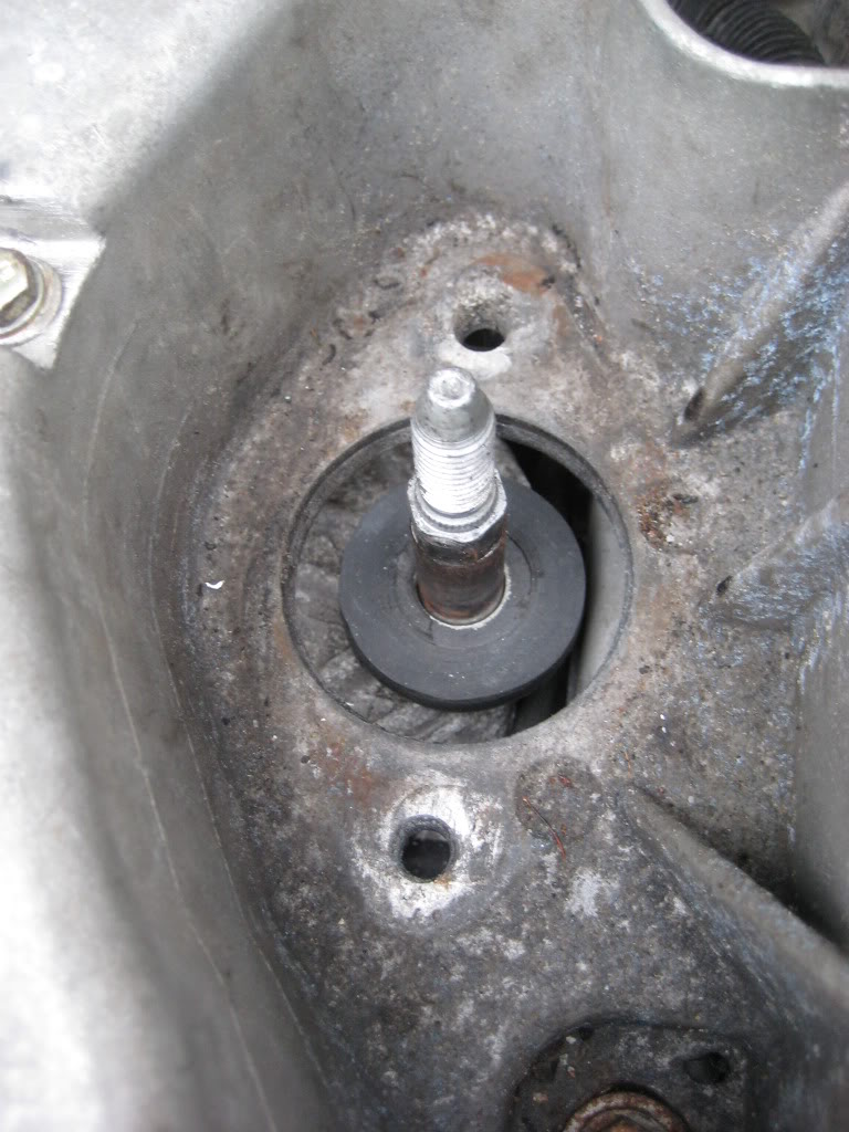

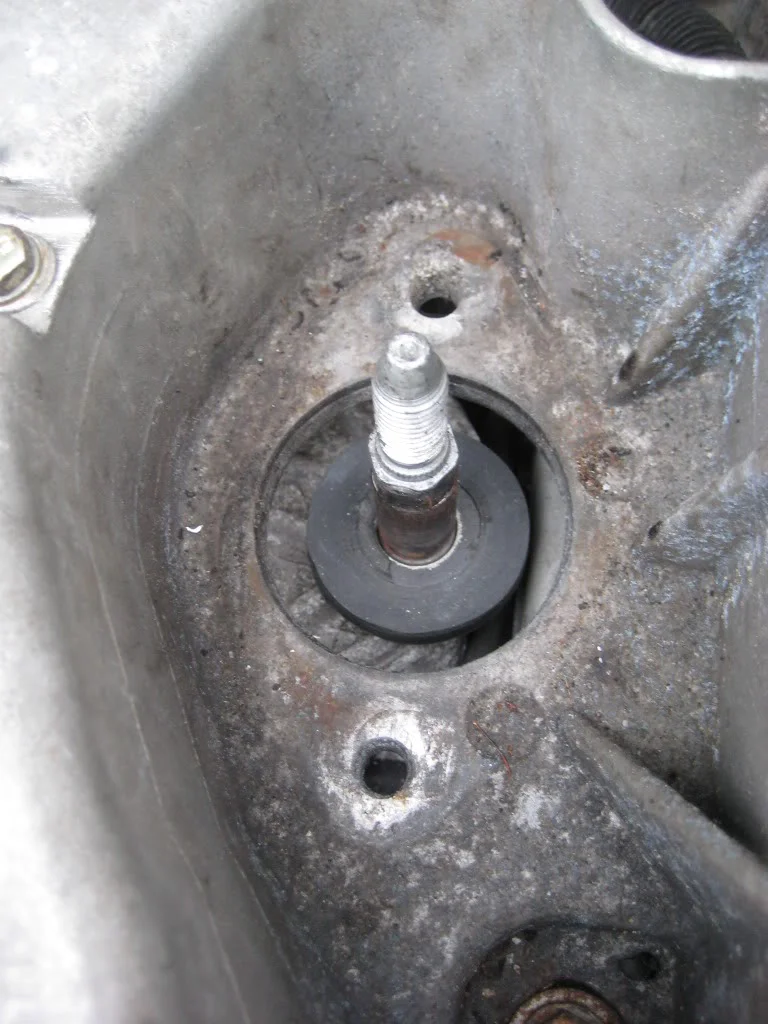

This gearbox mounting bolt can come loose, there is a nut on the bottom.
Also check the often forgotten front gearbox mount.
