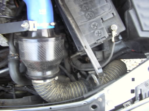

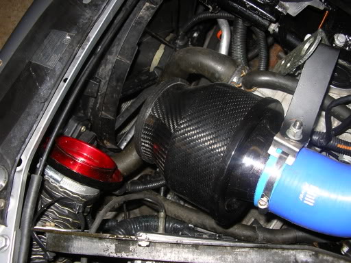

Are these 2 pictures the difference between a Viper being crap or a Viper being good ??
(cold air feed is connected to where the front fog should be)
pointed at the Viper
connected to the Viper

yes those pictures show ok and better, worst of all being with no cold air feed at all. heat soak is still an issue as the heat from the engine bay radiates around the pipe and the viper, is carbon a good conductor of heat? guess not.

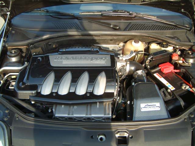

clidge said:
andyman that looks like a good kit any more details on it mate cheers any good noise and gains do you think
Did a bit of a search on here and found a link from another topic (3rd picture down)
Dosent appear to have a side entrance for the cold air feed like what it looks on the other pic. Not sure i like where its mounted due to a lack of a direct cold air feed but thats just by looking at it in the pictures. Cant argue with the price and looks tho !! :)
