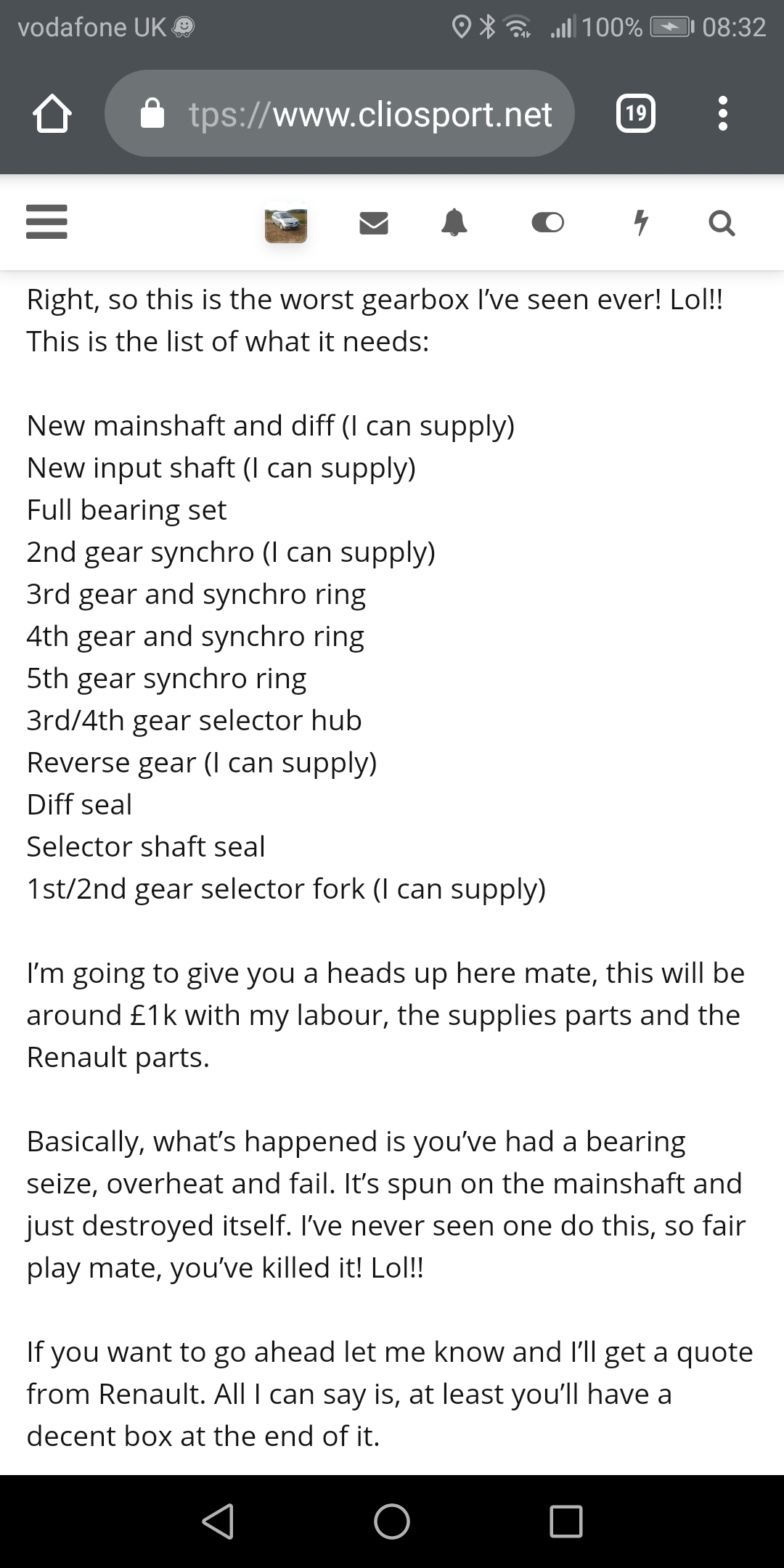

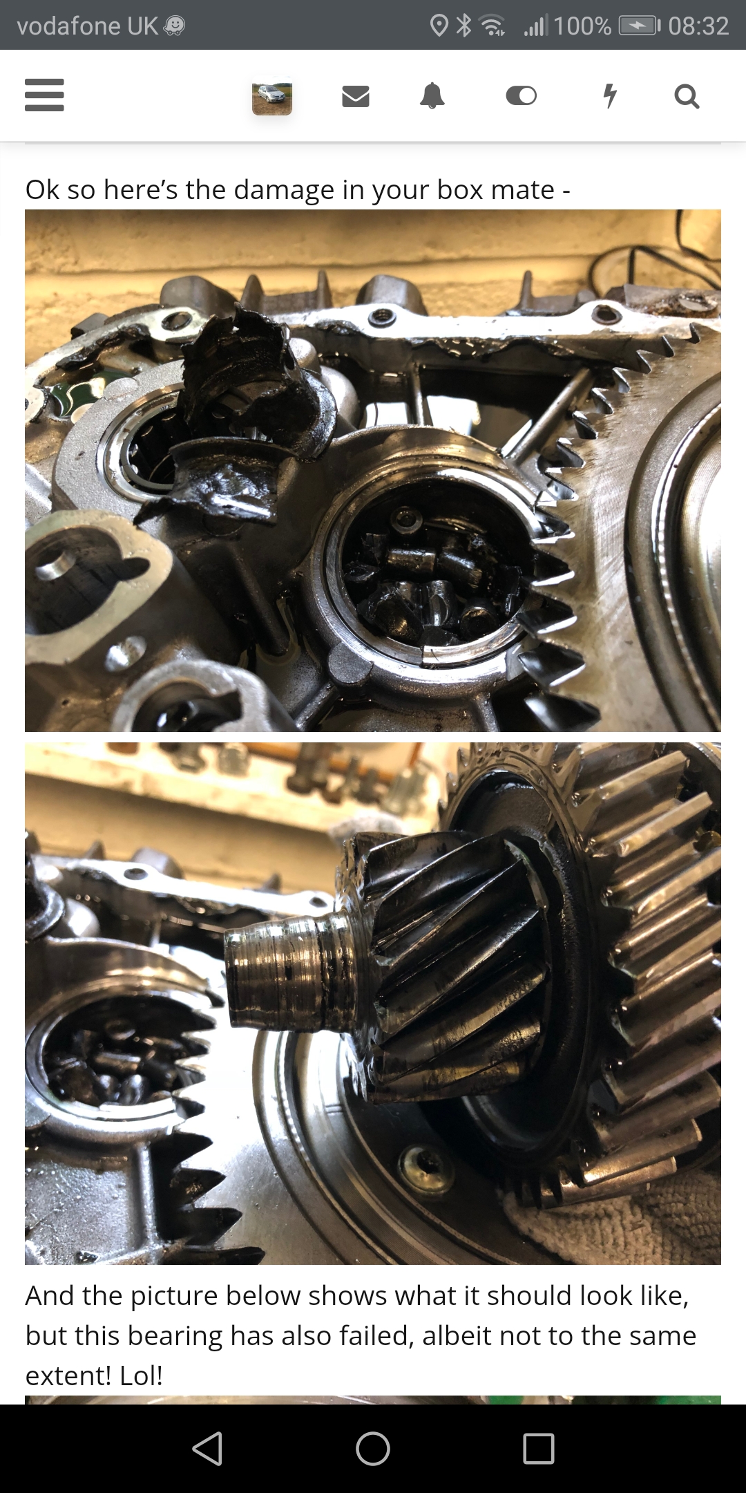

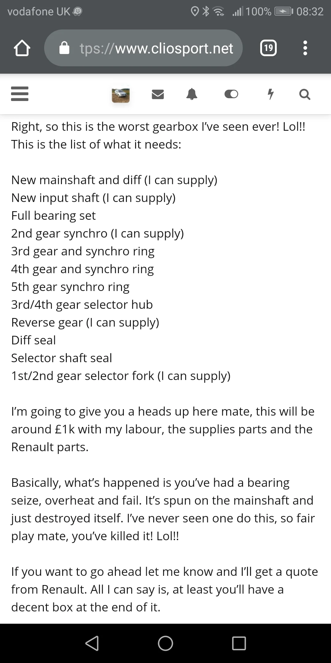

Urm the first was the factory one, that was surcharge swapped for a KTEC Rebuilt one. And when the KTEC one died I bought a second hand box for £50 and had that rebuilt by a local firm in Kings Lynn. And when that one died it got sent up to NorthLoopCup for a full rebuild with the quaife LSD. Safe to say it was absolutely knackered and it nearly had every single part replaced inside. That's the one I've just lost drive on! :(

Previous two, the KTEC one had completely shat a bearing and there's some wonderful pictures of this somewhere which Mark sent me. The one rebuilt by the company near mine Fifth gear had completely sheared all teeth and the case had cracked from the shift rods to the fill hole. And the original factory fitted Renault one, I'm not sure, it got sent back to KTEC and nothing else heard of after that!
@R3k1355 Attached Pictures of KTEC box damage, and the shopping list it took to fix!
