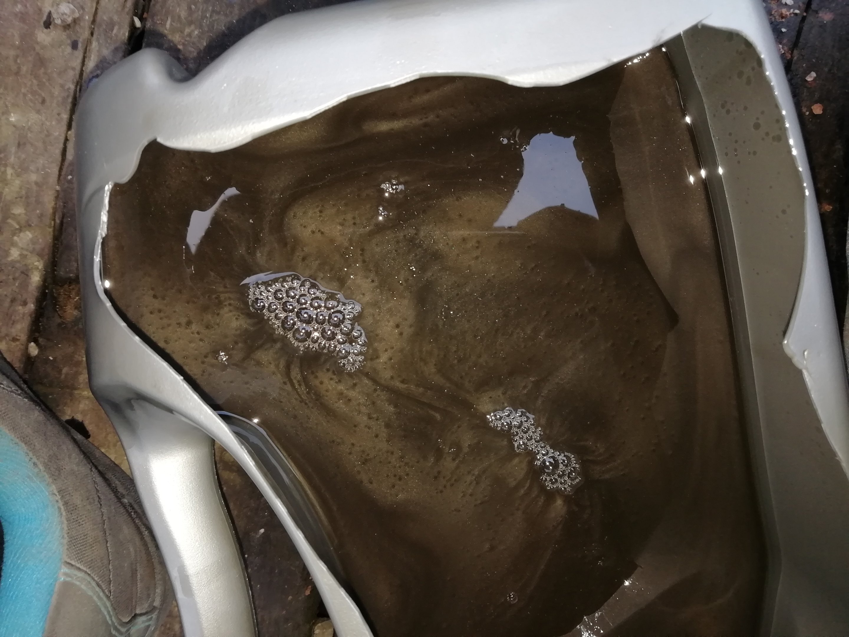

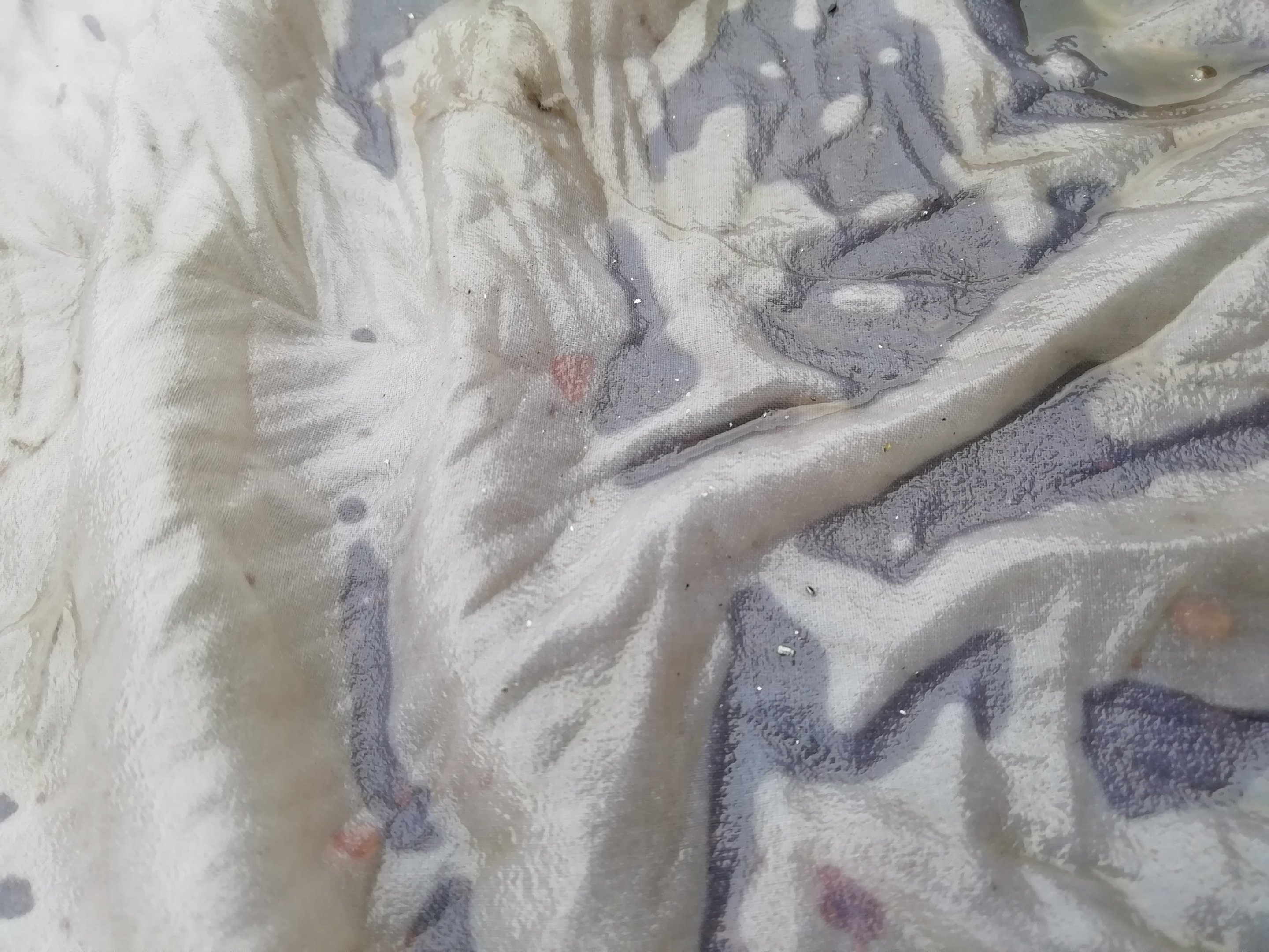

Drained the box oil and strained it through a cloth... No large chunks of gear teeth or anything in the oil, however there is very very fine (we're talking like sugar granule size) specs in the cloth, and the oil definitely has this like metallic looking swirl to it?
@NorthloopCup is this good or bad for redline MTL?
Nah you’ve killed something mate. The video could be the Quaife that’s let go. The gear on the drive cup has potentially broken free!!
