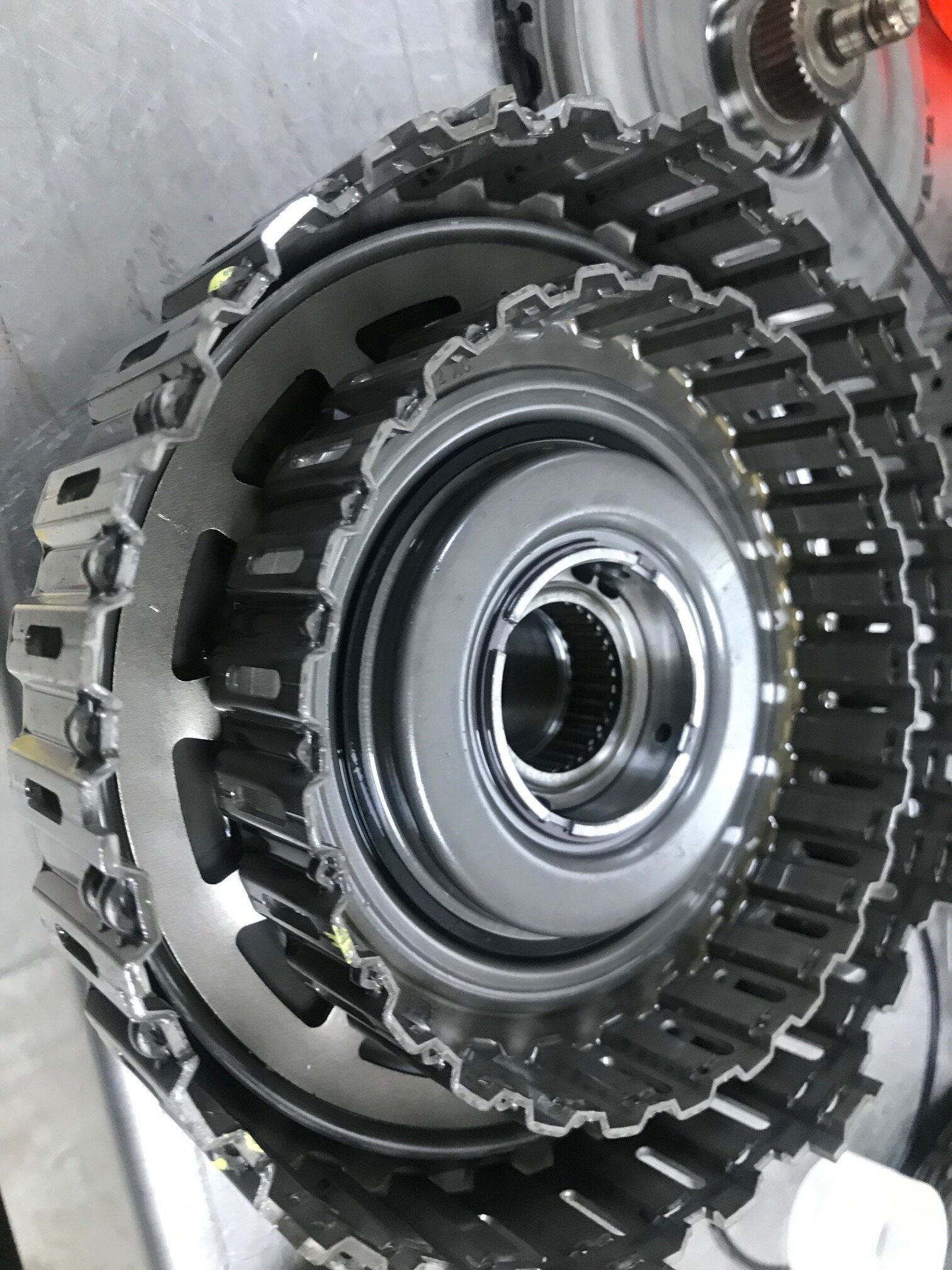

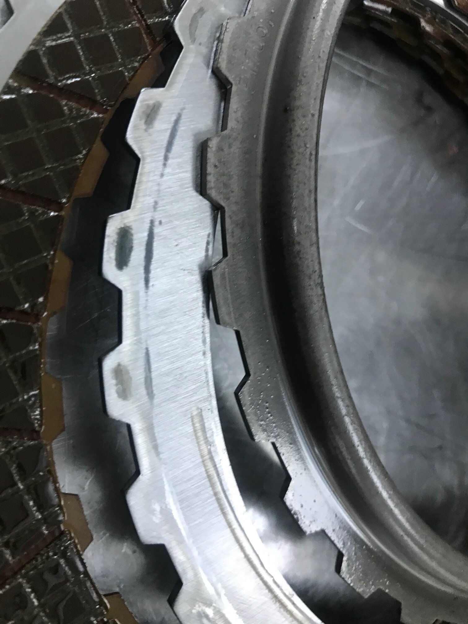

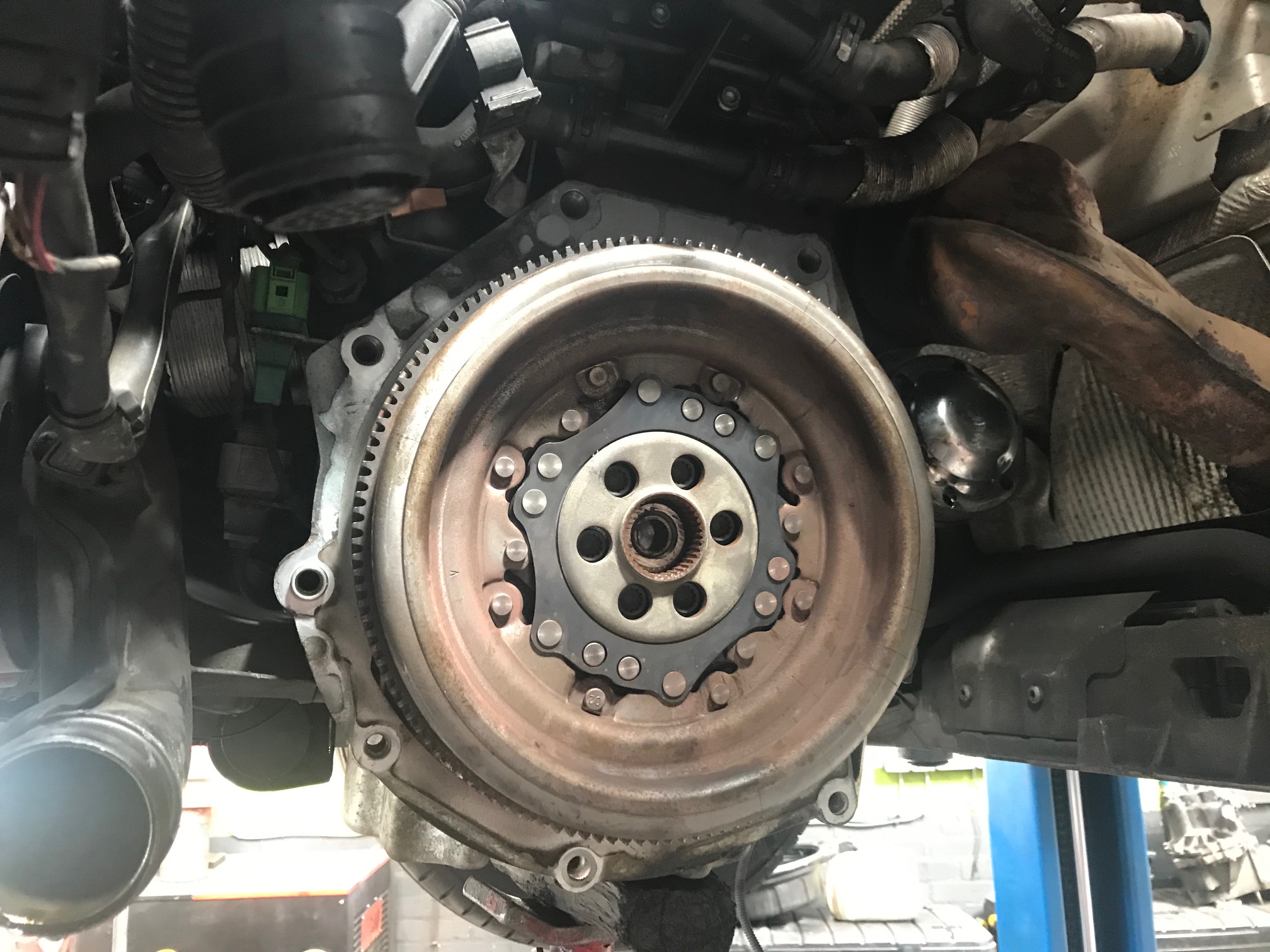

Bad news has been confirmed...
Car needs clutch pack, flywheel and solenoids on the mechantronics so basically the worst situation. Total is going to be just under 2k....then i need to spend money on getting the other jobs sorted. This car is going to owe me a lot, but not sure what else to do.

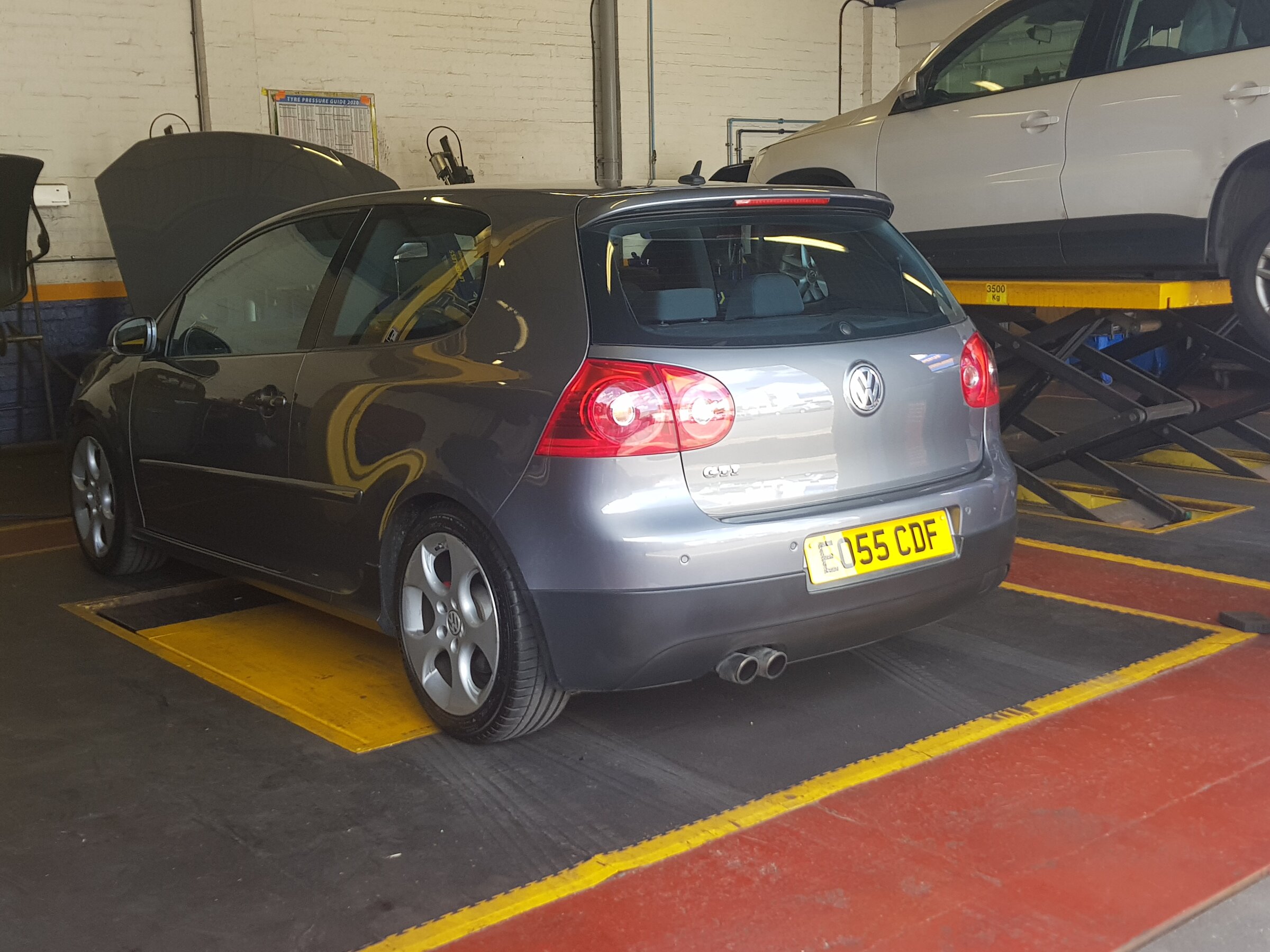

Car back today, 2k down but the car does feel good. It is so stupid in D tho, practically have to drive in S or manual. These boxes need a map. Whilst having a drive I picked up more on how soft and loose the suspension is so that will be next on the list. Treated it to a tank of v power and then decided to take it to Kwik Fit to check the AC. Of course they found an issue. The problem is with the little motor that controls the vents so will get another one of those. The system held pressure and its filled with new fluid now and they didnt charge me so happy days.
Got a few comments on how clean and nice the car was which is always nice :) got a couple pics from the garage.

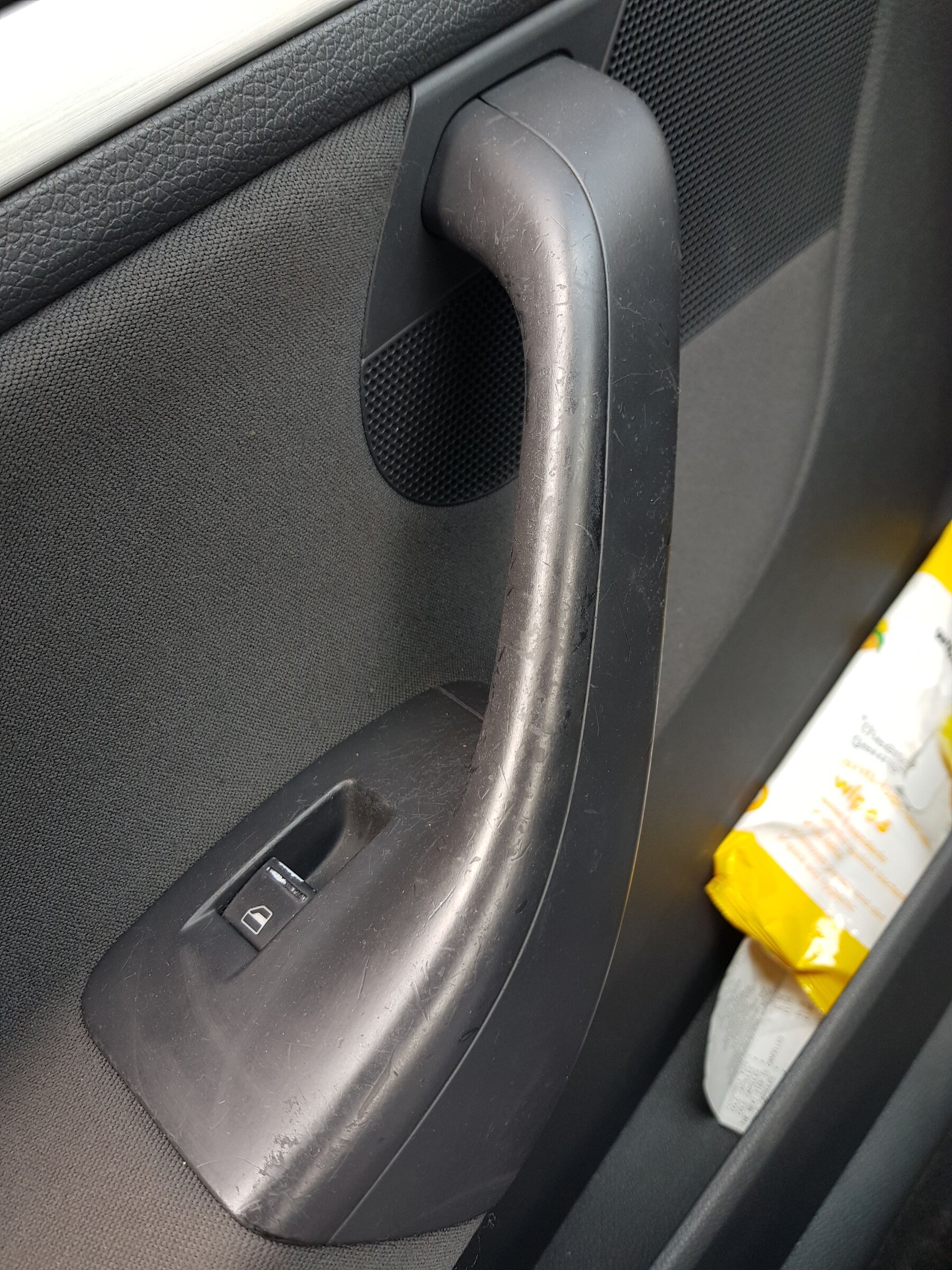

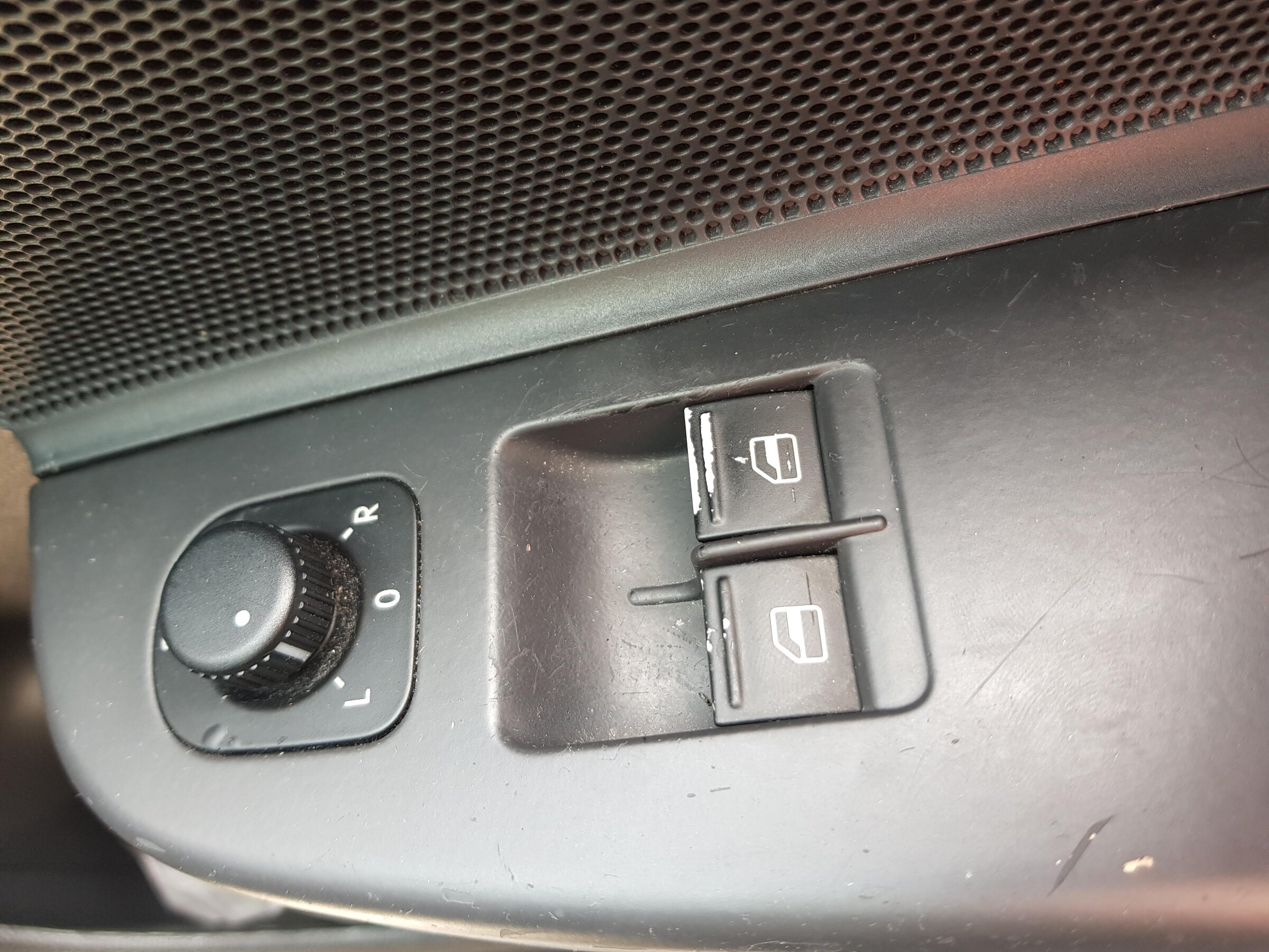

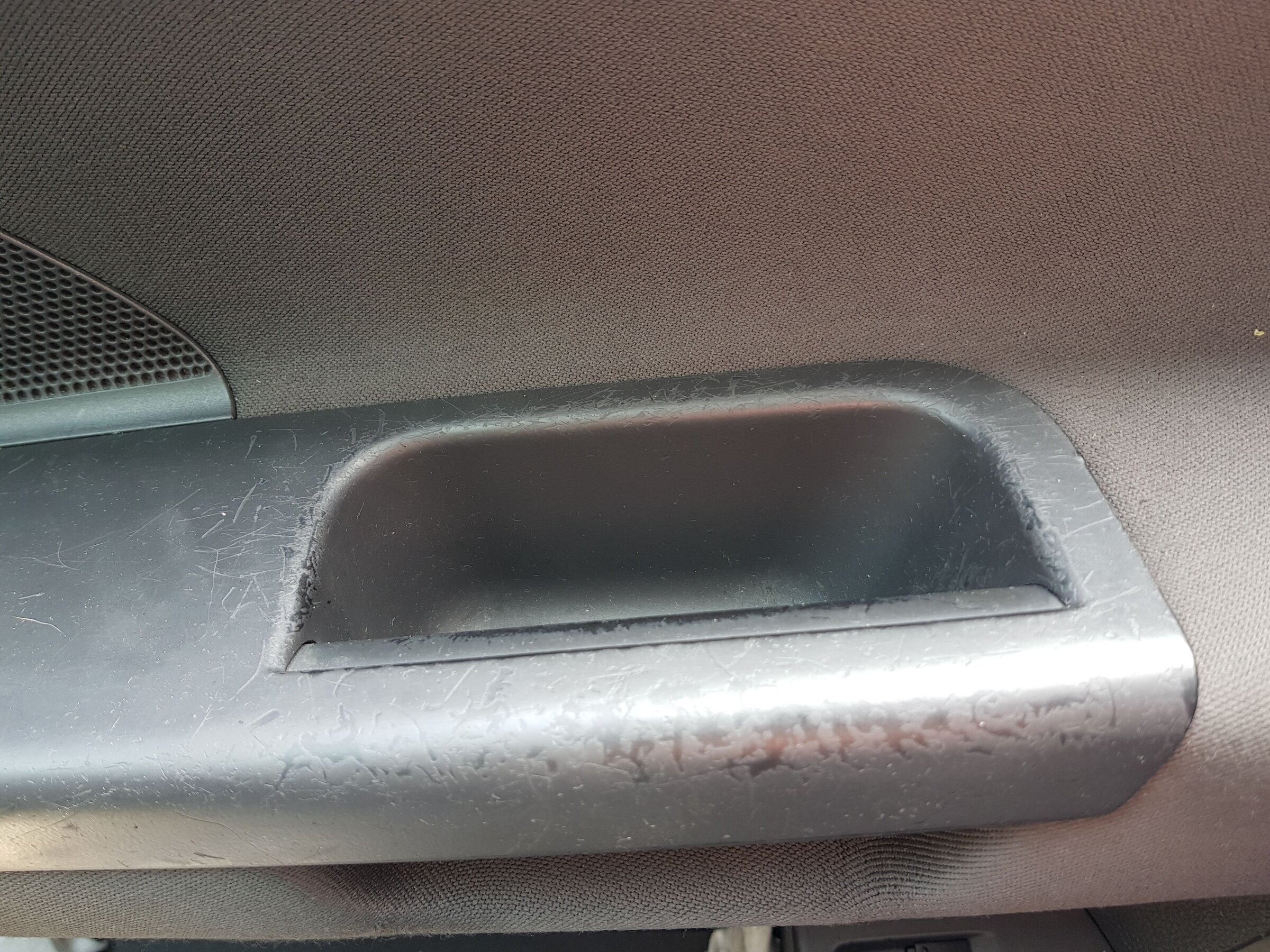

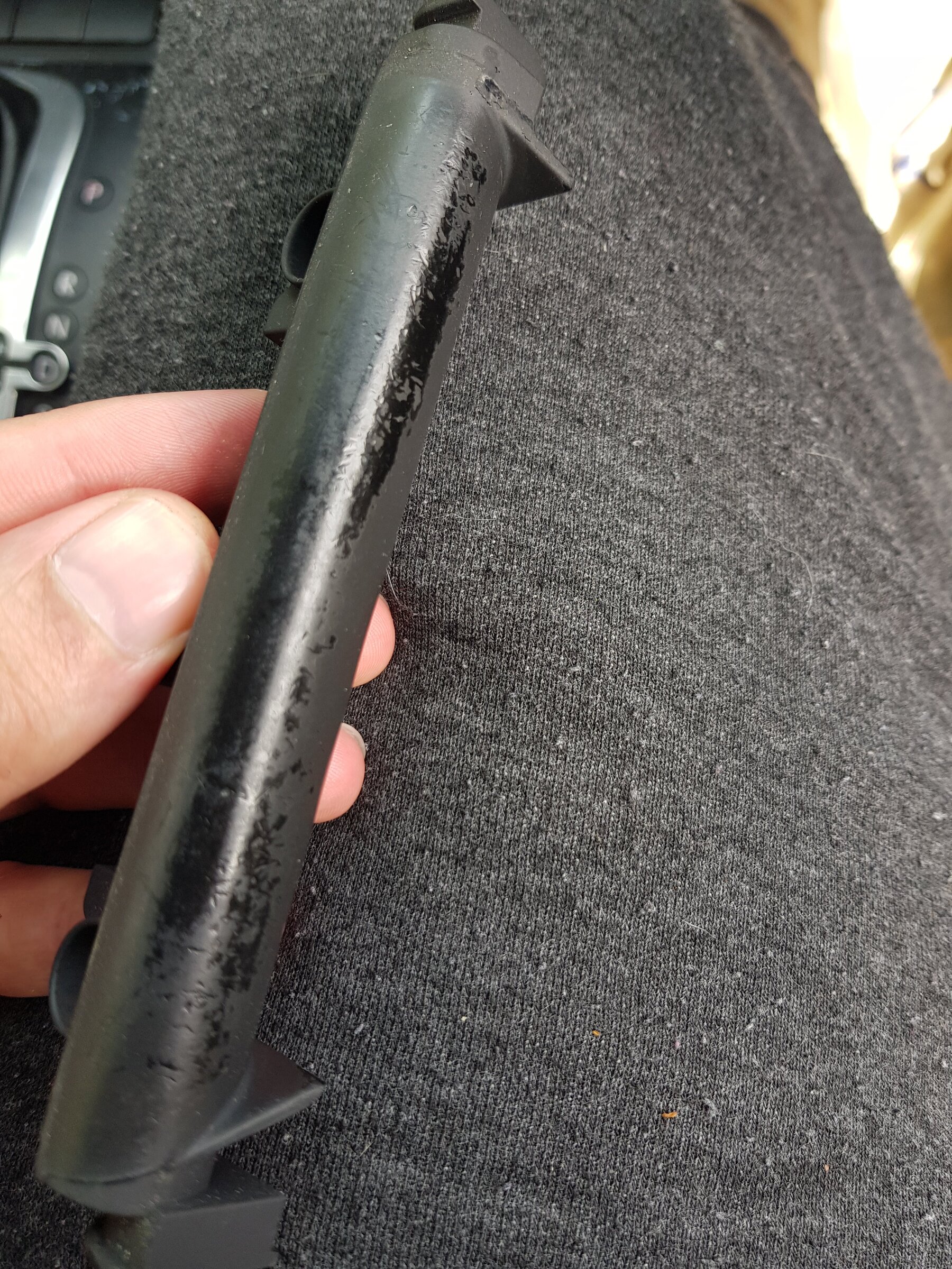

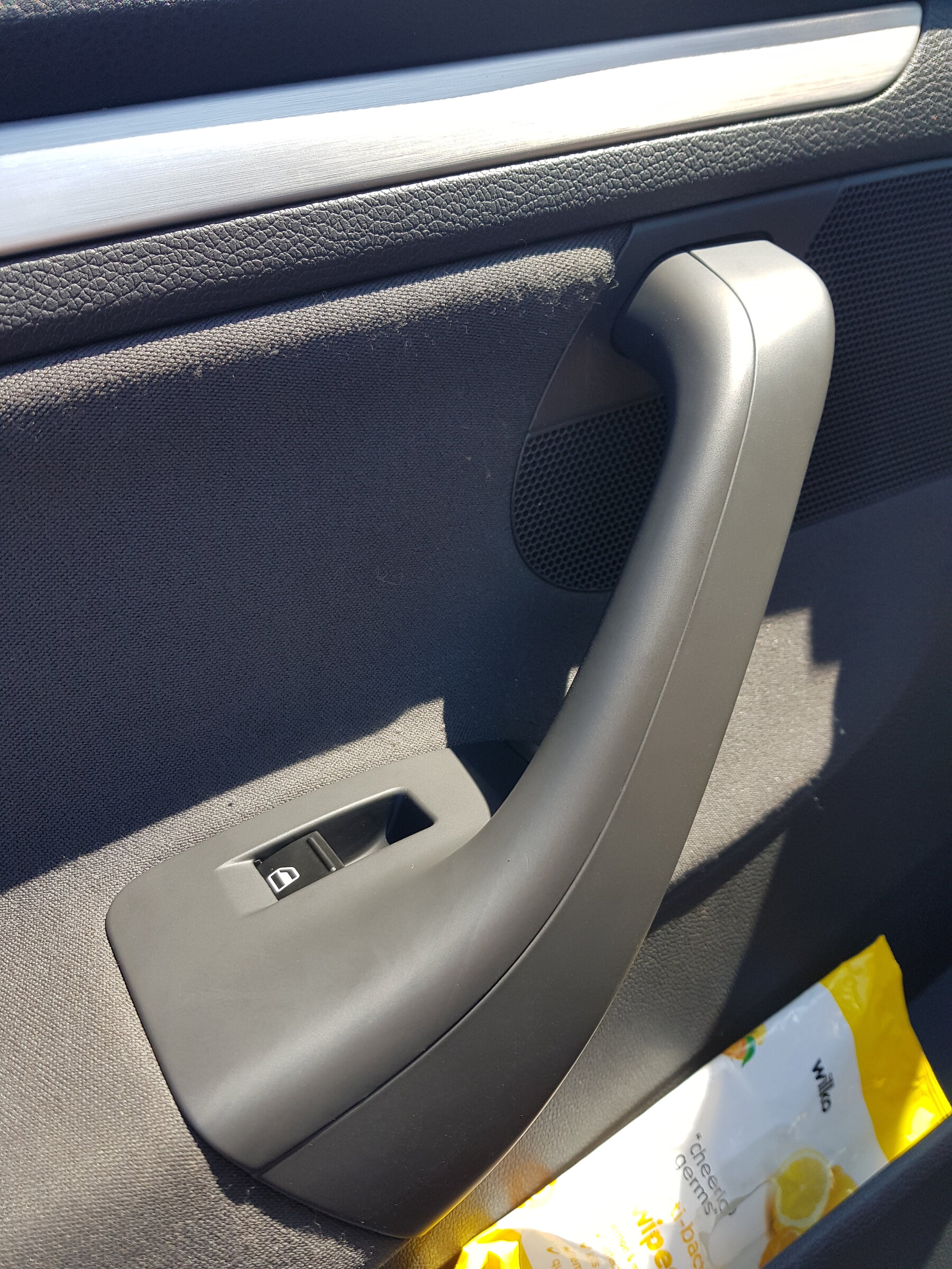

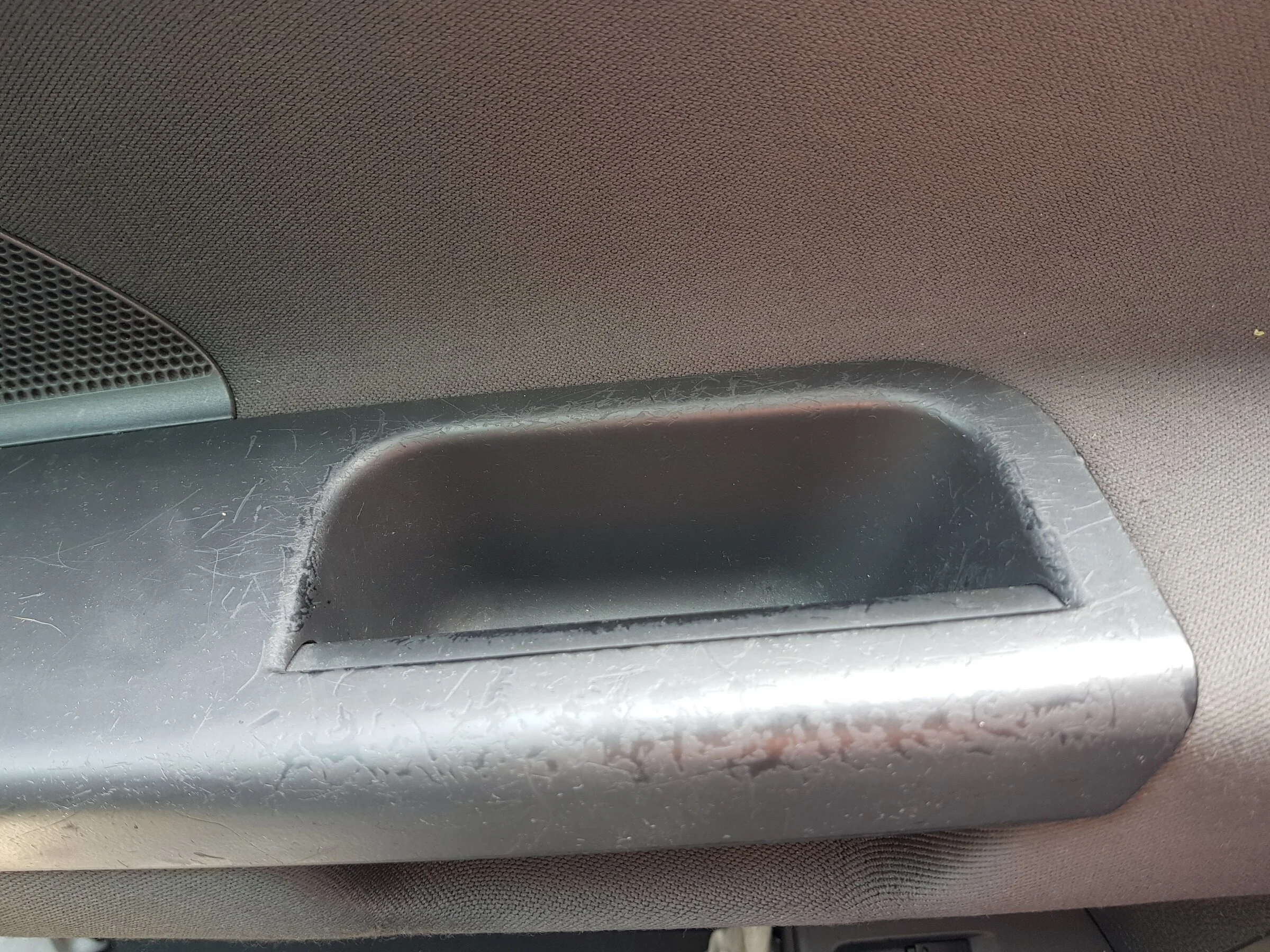

Time for even more parts! With the majority of the mechanical work soon to be completed, i turned to the interior. Sadly the trims are worn so this morning i took them off to get some part numbers.

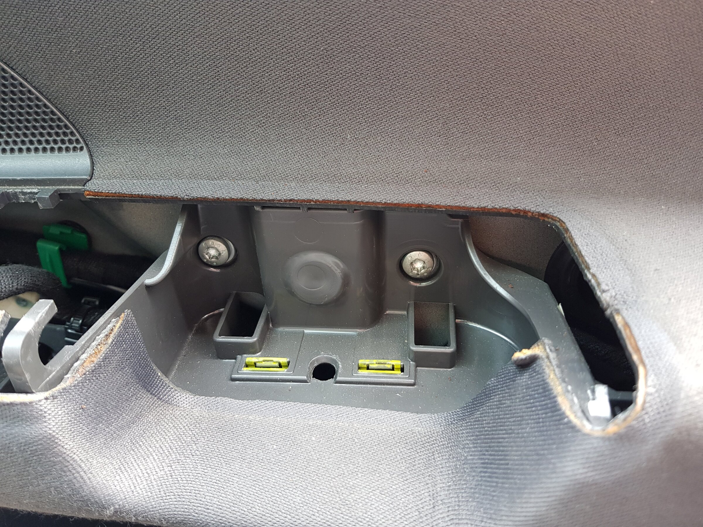

When i got the car back from the garage the other week, i got in and shut the door, i pulled it quite hard and the trim came off in my hand and the hook on the right broke.
In these pictures you can see the bits of trim that need sorting. I need to get the DSG trim, but you can only buy it with the gear stick so im looking into options for that.
Rojer
Passenger side all sorted now, sadly couldn't remove the bracket on drivers side as its plastic welded so need to get a soldering iron.

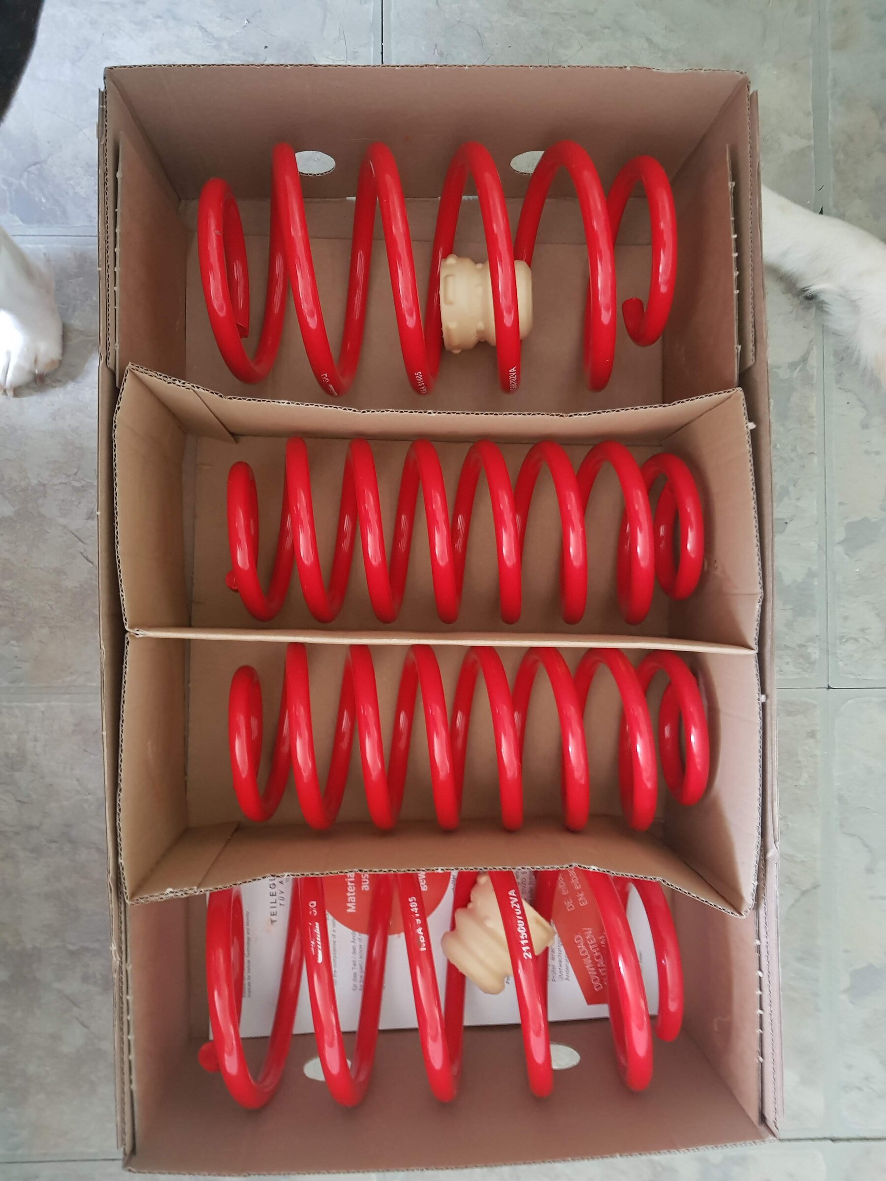

These are the ones I got from the factors
Looks like the right spring, price is high tho....
Its £31 on their site.
