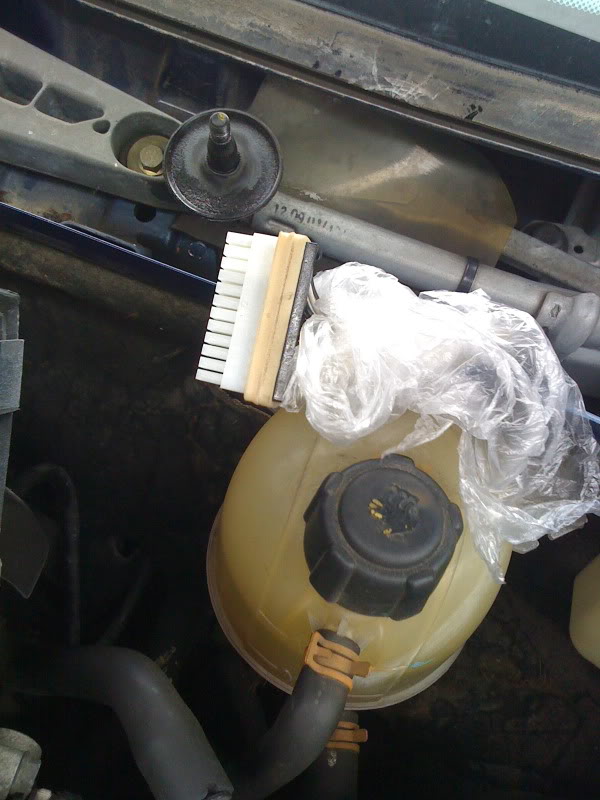

Most probably does the rear wash function not work either? Not too hard to change the pump at all but you'll need a bearing puller to get the wipers off the splines without a doubt.

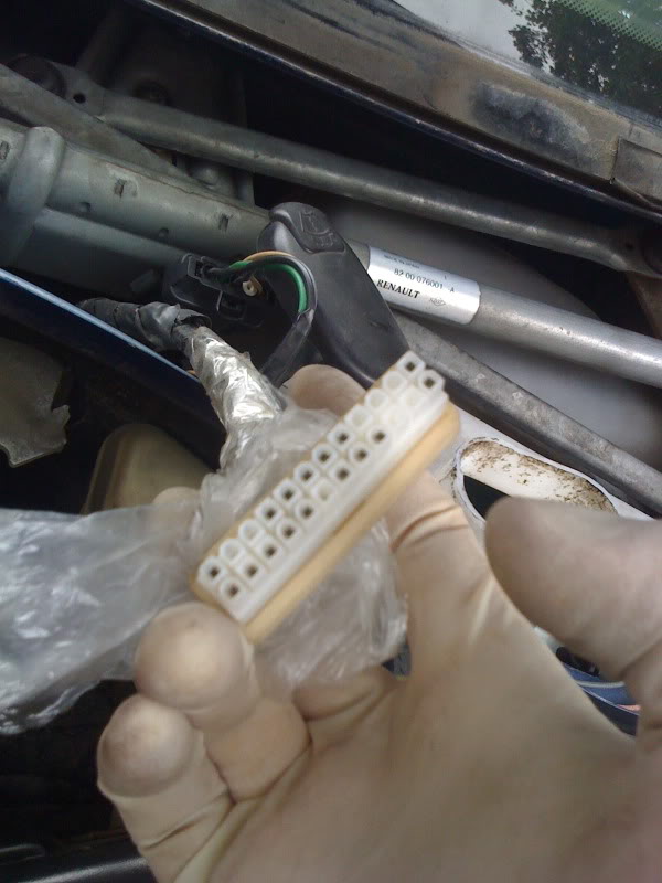

I lied managed to find a copy, no relay involved its powered directly from the stalk its powered from fuse F3 which is a 15A in the passenger compartment fuse box. Could be the stalk, if you disconnect the wiper stalk plug and ground pin B1 and give a 12v feed to pin A4 then the pump should run assuming the wiring isn't broken somewhere.
Basically if you take the top off the steering column shroud (the one that just pulls off) you should be able to see the plugs that connect to the stalks lighting on one side and wipers on the other. If you disconnect the wiper plug on the loom end it should be numbered and lettered row A 1,2,3,4,etc row B 1,2,3,etc.
The two that the washer motor is connected to are pins B1 and A4, now you can either chuck some volts up its ass and see if the pump runs or more safely and if you've got a meter test to see if you can pick up the pump motor down the loom and see if the contacts on the stalk close at the stalk end. Should find your problem as you'll test the only two bits of the circuit really.
