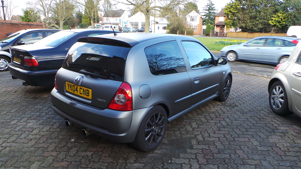

I dont think you have ever seen a wrapped car.
I want to see the proof that wraps are S**T please.
Oh wait....
  Mazda3 2.2D 185BHP
Pmsl seen plenty...
I think they look tacky
Orly?
if you think it looks "tacky" then something is wrong with you imo
A decent wrap looks like a car is painted... Unless you have in mind the Decals and the like?
