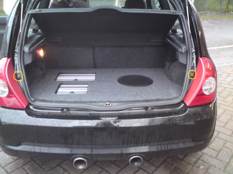

I doubt it's coming from there tbh, that's the rear beam bracket mounting bolts.
It'll be the two black rubber tailgate stops that sit either side next to the rear lights, seal them up.
I'm 99% certain it's coming from there , when I press it a litttle bit of water comes out . It's just a small puddle of water. I sealed the black grommets years ago. I'll put some sealant around it when it stops pissing down and see if that cures it . I never knew what they were , thanks :up:

Very odd if it is because the water would have to be going right up underneath the chassis.
Water doesn't tend to run upwards :tongueout:

Is your boot carpet wet too?
No , just this small puddle of water . It does seem like it's been trickling from where I said . I've just been and dried it off and put some sealant around it . I'll monitor it and see if it's better. Like I said before . I sealed the grommets years ago when I had water coming intto the boot . That sorted that leak :smile:

Ahh right. That's a first i've seen/heard of leaking from there.
Like i say, water would have to be physically driven up into that area by pressure for it to run up inside them.
It's the first time I've seen it mentioned on here too.
