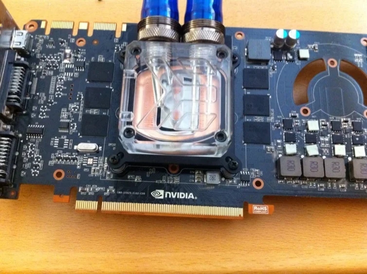

EDIT: Also get universal gpu water blocks so you can use them on any gpu to come

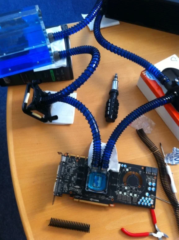

My universal gpu water block
My full system outside the case
That's the 360mm rad, and lol at my anti kink coils :p I'm better at putting them on now!

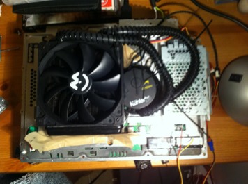

For you nerds out there this is my ps3 I'm currently working on:
Depends on the card, personally I wouldn't fancy running a 580GTX like that...
I personally wouldn't want to run any card like that - lol! :)
Had issues way back before in the 7900GTX and 9800 Pro days. Crappy passive cooling on them - replace and restick and everything's happy. Having air running as well would help, but doesn't that kinda defeat the exercise?
