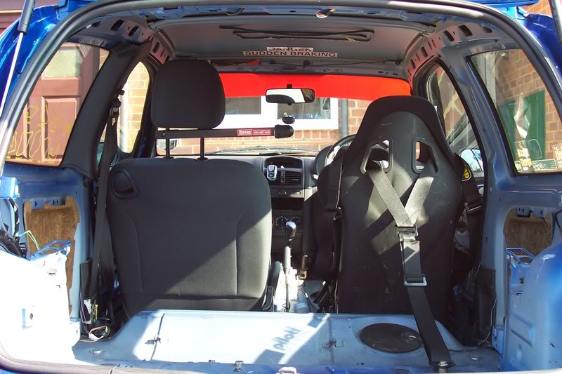

I took 117 kgs out of mine almost all from the interior.
Carpet, headlining and sunvisors come in at 17 kgs, so imagine this with all that fitted for your 100 kg saving...
Not possible if you want to keep the interior.
HAhahaha, My sign lives on!!!!! Check the roof!
MArk I am disappointed though, as I can see cards in the rear quarter panels still. Tut tut!
:D
MarkCup
:D
Amateur, those cards weigh fook all, and protect he paper thin metal outer skin from getting the odd dent from sh*t flying about in the back.
