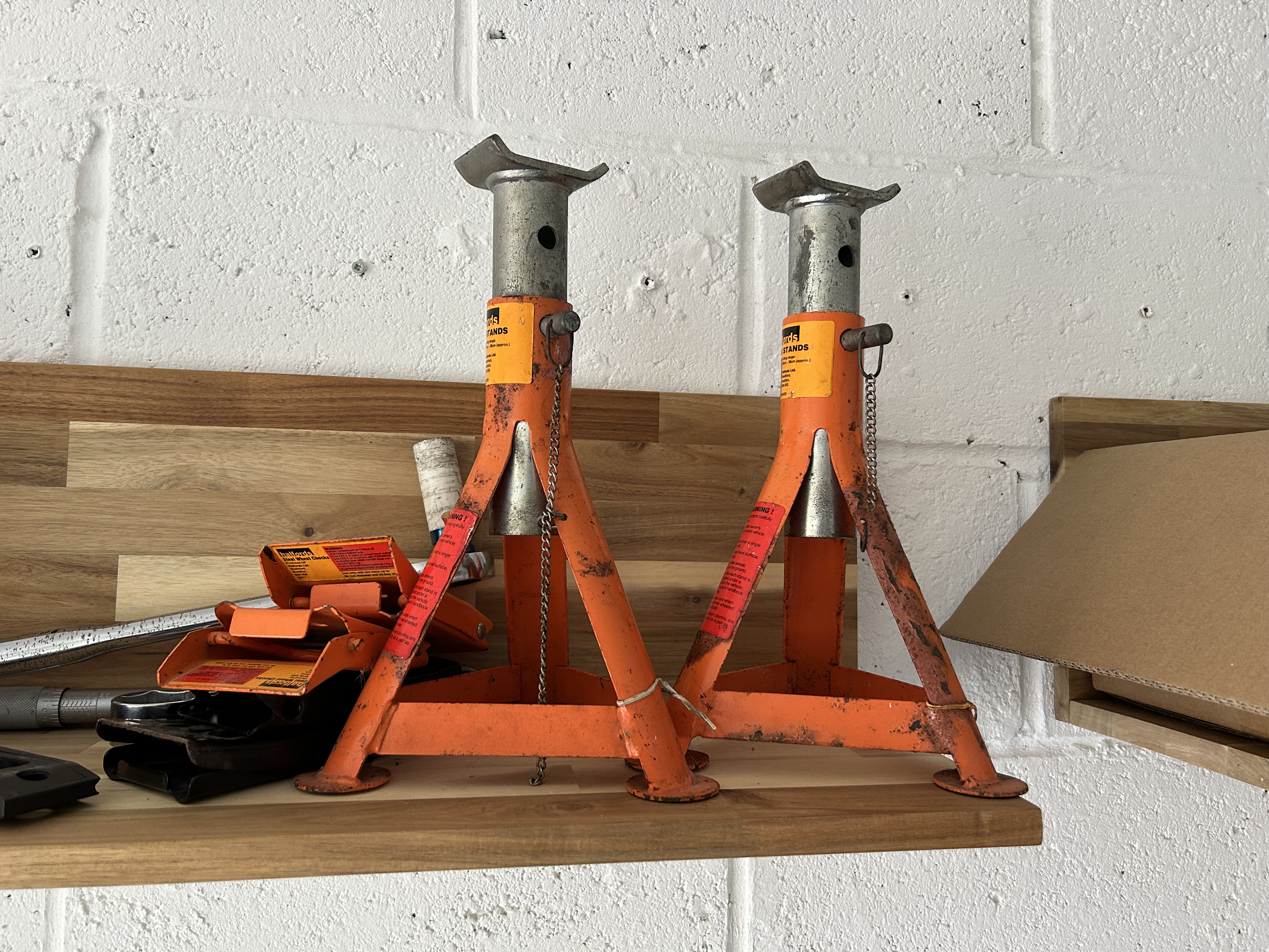

I’ve just given some rusty old ones to the scrap man that were about 30 years old. They’ve been replaced with some nice new orange Halfords 2T ones.

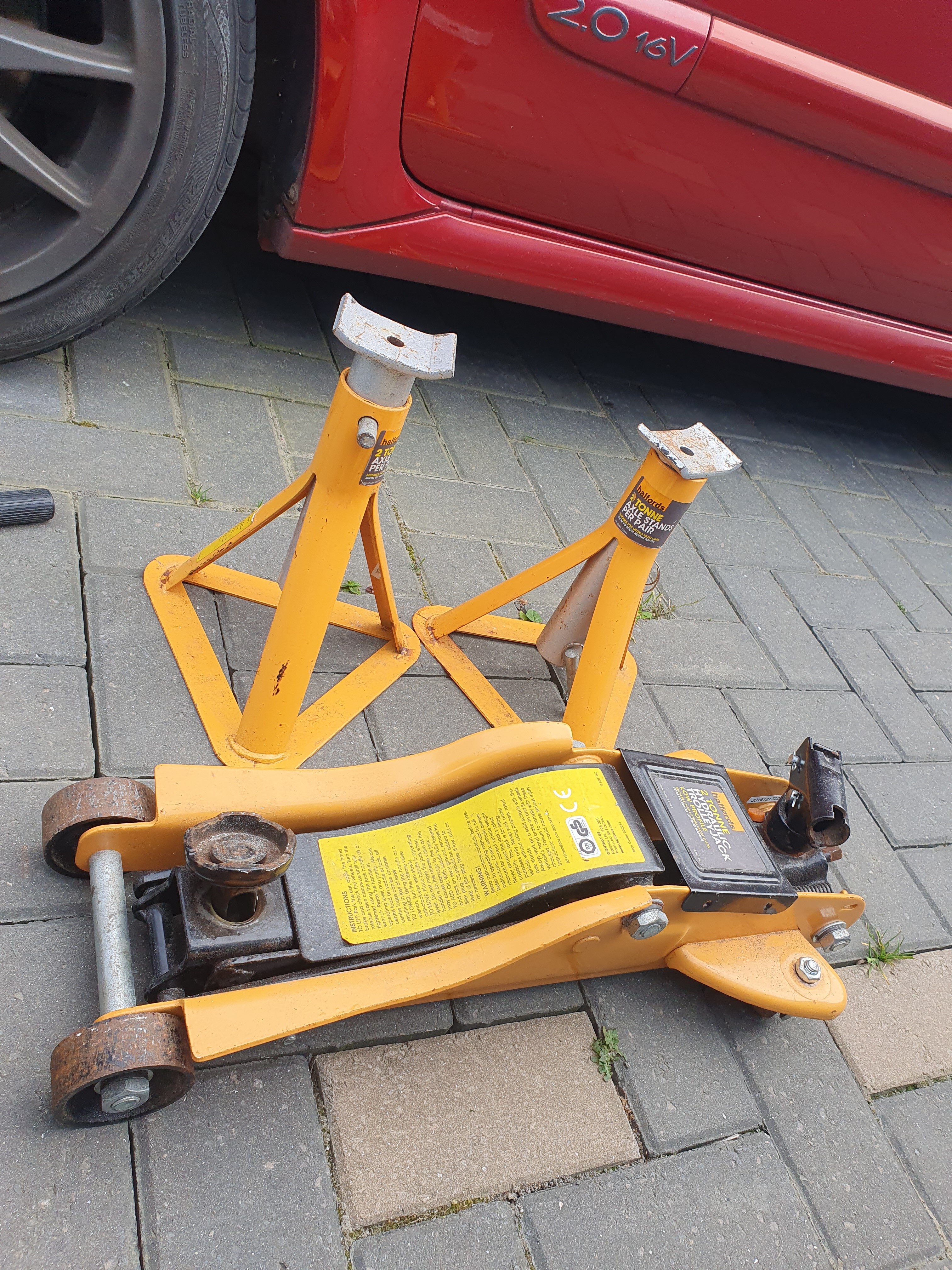

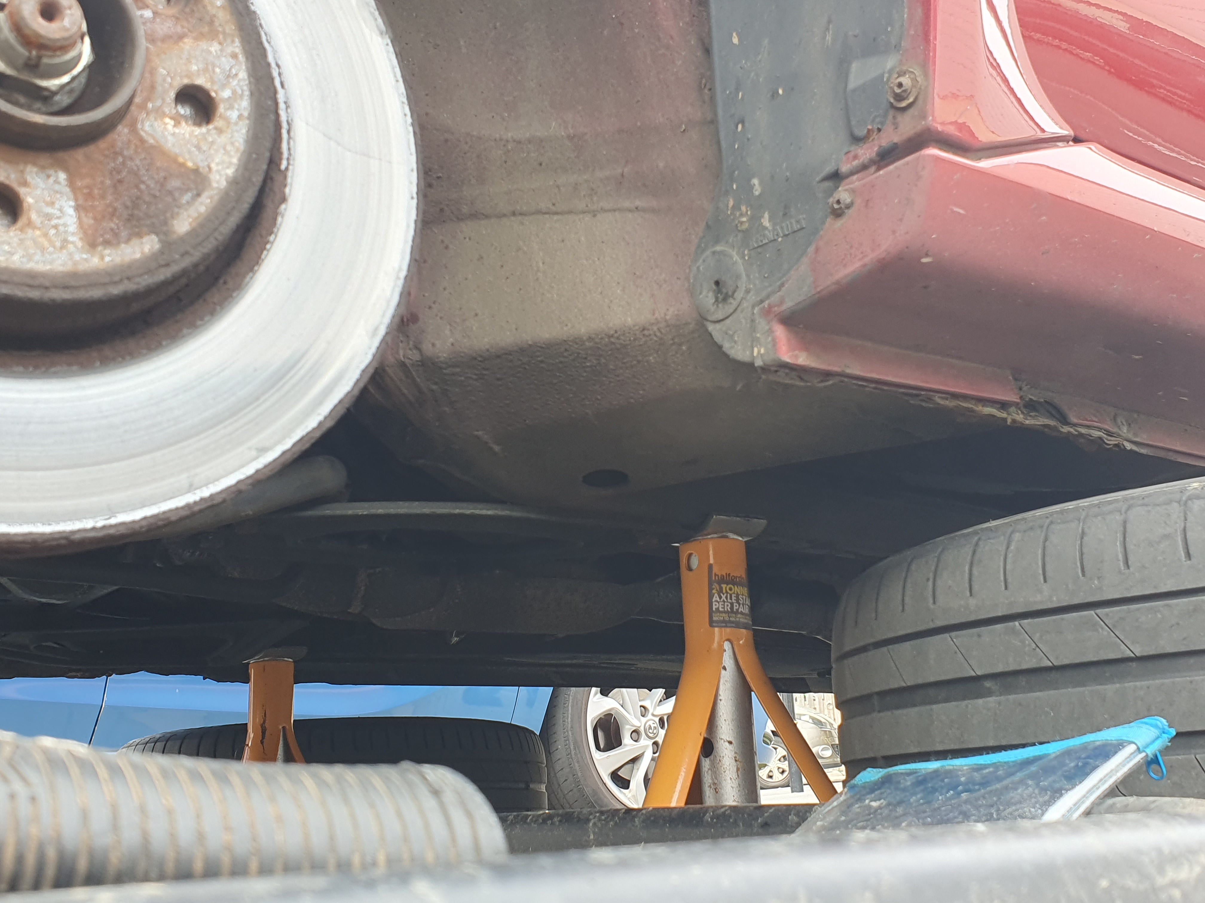

This is my 2t Halfords setup. Still always extremely paranoid lifting the car up and putting on stands. Once there, i'm all good no probs, just the journey scares the crap out of me!
Halfords cheapy ones and don’t be such a baby/drive a car heavy enough to immediately crush you to death when if it falls off the stands to minimise the suffering.
If you ever need to go really high up with them, do it in stages if it looks sketchy.
I actually thought sod that and borrowed the scissor jack from my neighbors Citroën Dispatch, had so much more confidence woth the scissor jack than mine.

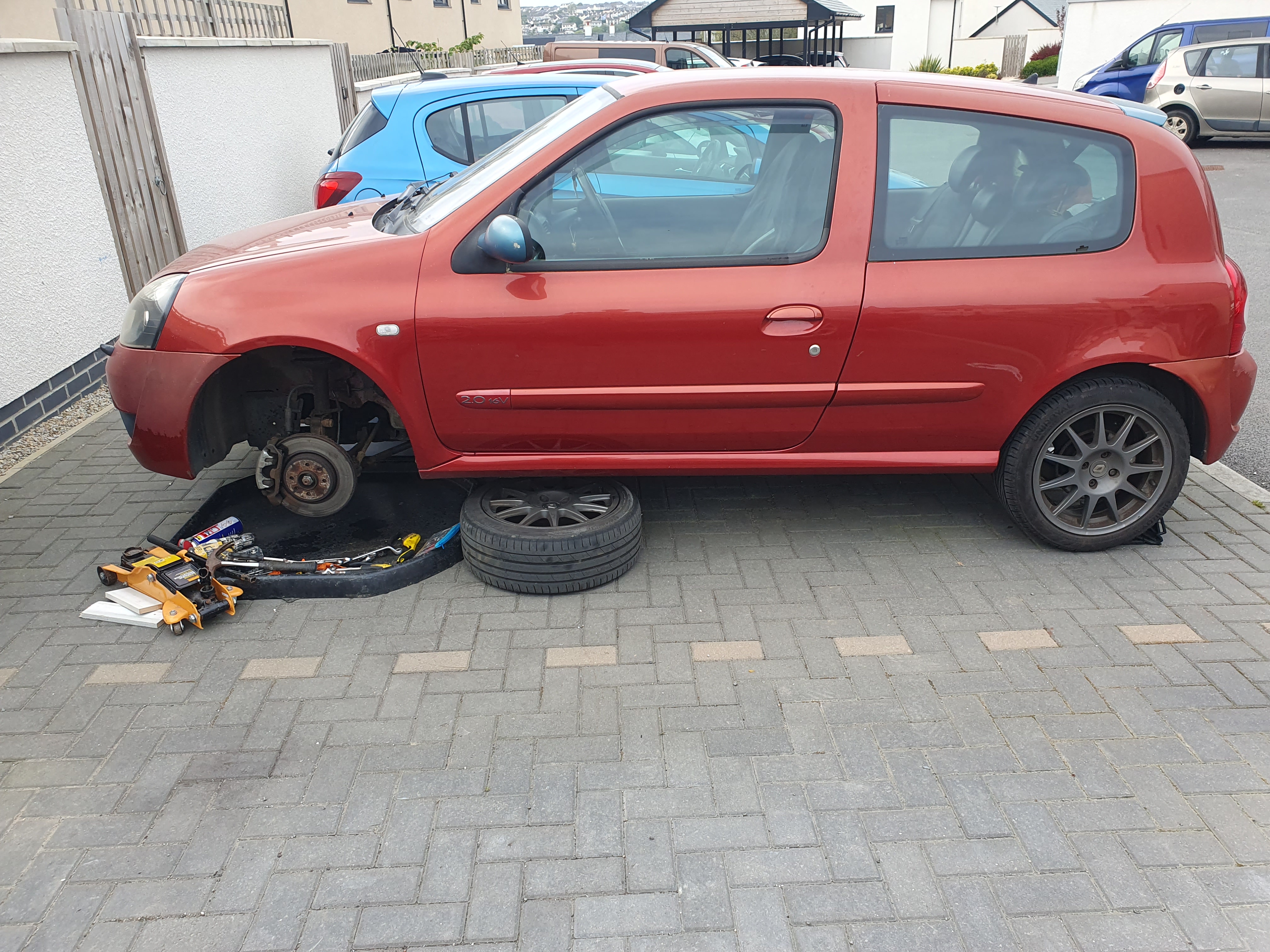

Yes I have the handbrake on, been using chocks too on the rear wheels. I fond my jack doesn't roll to the car but grips the floor and drags car to it
Handbrake off when you lift. Car moves in weird directions when the wheels are locked.
The weight of the car needs to shift to allow the jack to roll under
That's why I don't like way it moves when jacking?
I would trust it even less to take the handbrake off though as would expect it to roll back or forward as the ground isn't perfectly flat and it's brickwork paving.
Are you genuinely telling me I should Jack the car with handbrake off? That just sounds mad to me, maybe I'm wrong though?
In my experience handbrake on only causes issues. As the suspension is locked the rear beam twists down and moves the car while you are jacking. That way the wheels twist and not the chassis.
Its not terrible when you lift the first side but I have had the car almost fall off the axle stand when doing the second side. (This was on a slightly angled driveway similar to your situation)
As long as the wheels are chocked you should be fine, once it's on a stand(s) it's locked quite well.
Fair enough, you were using a widow maker Jack and axle stands without pins in so I'm not sure I would trust your judgment either
Yes I totally get where you're coming from with the almost falling off the stand jacking second side, that's why I prefer the widowmaker. Will have to try with the handbrake off. The first side the front wheel still touching means the car in gear helps a little.
I've only gone with the stands without pins as worried to get the car that high and don't know why not using the pins were an issue, I thought they were just for the height allowances
Give it a go! Stick a brick/paving behind the chocks if you are unsure and just go slowly.
Hopefully it will rise better and you can get the height on the stands, it can be a real chew on without the room to work
Thats why the jack has wheels... As it goes up it should move forwards rather than the car.
