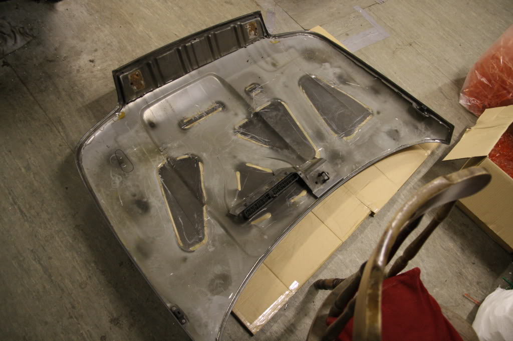

The side impact bars in the doors are very heavy, and on both sides. Although, id only recommend cutting them out if you put your cage upto the front. More weight could be removed by - removing rear wiper mech/motor, cutting out the bootlid skin, removing sunroof glass and replacing with polycarbonate, fitting polycarbonate windows, cutting out the inner bonnet skin, etc!

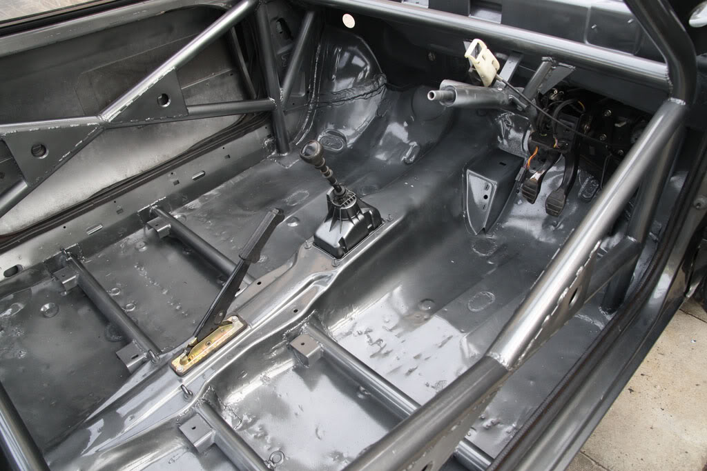

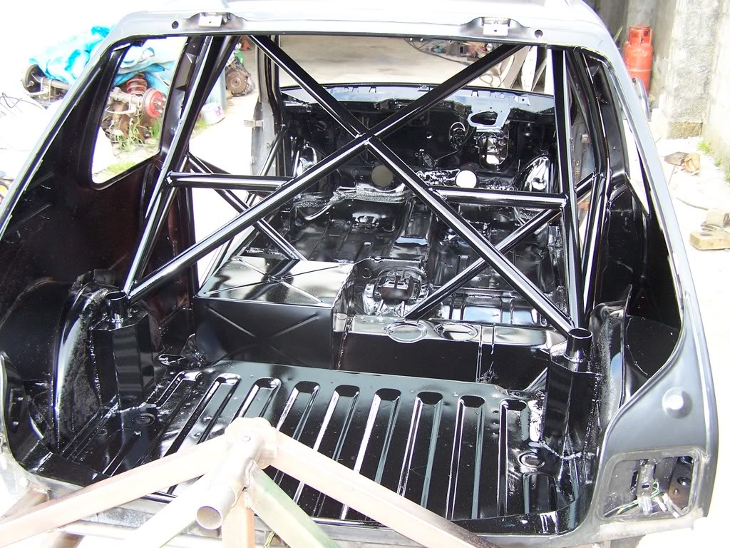

You can start to get serious with a rollcage in. This is my 205 with no inner skin at the rear :D Hoping for under 700kg fully built up

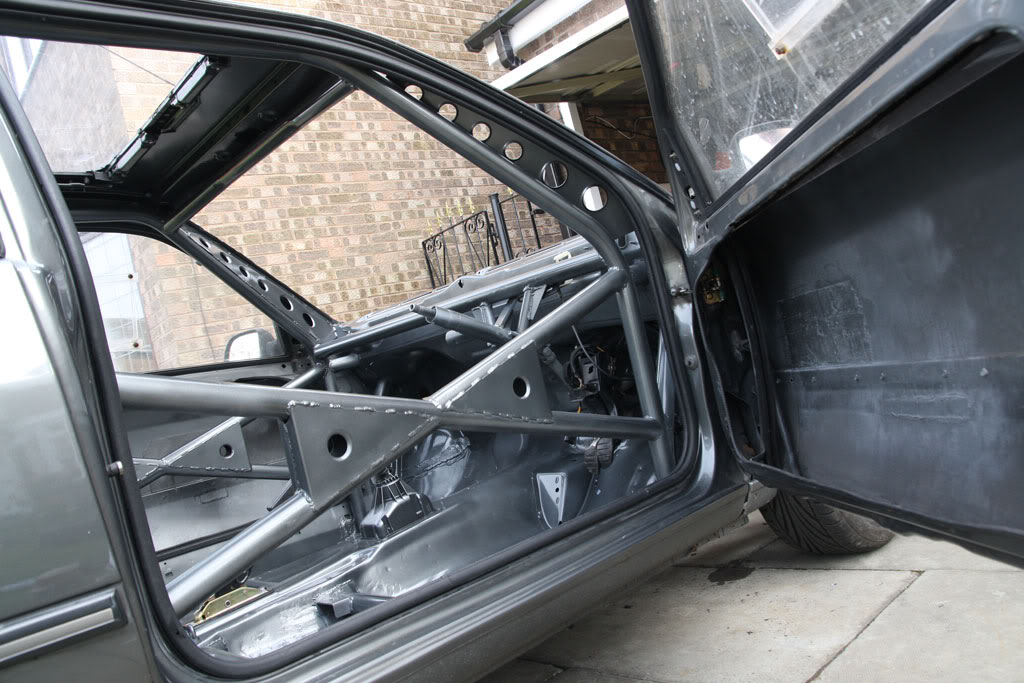

I swear its any excuse for a pic you with you jord!
ive not got so much roll cage,
but ill be keeping the inside of the doors,
hopefully ill be looking around 900kg :D

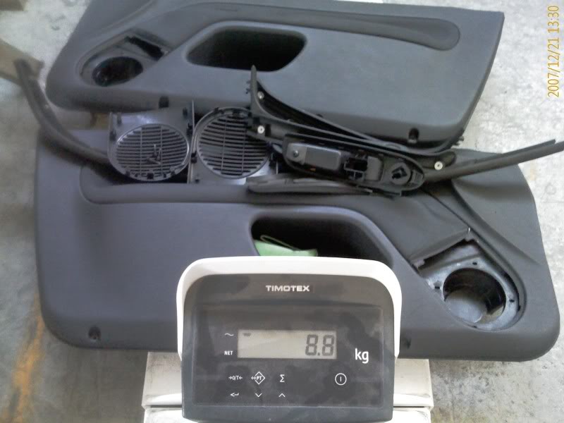

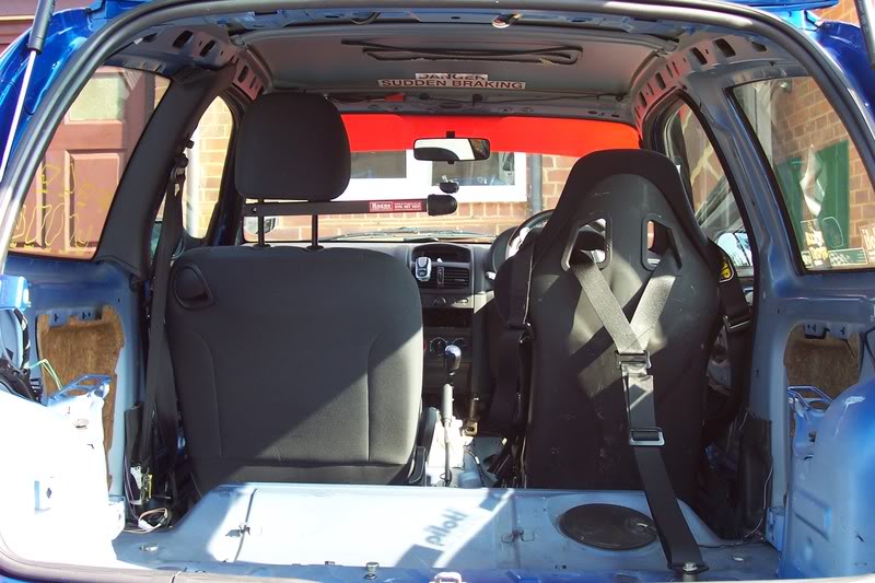

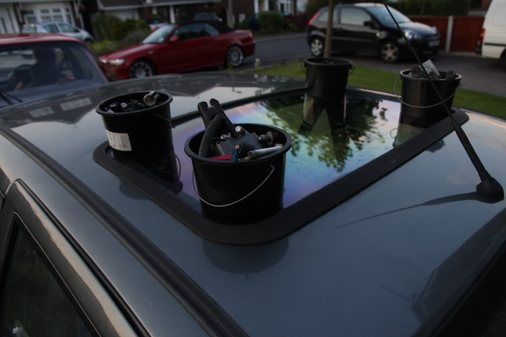

OK, time for a pic or two then...mine's almost the same spec in terms of weight removal as your except I've only replaced the one front seat, and I've not got any cage. Other things gone you've not mentioned are carbon canister, power steering, engine undertray and bonnet sound insulation/lining, airbags...and the door cards have gone too.
This is how it stands now
There's a surprising amount to be had from both door cards
Everything I removed I weighed on scales as it went into storage, and everything swapped (seats, mounts etc.) I weighed both and worked out the difference.
Then to check it all, I weighed the car myself to see where I ended up
Impressive results eh?
