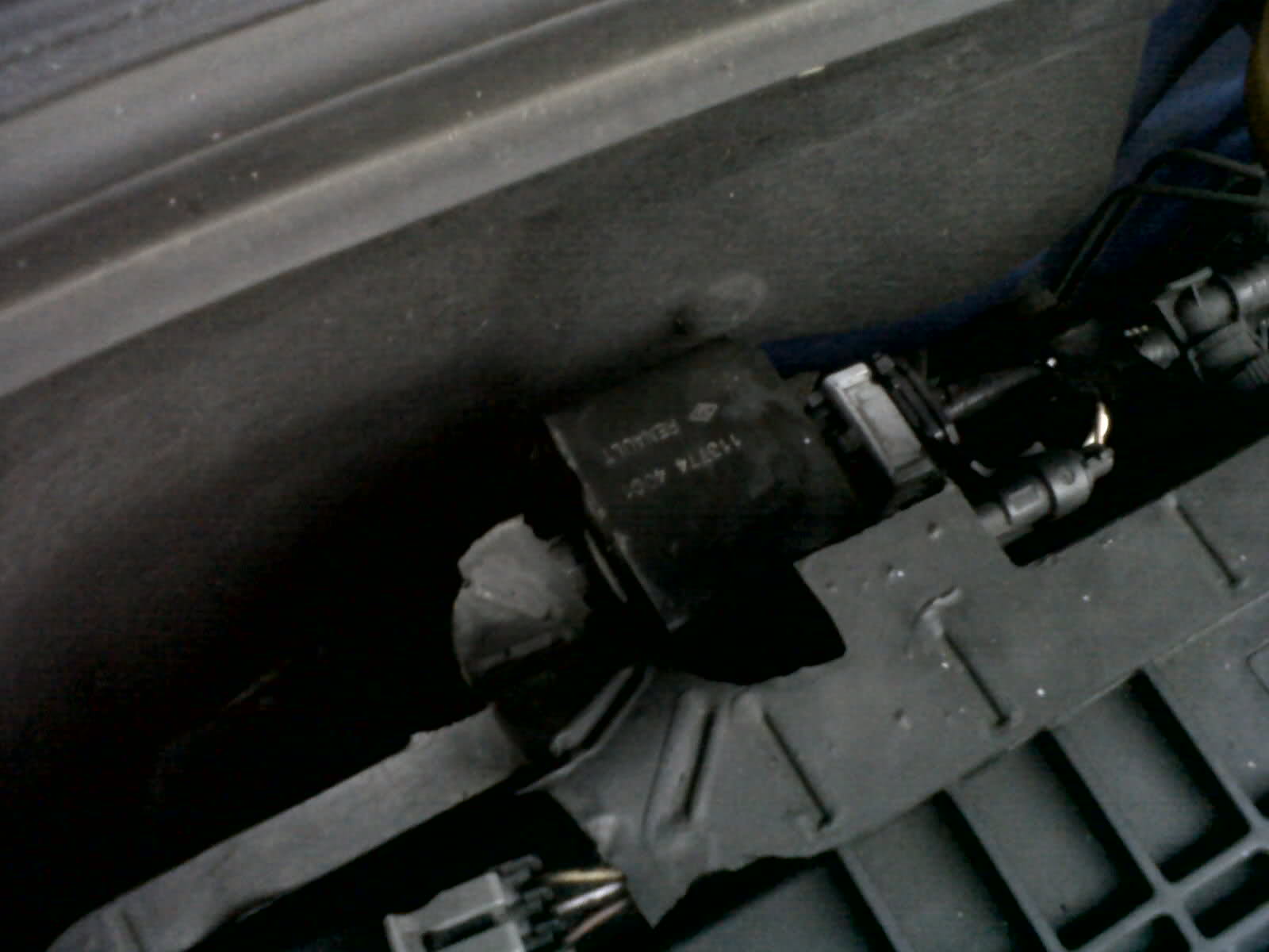

Ill check what I can then im gonna have to start uploading pictures to find out where half the parts you have mentioned are:P Thanks a lot for the replies guys.
Can't see the pic, but if its at the back of the block in the moddle then yes thats it, pull it off, no doubt its been chaffing the wires. This will be the source of your problem.
I'll have to do this tomorrow when its light outside. I will take a picture of it with the box off/out and show you so you can give me some more info, again thanks for the help guys.
I managed to spin the small brass wheel at the back of the box for about 5 mins but it has simply stuck now, wont budge. How do i get it off if the wheel wont move?:(
