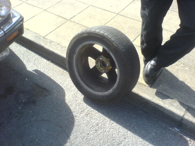

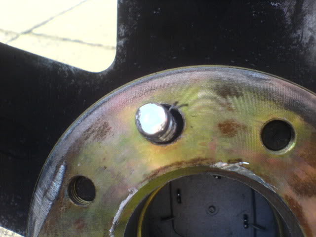

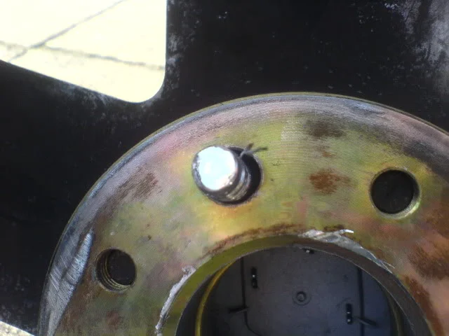

f**k! What are those spacers? The bolts that came with my Delta Mic hubcentrics where complete piss, JD on here and djroberts both snapped theirs so I changed mine straight away for a decent set.
Paul.M
They're delta mic ones aswell
pretty gutted I should have changed them aswell if i'd have thought about it
my own fault tbh just a bit gutted

sh*ttttt... what size spacers did you have on?
ive got 10mm ones on my rear wheels and just put the normal bolts in... got me worried now lol
they were 25 mm hubcentric ones they'll be coming striaght off I know that
Greeny.
  440i + 182
Thought all 25mm hubcentrics should bolt to the hub tbh, I know my 15mm's dont but i dont think any 15's do. I know djroberts 25mm's bolt to the hub. Just DONT USE THE DELTA MIC WHEEL BOLTS!!!!!!!!!!
The bolts failed not the spacers, plus the 25mm ones are meant to bolt to the hub im sure, hence the extra holes?! Plus he had knocking so if they where bolted to the hub maybe one of the bolts had already snapped hense making the marks on the middle of the spacers?!

the original renault bolts were still safely bolted to the spacer all came off as one
the delta mic ones however were the ones that failed
they should change their name to "takes the mic"

Ah right, well the spacers are fine, the bolts however are a joke. I rounded one of mine when I first removed a wheel so ordered some replacements :(

Should switch to wheel studs. So much stronger. :)

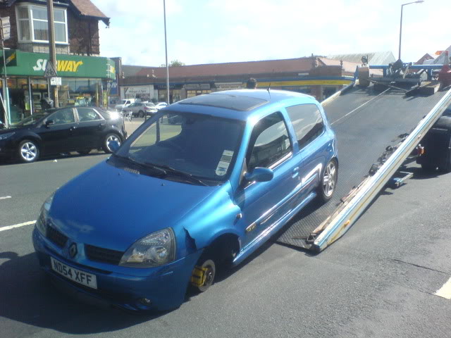

Jesus Paul, I know where that is aswell, you must have been well embarrased and most likely a long cue of cars behind you.

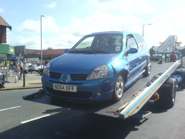

you should have seen the backlog
embarrasing isnt the word lol I just went for the 3 pounds hair cut now its looking not so cheap

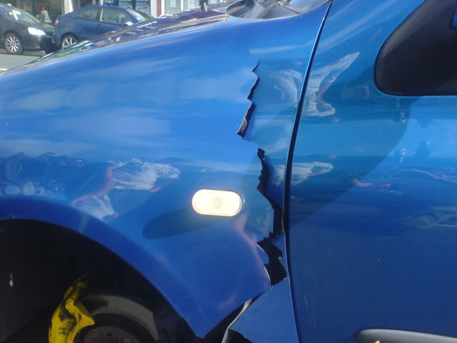

Have you got a damage report yet?
Jason_E
  Elise, 530d
Holy s**t! Wasnt expecting that!

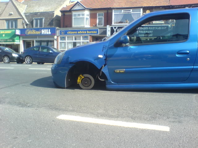

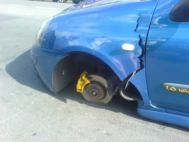

Ouchies. Well whats that a new wing plus respray and new disks. I'm gunna hazard a guess that new spacers are required? Could have been ALOT worse, quite lucky it happened at low speeds!
garage is phoning me monday Im not touching insurance though just gonna pay it

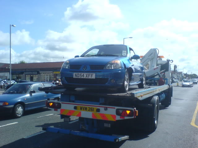

its mjt cars in bispham hes in the old tvr unit does all my work for me and apparantly body tech does his spraying so its in good hands :)
