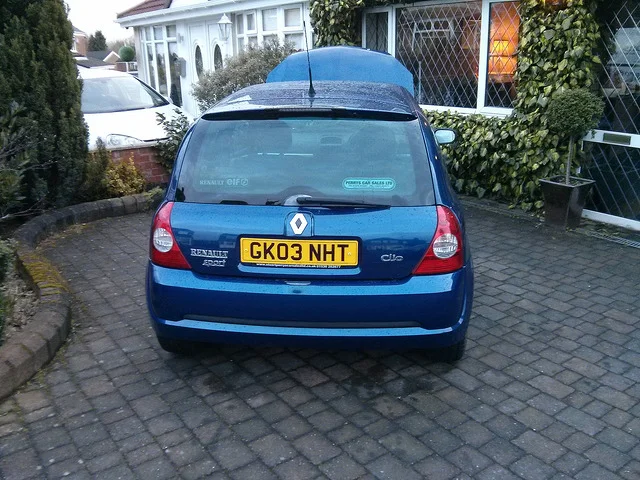

Really Blurry Monaco 172 by welshname, on Flickr
Monaco 172 Rear by welshname, on Flickr

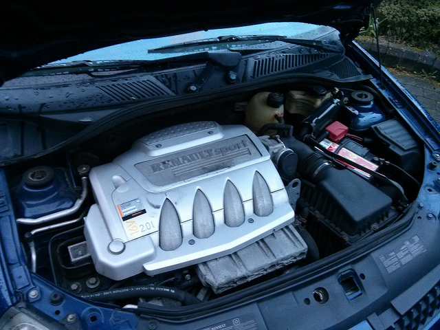

Engine Bay by welshname, on Flickr
100% genuine Renault parts there if you ask me...

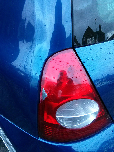

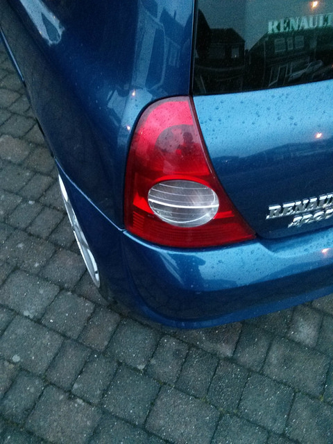

So rear light before:
Cracked Rear Light by welshname, on Flickr
And After:
Replacement Rear Light by welshname, on Flickr

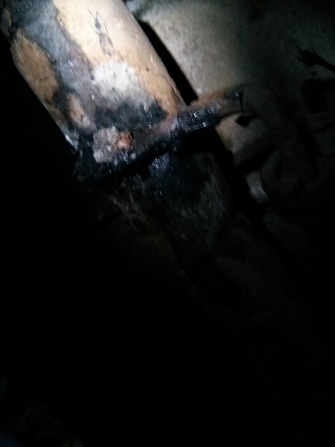

Bodged exhaust repair:
Bodged Exhaust Repair by welshname, on Flickr
Not sure you can see but it looks like black silicone, it got progressively louder on my way home so I've removed it all and gummed it up properly. Just waiting for it to set a bit as the first time it blew through again (no pictures as my hands were covered in the stuff), then I'll start the car and let it run the exhaust up to temp.

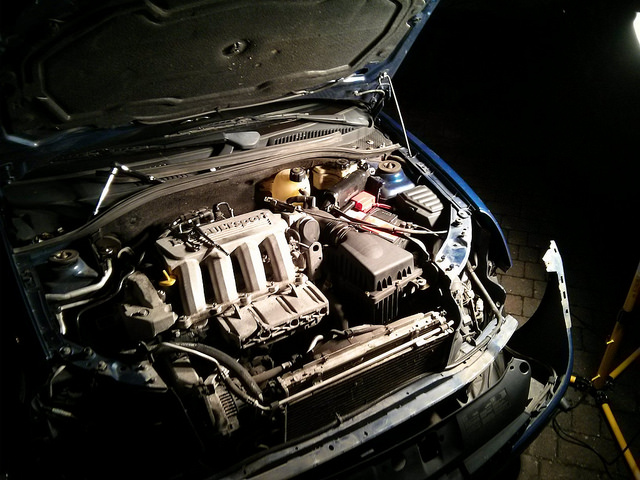

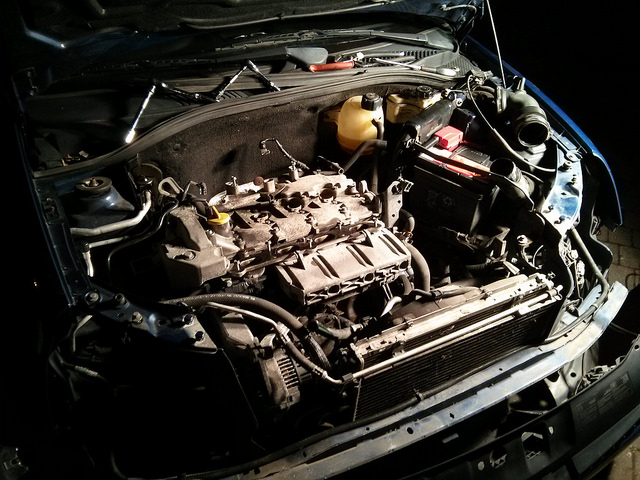

Tonight I decided to start stripping down the front end ready for the belt change at weekend. The weather is forecast to be pretty poor on and off so I want to make the most of the good bits of weather to be doing the important stuff.

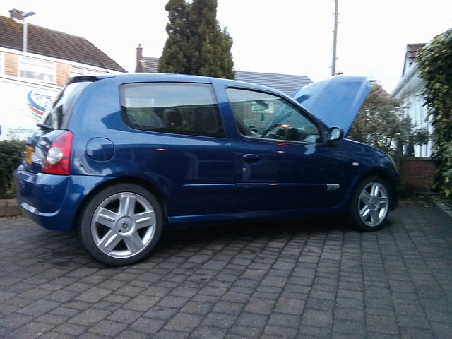

Started by getting the front bumper off (which took an absolute age because I couldn't get the drivers side bolt out of the wing). Followed by the slam panel and the headlights.
Slam Panel and Bumper off by welshname, on Flickr

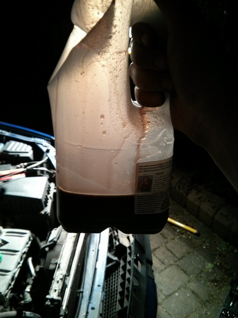

Then drained the PAS Fluid which was completely black
Black PAS Fluid by welshname, on Flickr
Then decided to take the upper inlet and airbox off
Inlet and Airbox off by welshname, on Flickr

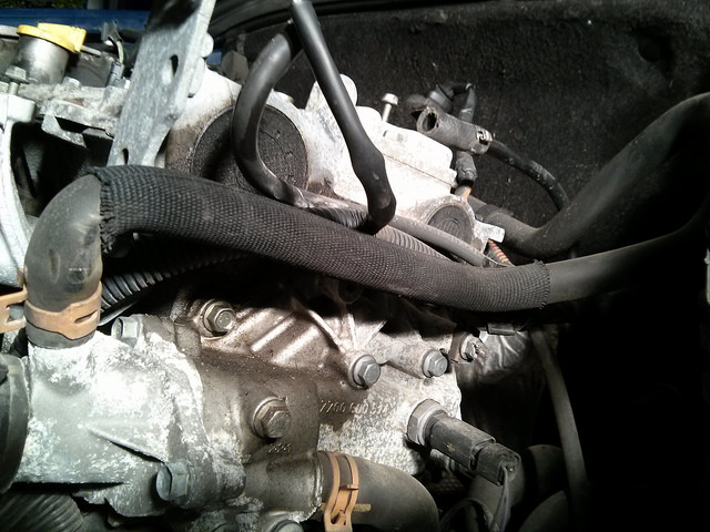

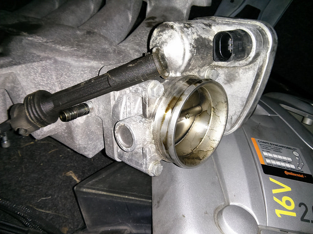

Quick check of the throttle body showed some oil around the outer lip (is that normal or does it appear to be breathing a little heavily?)
Throttle Body by welshname, on Flickr

In respect to the throttle body oil, that is breathing a little bit. You going to compression test / leak down at some point?
