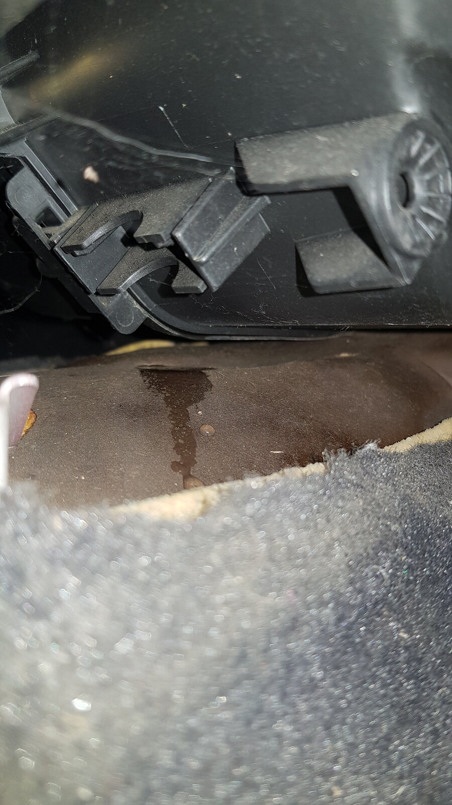

This is doing my head in now! Car is parked pointing up hill, after I quick lunchtime investigation it seems water IS getting in through the bulkhead somewhere. All 3 scuttle drains are clear and not losing coolant so in guessing it's getting in through a bulkhead grommet.
Attached a pic of where water is forming.

Has the car ever had a replacement windscreen? I had a leak for ages on one of my old ph1's. Took the dashtop off and water tested it. It was coming in the windscreen seal and running along the back of the dash and dripping into the footwell.

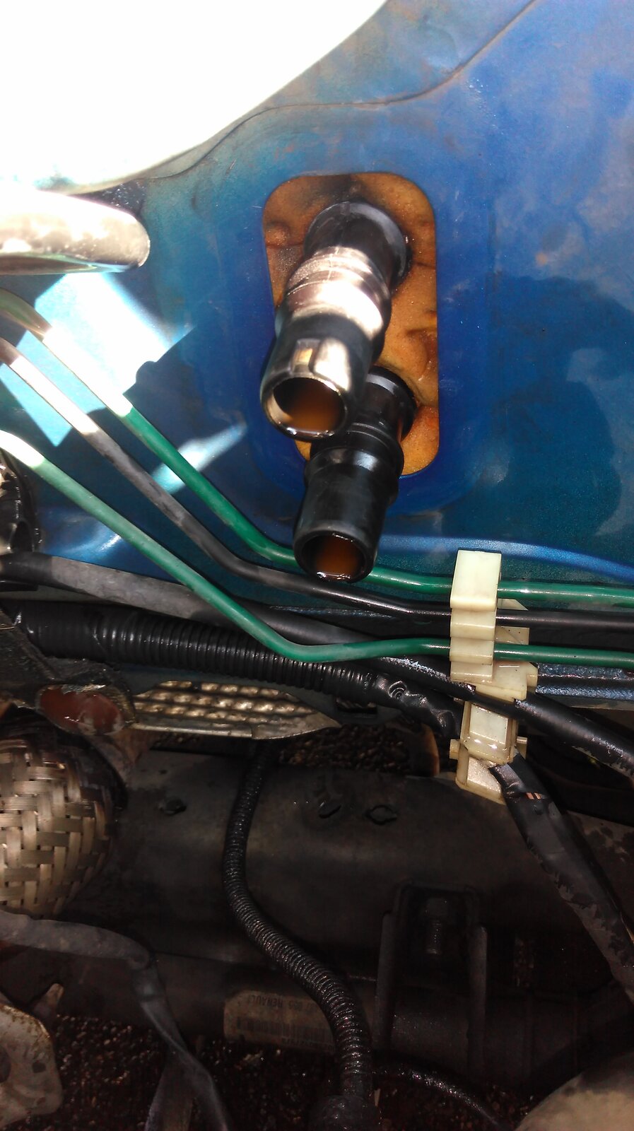

Just had another look, I wonder if it's coming through where the heater matrix enters the bulkhead. There is what looks like water track marks on it.
DomP182
  ph1 172, Arctic182
Well it was coming through where I thought, not looked in the scuttle but what I dont get is that the heater matrix enters the footwell below the scuttle so how is water getting in via the scuttle?

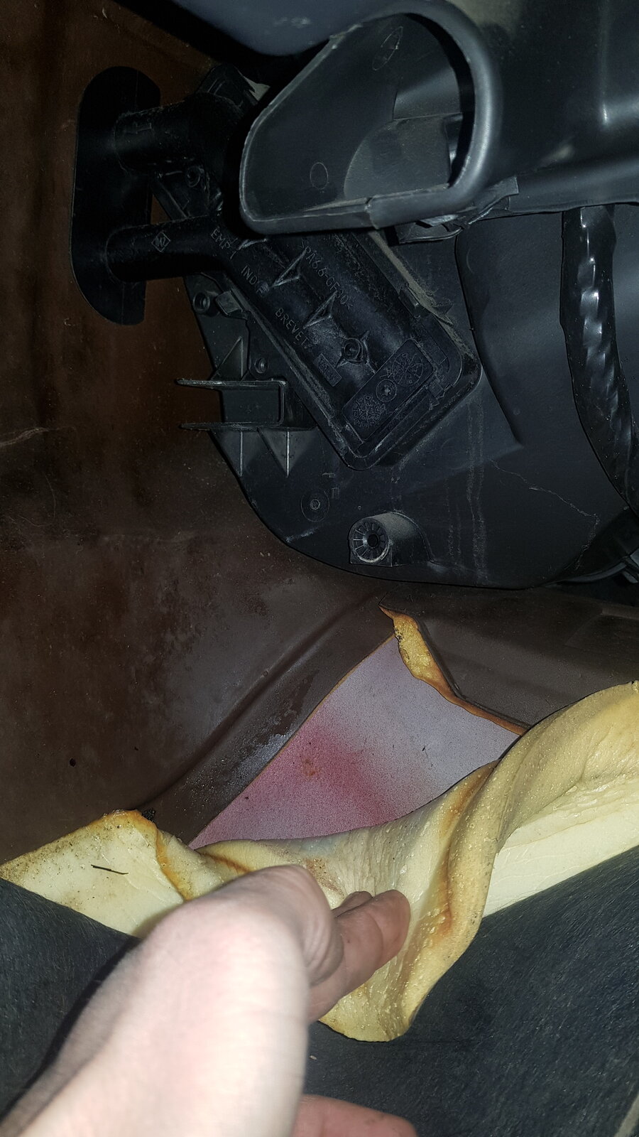

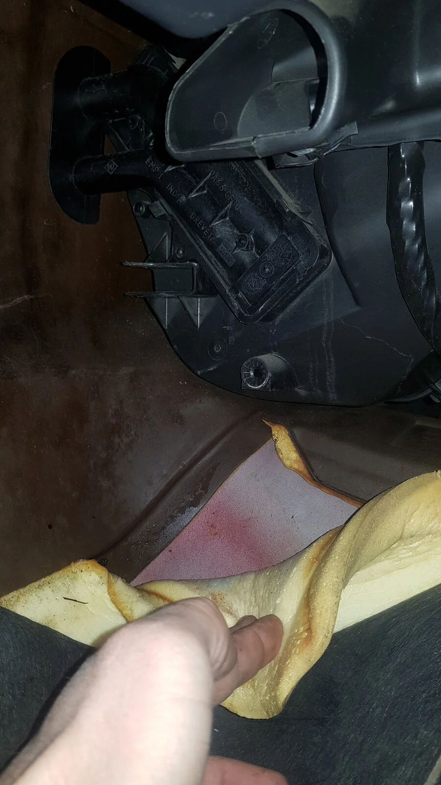

Start be removing wiper arms, scuttle covers and then strip out the washer bottle, alarm and central heater box. I didnt want to take the whole heater blower out so I maneuvered it so that I could clean off the old foam seal and replaced it. I used black gutter sealant and applied liberal amounts to ensure a seal as I didnt want to be going back in there in a hurry.

That's not the part that leaked on mine, it was the heater box that sits on the base of the scuttle dead centre

No signs of moisture at all mate.....touch wood! It was 100% the centre heater blower seal but not helped by a small sweep from an unsealed passenger door card.

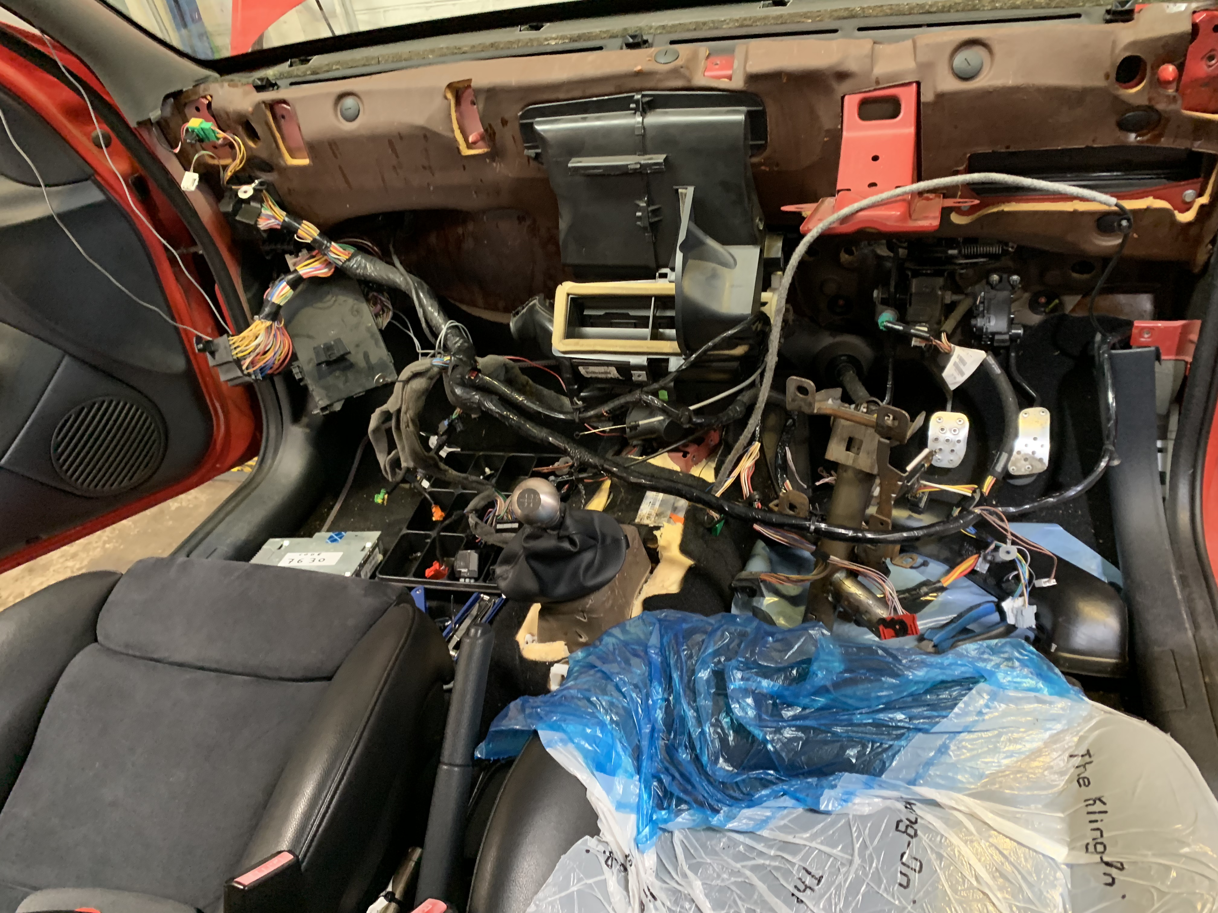

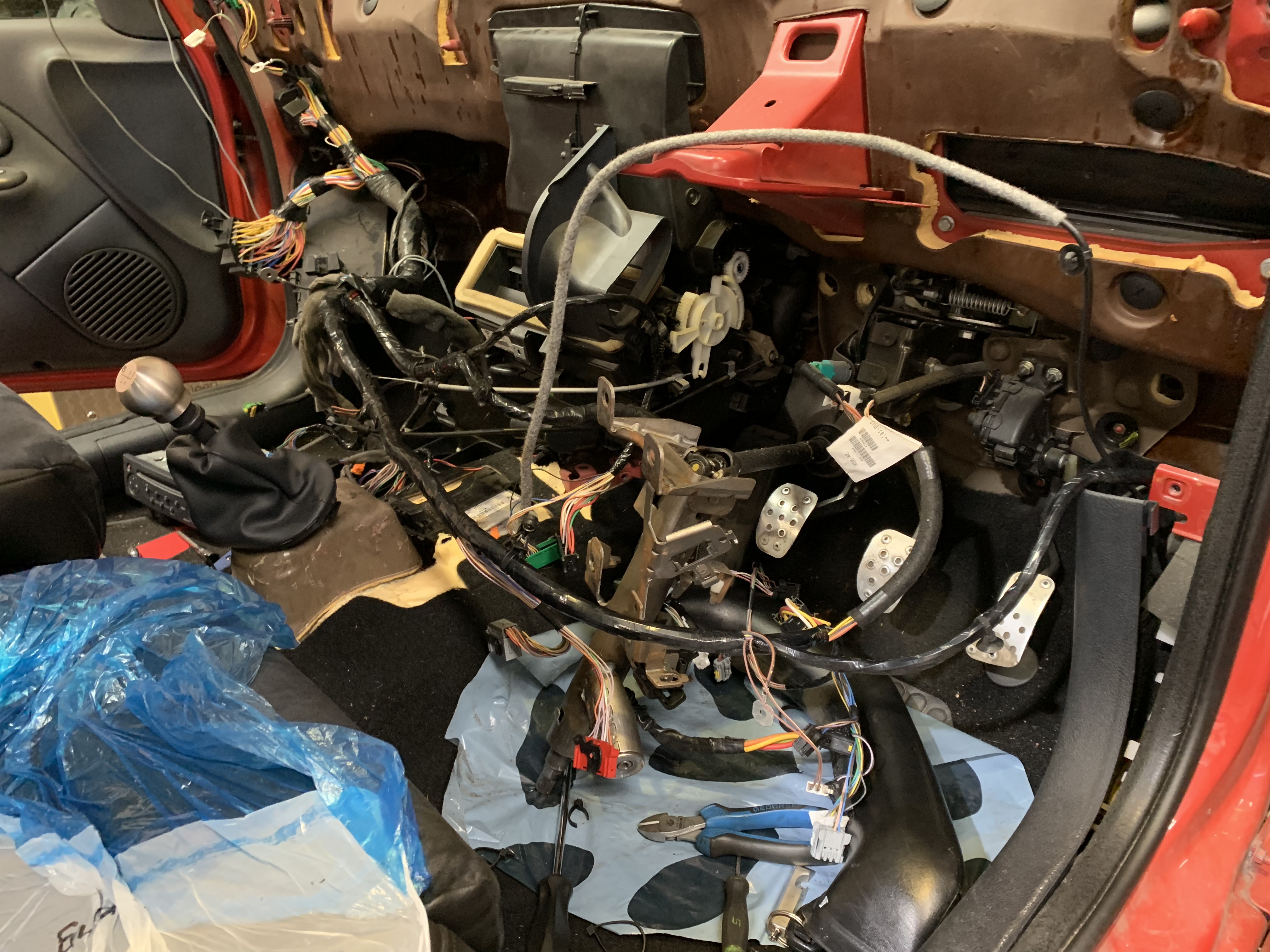

The thing I hate most is thinking about doing the heater matrix if it goes.
I have a wet passenger footwell in the the 197 but with looking at it closely and watching it over a period of time its the door rubber / seal so going to price one up and get it done asap.

That’s some effort there:oops:
I have read about the heater matrix needing replaced if it’s too far gone. No a job I fancy doing in the depths of winter haha.
