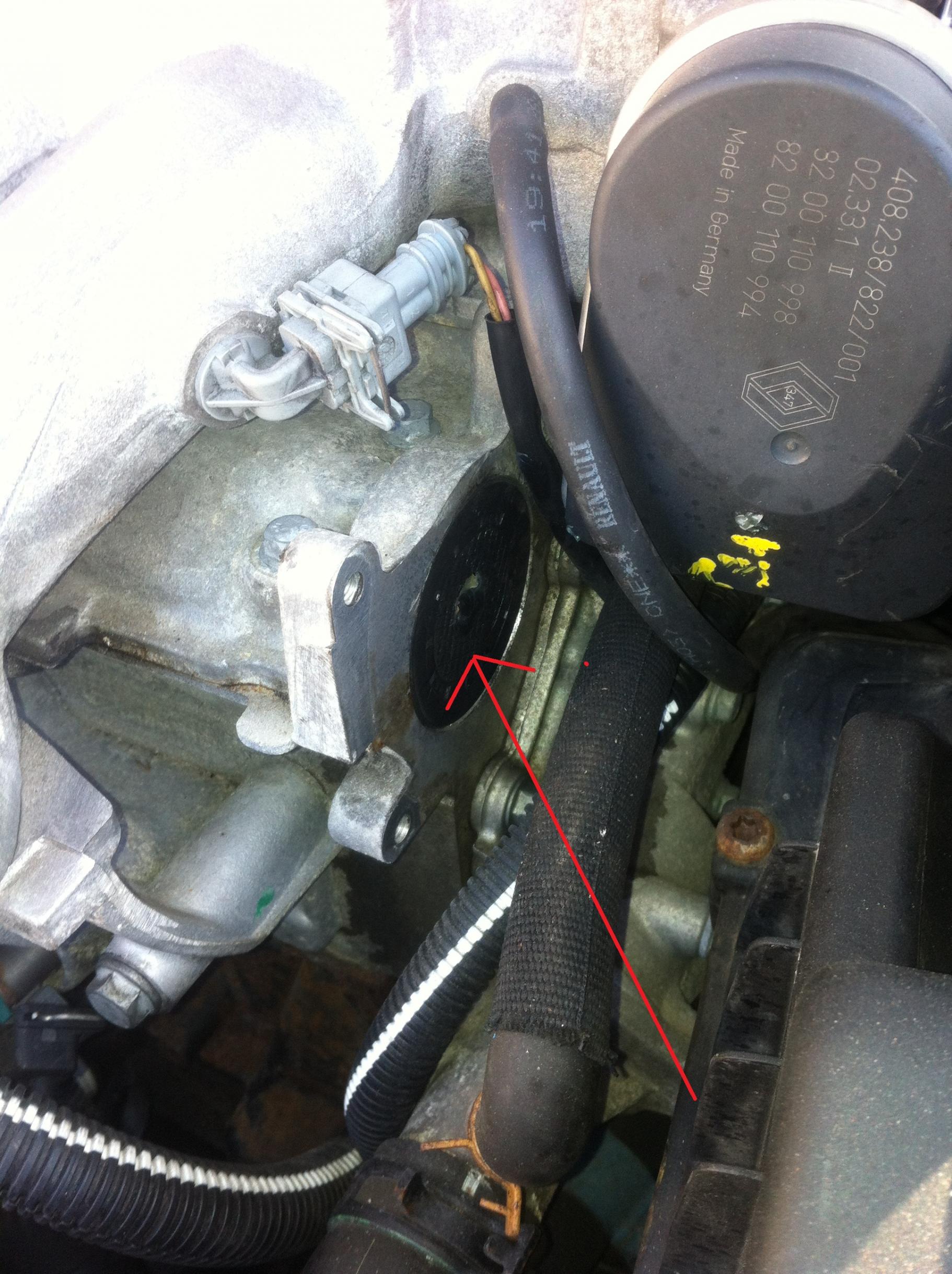

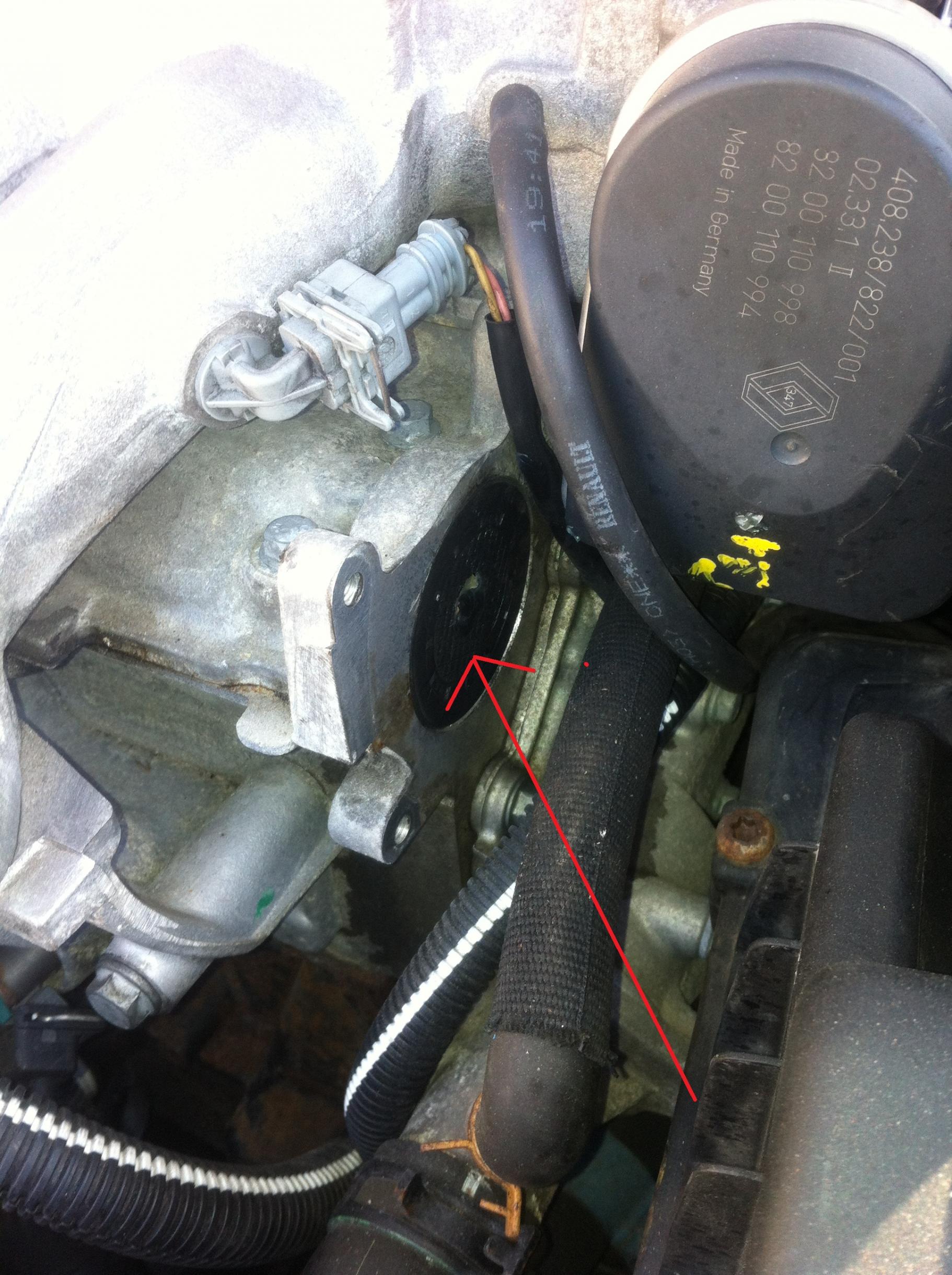

Car  clio 172

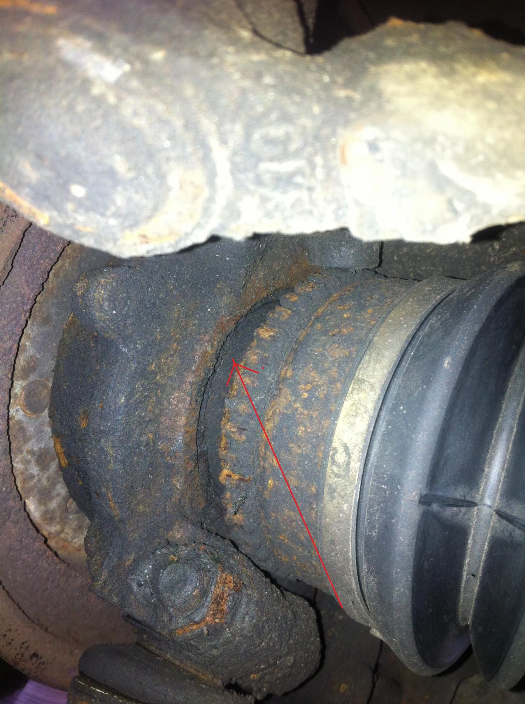

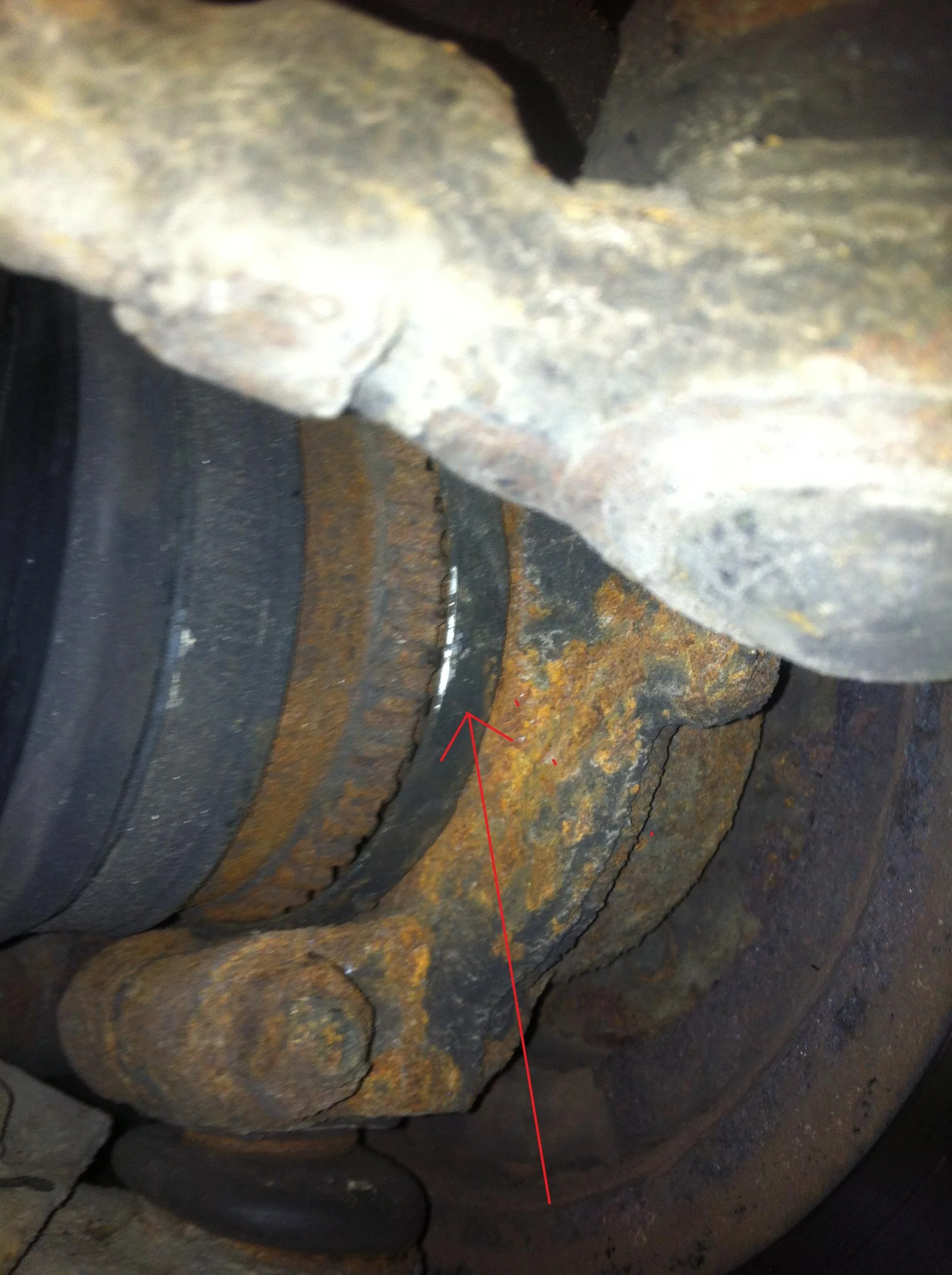

well so far noticed my driveshaft boot has split.
could any1 tell me how to resolve the problems below
What is its purpose and does it matter that theres a split in it?
what is this metal ring next to the abs ring? its loose and not fixed to anything, also there isnt 1 on the passanger side.

That's the cam seal and yes it does matter if it's split and sounds like you need new driveshafts,if they've been split for a while with no rings on them,which looks like the case then the cv joints will be shot and probably overheating,
can i just cover the hole in the plastic cap or does it need replacing what is its purpose?
cheers for bearing with me by the way I am a noob a this sort of stuff.
im no expert mate but id get them replaced, theyre not exspensive, you can buy them from k-tec not a difficult job but a fair bit to remove from your engine before you get to them.also got to be careful taking off your rocker cover,the cam can lift with it.probably best to check on here for a guide if there is one.

Camshaft seal. So yes it matters, oil could get out or dirt could get in.
You dont need to remove the rocker cover, the centre of the metal part of the core plug is missing, so just poke something through the soft rubber in the middle and pop it out. Don't go all axe murderer on it or anything, but a fiddle with a flatblade screwdriver will pull it out. Then the new one just knocks in its place with a flat drift.
