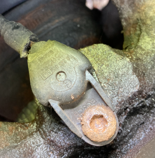

What bolt/screw is this?
Car  Clio 182 Cup
As you'll probably notice in the picture, the ABS sensor is knackered. Nice easy job to replace, if it weren't for the knackered retaining bolt/screw...
I'm confident that I can get the bolt/screw out, one way or another. I'm also reasonably confident that the bolt/screw won't survive the process.
Can anybody tell me what the length and gauge of the screw is so that I can buy a couple in advance of destroying the originals?

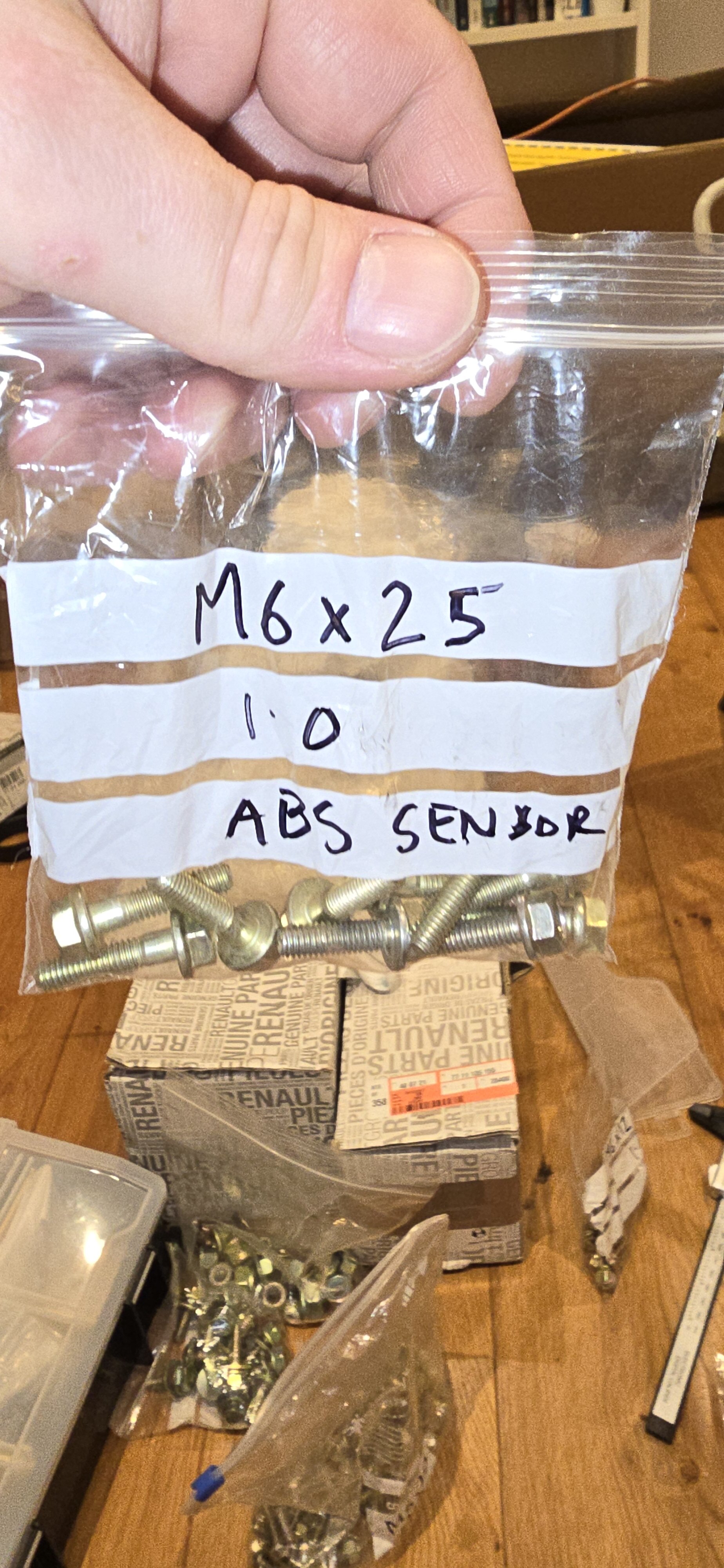

Installed today. M6x25 1.0 pitch
They fit so tight you don’t need the bolt. Originals are torx so someone has already had a go at that.
I probably need to start managing my own expectations and stop thinking that jobs will be a) simple or b) quick, just because they should be…

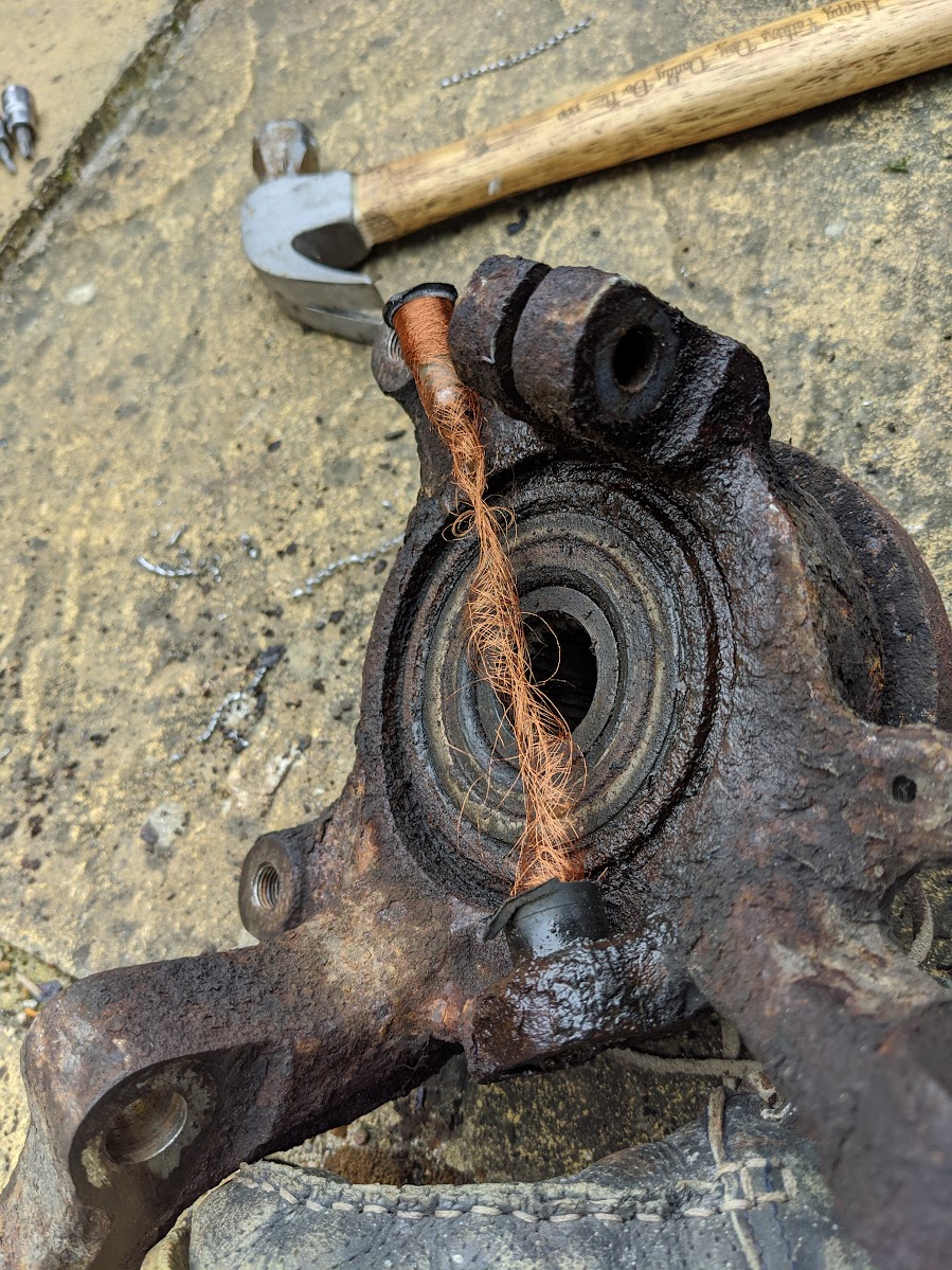

I had to file these down the other day to get them out. Long socket over the abs sensor then a gentle tap with a hammer.
