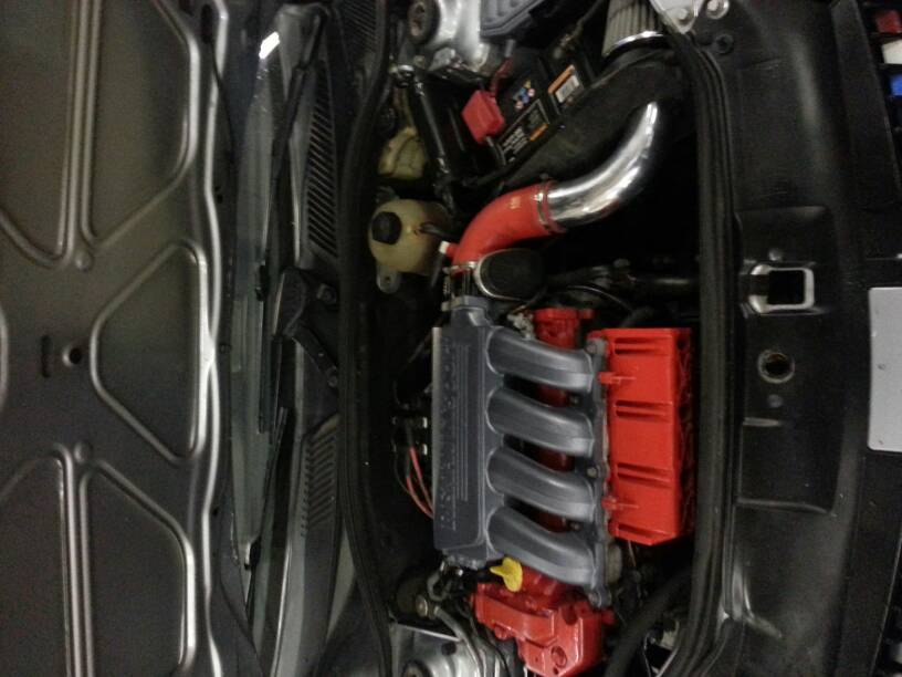

i got mine of ebay, was 18 quid for an alloy elbow, 70mm diameter, 90 degree bend and 150mm leg lenght, although some people might want shorter, but you can cut it
egnor the green extention on the filter, i cut the elbow short because im getting a slim but long green cotton filter to go in rather than that horrible dirty blue thing lol
A.S.H
70mm 90 degre silicone hose
70mm 90 degre chrome bend
Twin cone filter
Breather hose
Breather filter ( cant remember diameter)

Bought off Danith for 45 bucks. Best money ive spent on the car so far!
The elbow is a Hillpower one with th fitment there for the breather.

Surely i could have the standard 182 plastic bend then just have the new aluminium bend coming out of the standard 182 bend into the cone filter? Or would the 182 standard bend be too long?
I remember seeing someone post their DIY kit on here a while back with links to the whole kit, but I cant find it anywhere now! anyone know the thread I'm on about?
Martin, thanks for that, I'll have a look but for now I'll use the standard plastic elbow with the alloy bend go in into that
Im using the standard plastic elbow, that alloy bend and that twin cone filter.
