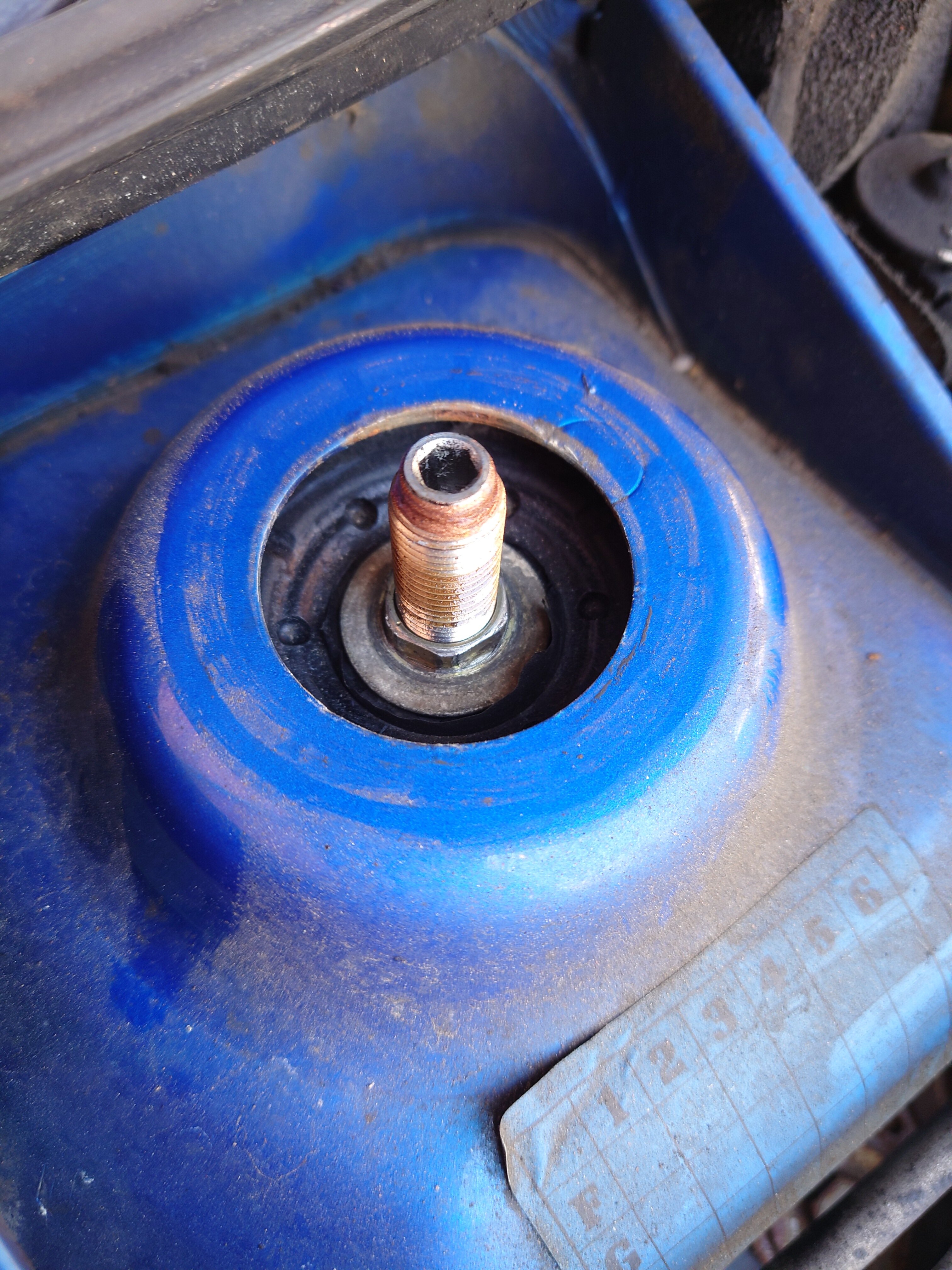

I wouldn't mind if I'd been told about all this s**t. When I bought the shocks and springs there was a helpful bit saying you should probably order new top mounts as they are likely to have worn out, so I ordered a pair. What it didn't say was that your dust cover/bump stops are also going to have fallen to pieces as well so order a pair of those as well. Or that the brand new top mounts don't come with the spacer in the middle, or even the f**king nut to attach it to the shock. Which would be fine if one of the old shocks wasn't refusing to come apart. Currently stood in the kitchen glaring at it through the window while half a can of penetrating spray slowly seeps into it. Cunting thing.

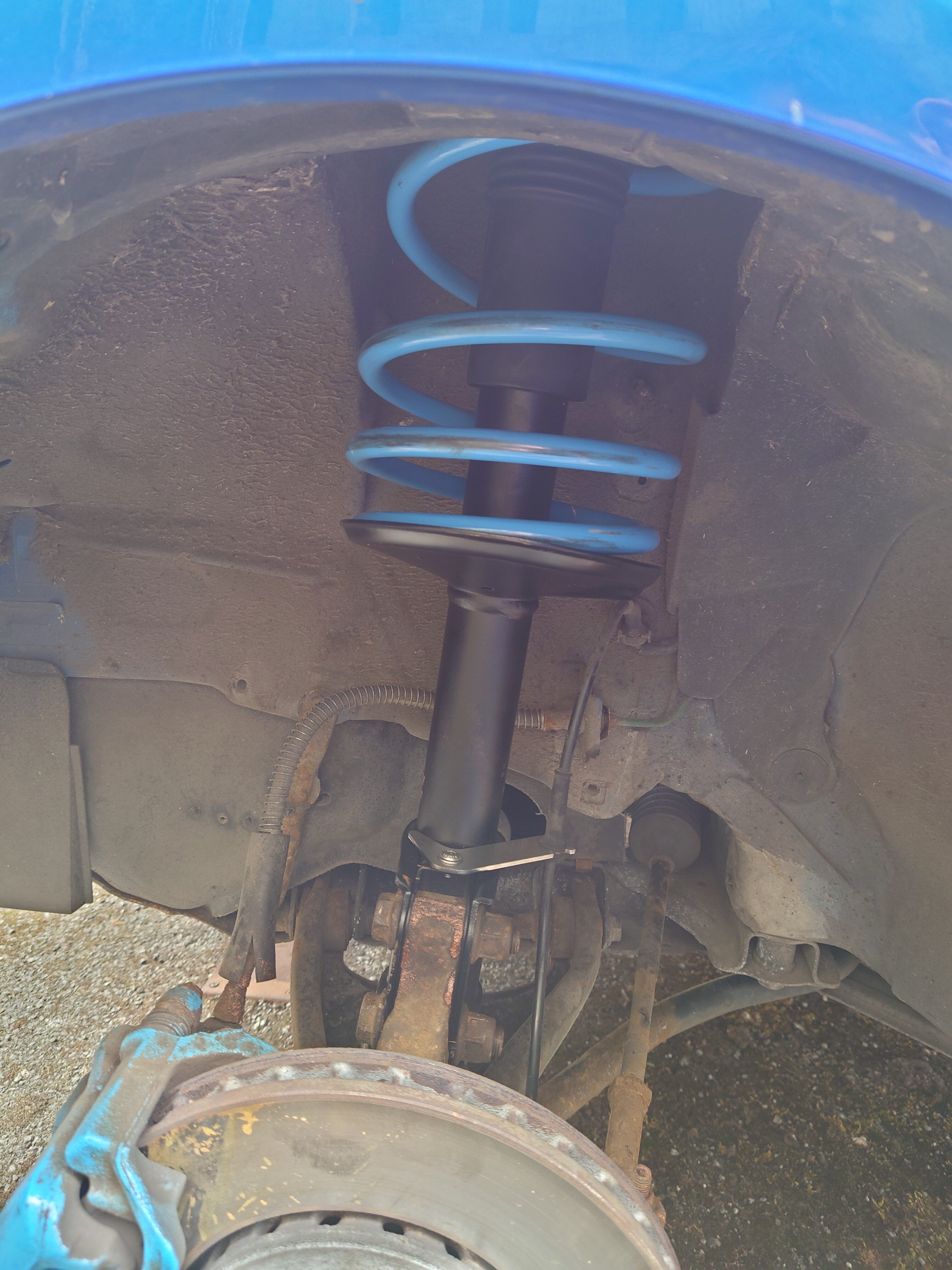

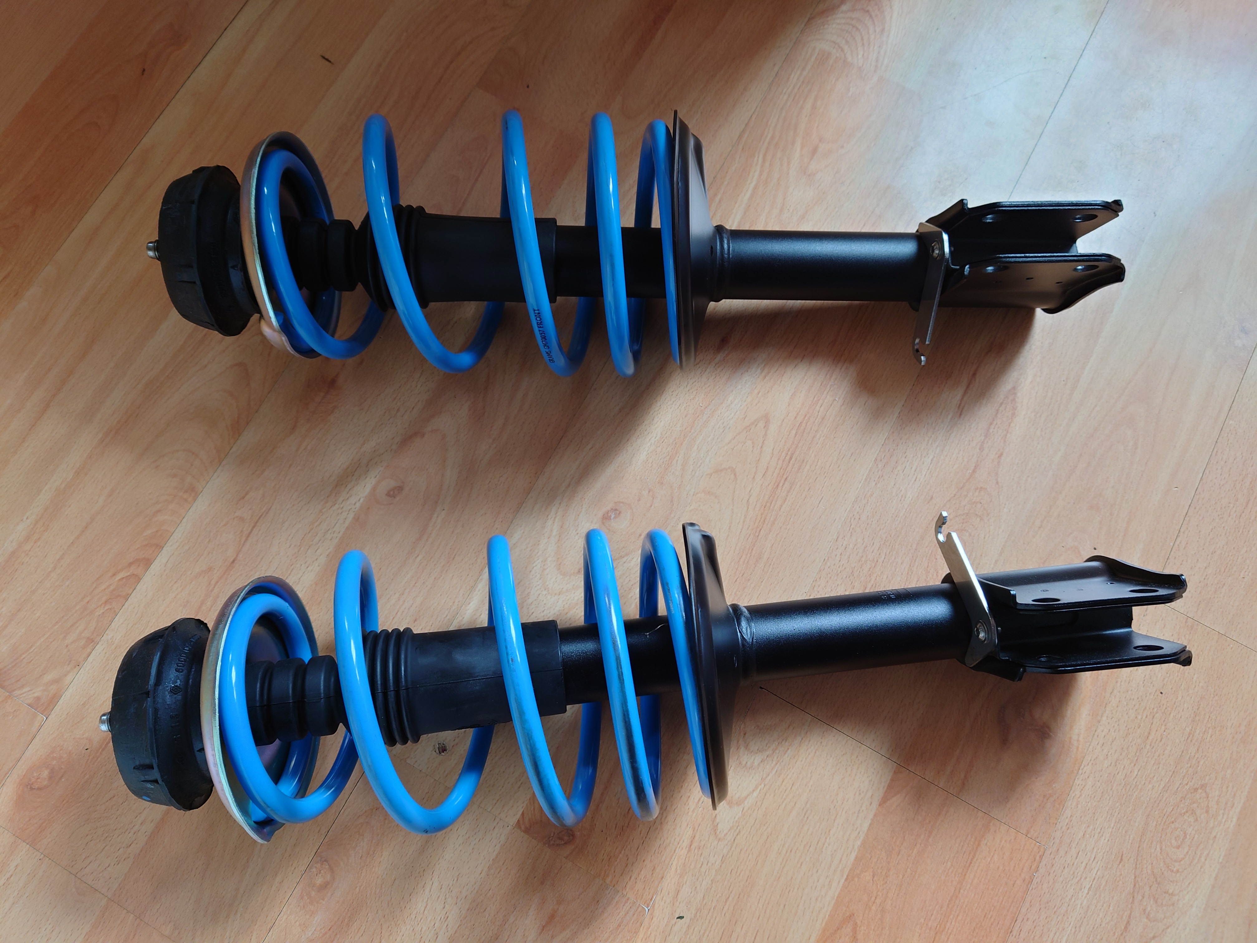

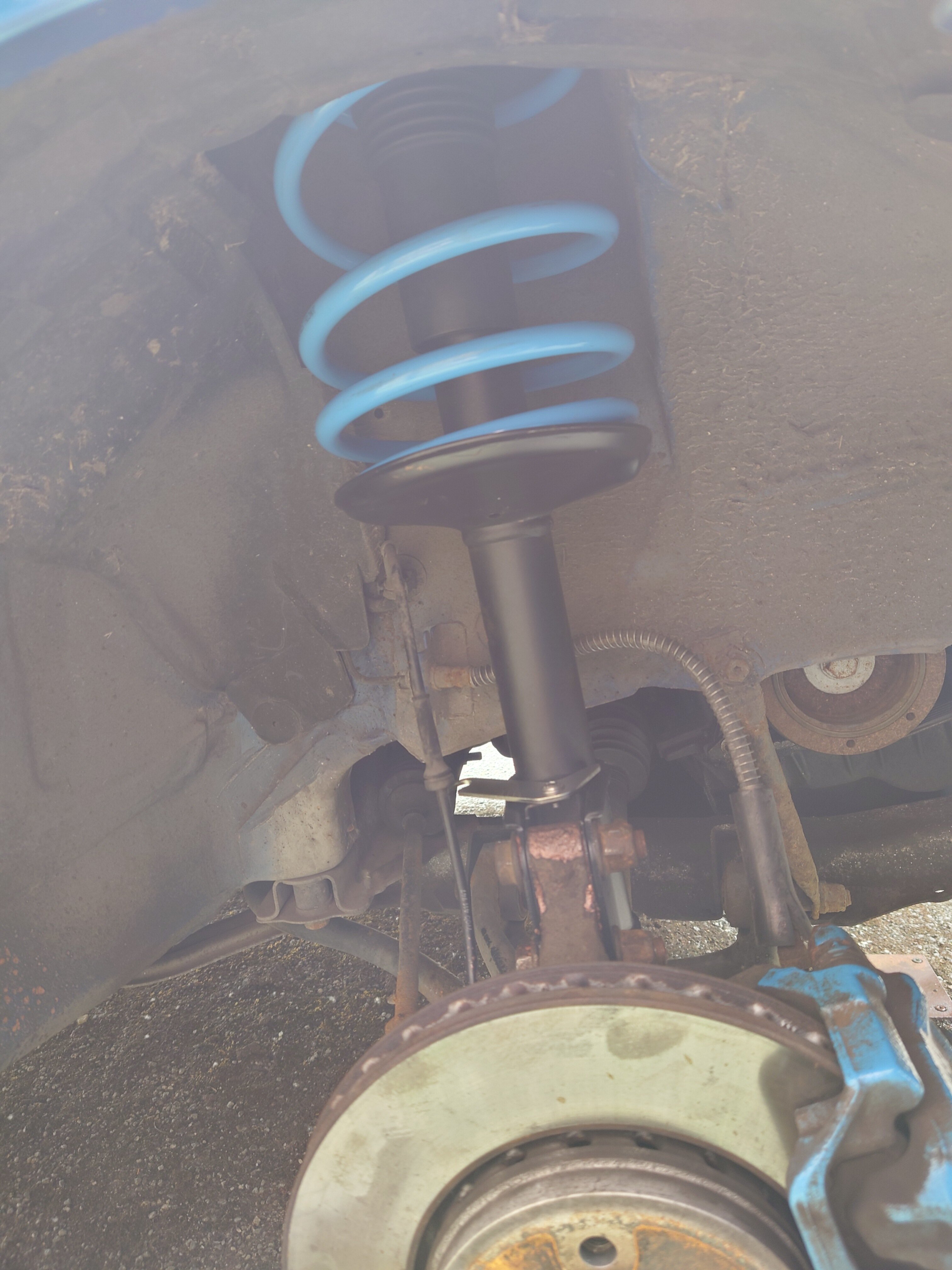

Gave it one dugga from the rattle gun and called it a day. The top mount I just did hand tight. Just out for a test drive and so far there aren't any funny noises and the car feels less crashy over bumps so I'm guessing everything is as tight as it needs to be. I'm guessing the springs will settle a little bit as it seems a touch high at the moment, especially at the back. They're Grams springs on 172 cup dampers for reference. Ended up replacing the rear spring seats as well with some powerflex ones as they weren't in the best condition, they weren't falling apart but seeing as everything was apart I thought I might as well.

It's only to hold the top mount on really, for when you take the strut off. The weight of the car holds everything tight.

It can’t be 105nm surely to god. Just whack an Allen key in the top and crank the nut down.
