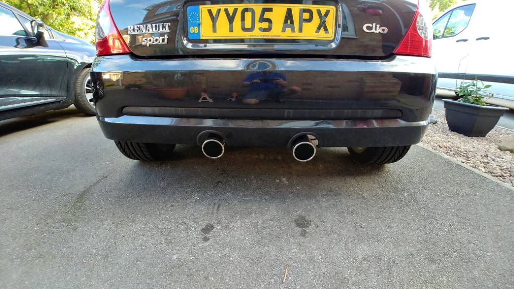

Fine tuned it. It absolutely will not sit higher in the bumper but now they are equally as low instead of different heights! Crappy scorpion shyte.
You need to get rid of the standard exhaust mount rubber mate, and polybush it so you can drill holes and get the hangers to sit higher in the squares and sit flush
