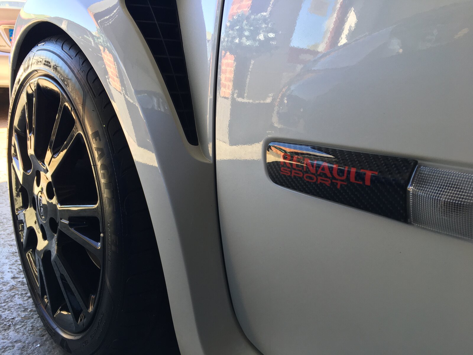

Fitted my carbon fibre door bullets....

Did you have someone make those for you? Mine are fucked but I can't replace them with standard ones 🤣.
Yeah they were from CarbonSkin’s aka Matthew Hayward on Facebook. Top quality, really pleased with them!

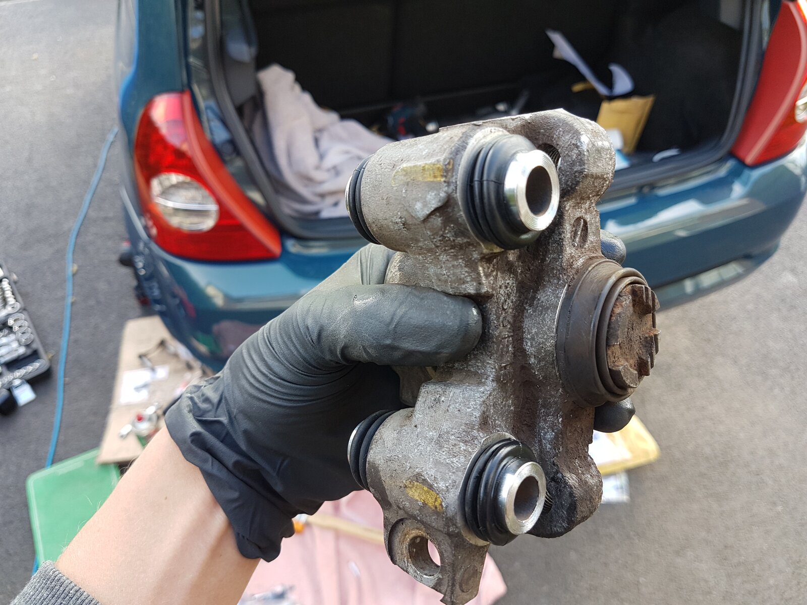

Replaced the rear passenger stub axle today, in typical fasion on of the torx bolts got rounded after the nut got seized. Great. Dremel out and after an hour of grinding finally got it off. New stub axle on, new brake disc and spacer on, all going well until i realise the brake caliper carrier isn't lining up??? One for tomorrow to solve.
JamesBryan
Not lining up side to side?
If so, the caliper is on slider pins and will move in and out. If it doesn't, yours are seized and will need greasing.
MLB
Undo the brake line and take the handbrake cable out. Remove the bolts through the sliders and the whole caliper will come off. Then remove the brake line.
Check if the seals are still intact, if they are you can just pull out the metal tubes, clean and regrease, otherwise send an email to Biggred for some new seals or a whole new slider kit.
