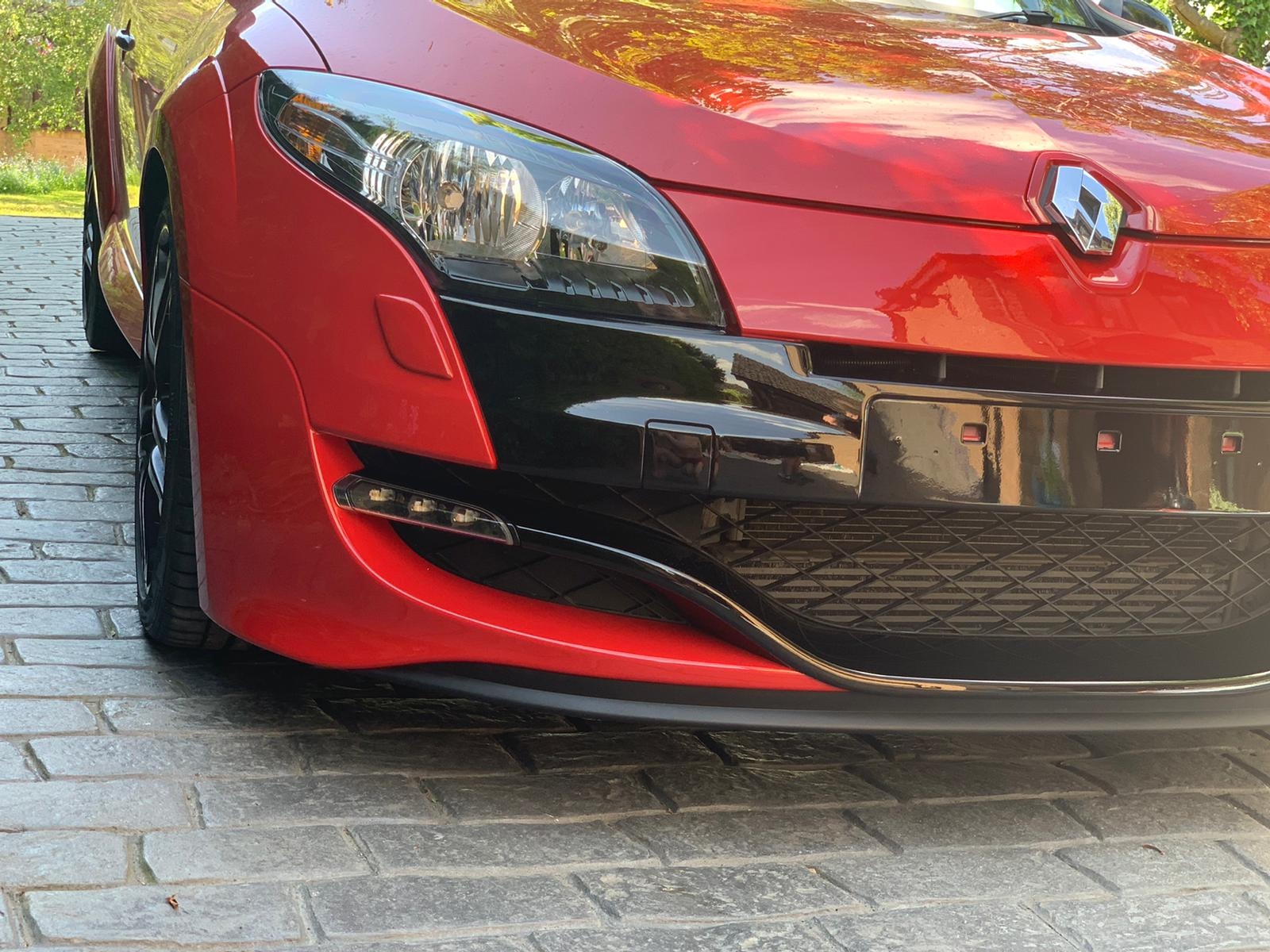

Replaced the bumper
Removed the old one which was looking tired and had some broken clips, stripped down all the bits, and refitted to a new one
the new bumper and black inserts have had fresh paint
Fresh 😎

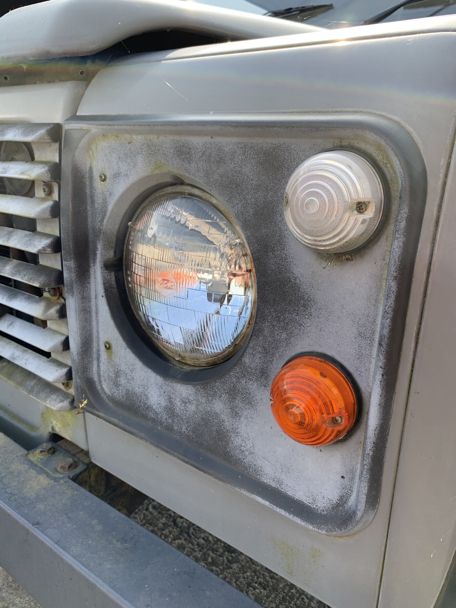

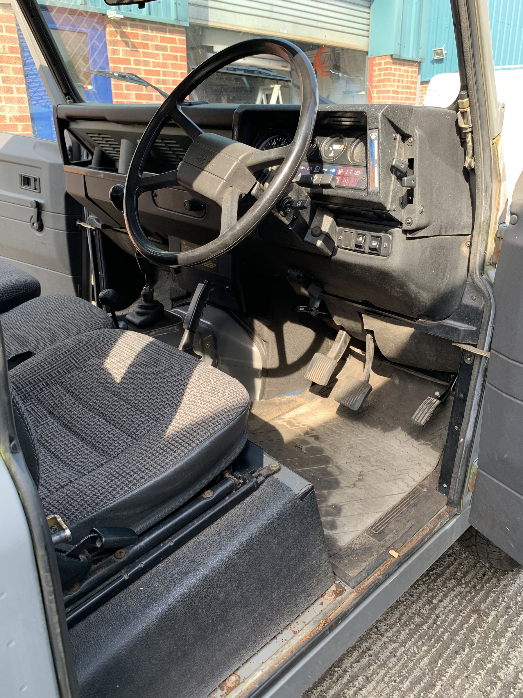

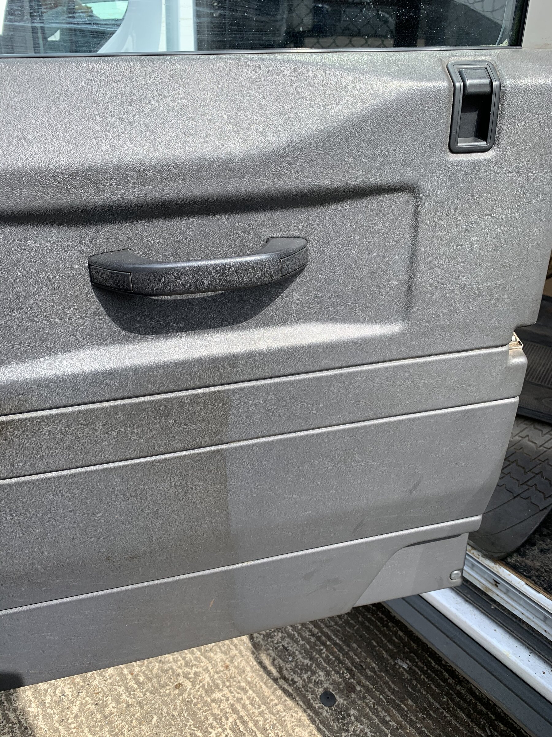

Not my car but I had the job of giving this the once over, was quite concerned about touching the canvas for fear of A) it falling apart & B) it looking 10x worse than it does already so I opted to play safe and leave it be.
It doesn’t look too different from a distance but it’s noticeably less green in places now 🙂

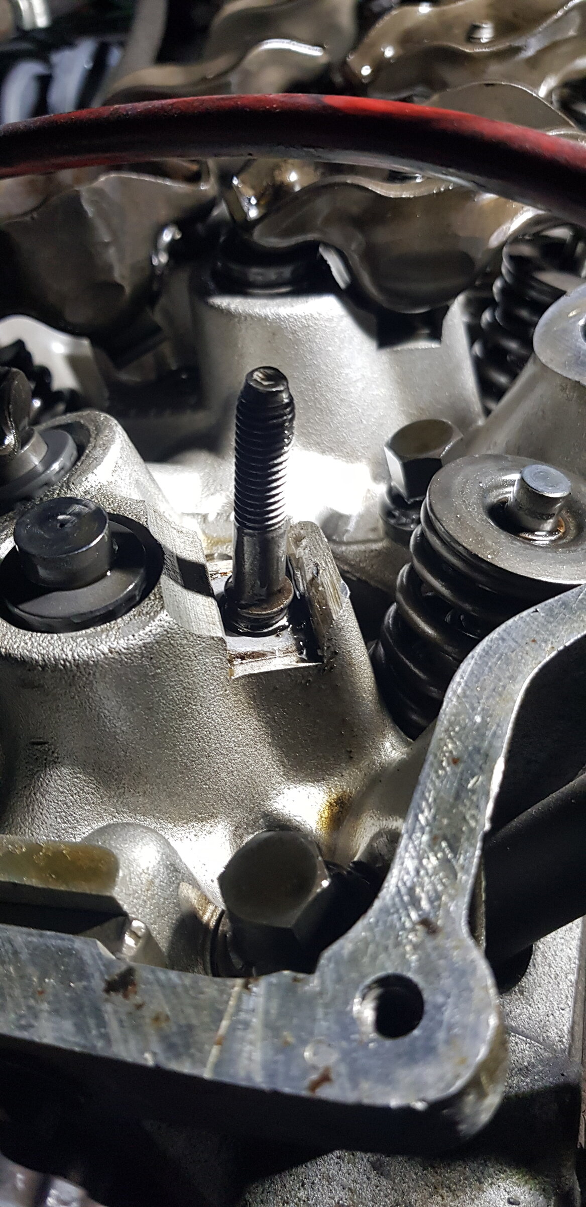

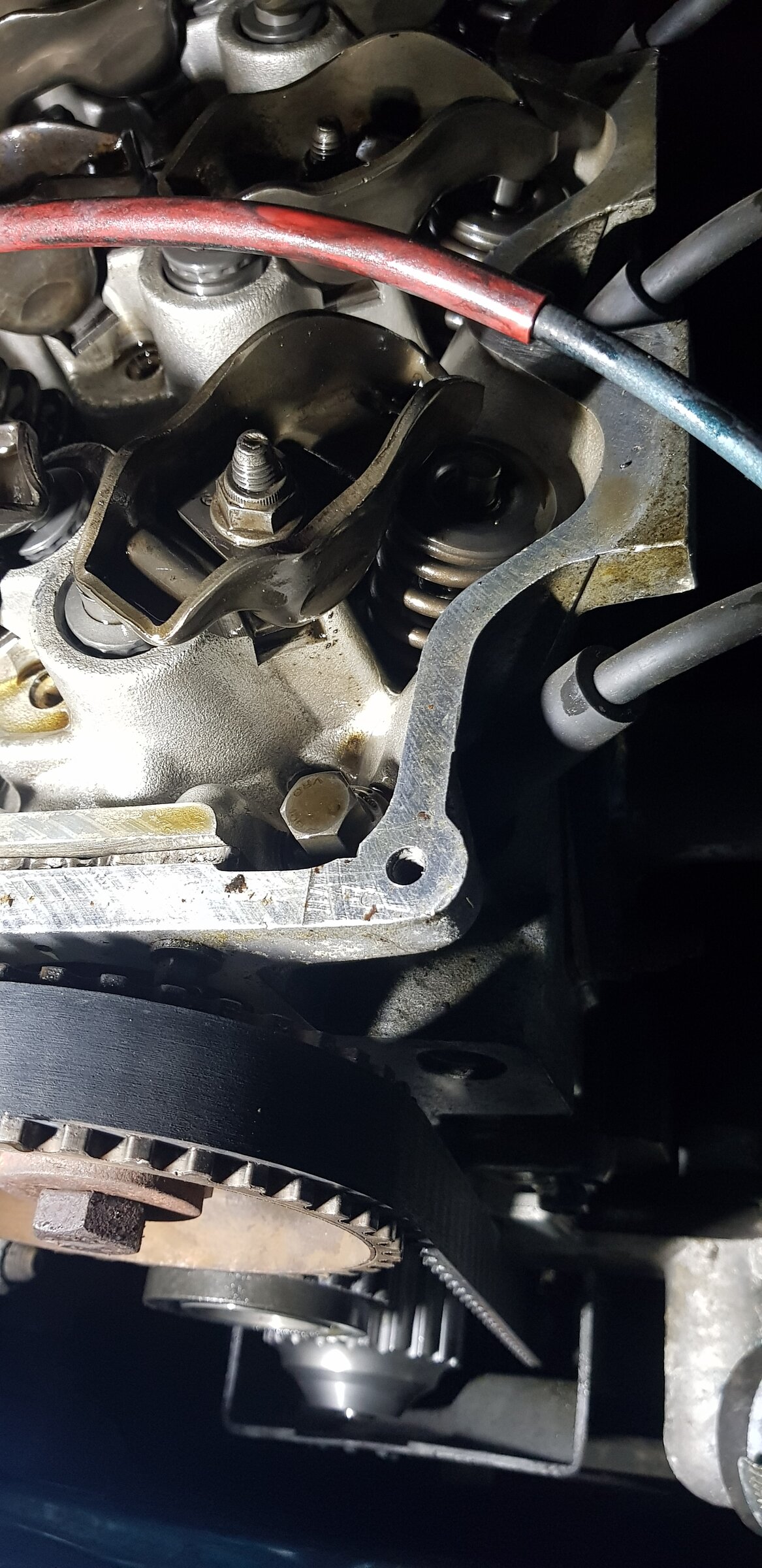

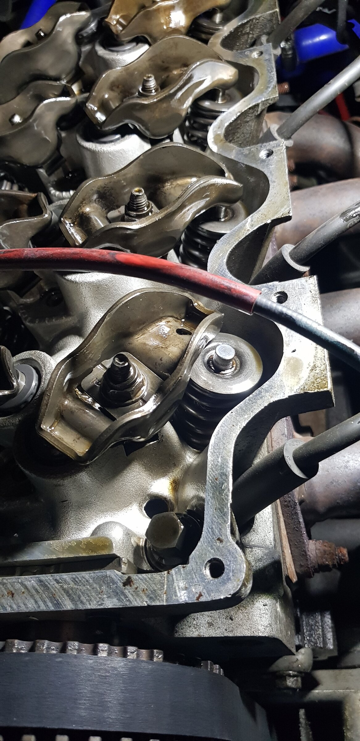

The Fiesta decided to pull a rocker stud out Wednesday and I managed to limp it home. Fuel gauge decided to stop working and gearbox has been a right pain to get in 1st and 2nd from cold. So today with my new helicoil kit I refitted the stud, fixed the fuel guage, which was an earthing issue and changed gearbox oil for some 75 - 90 fully synthetic that so far seems to have sorted the selection issue. Pics of the offending stud

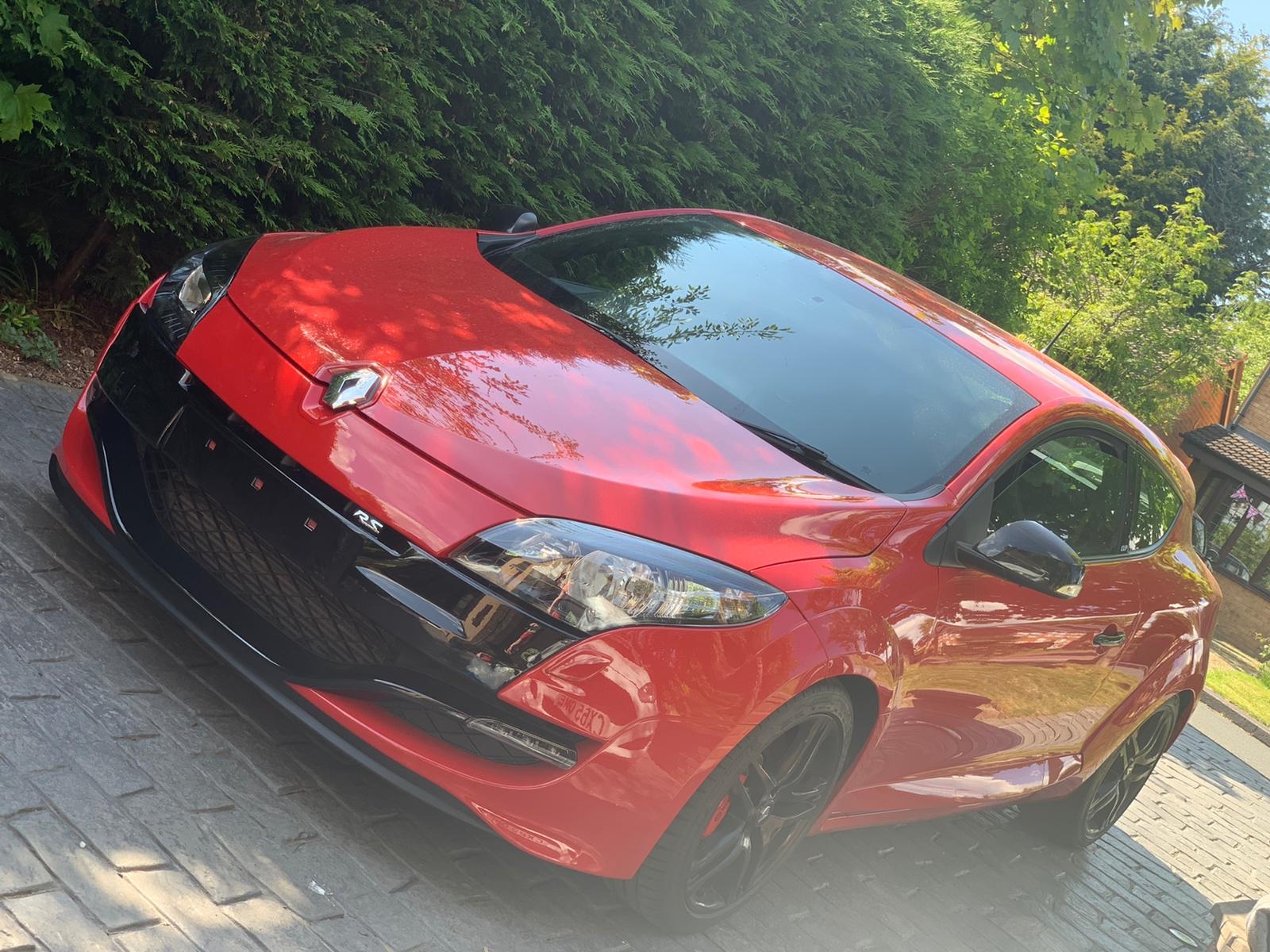

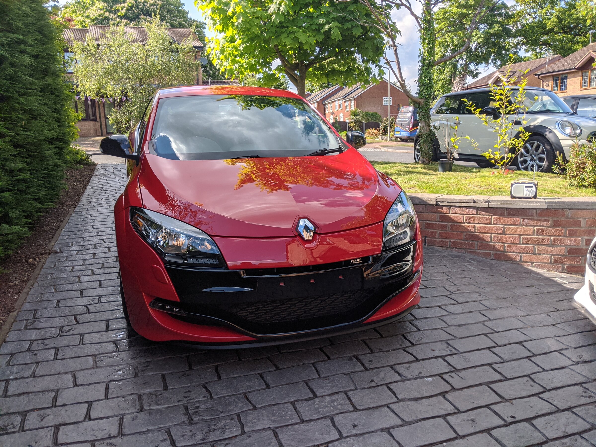

I need a red Megane. That looks so smart 👍
Cheers bud
It's had a deep clean with the lock down, wheels off, arches cleaned out, cracked out the DA etc
Just need some new plates to complete it for now 👍🏻

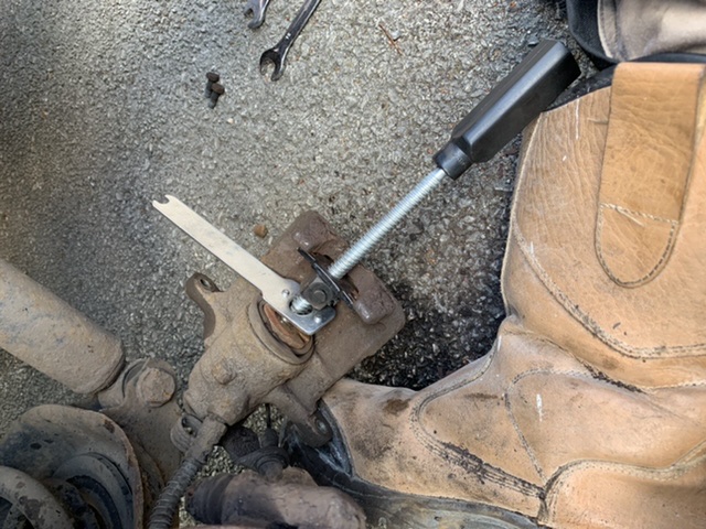

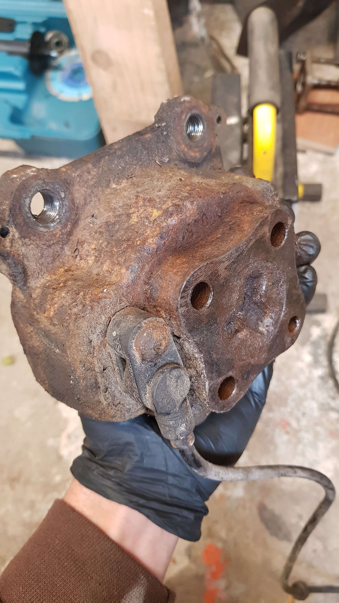

Rear brakes on the van somehow this passed an Mot without even an advisory both sides the same.
Also managed to bodge myself a tool to wind the caliper back in.

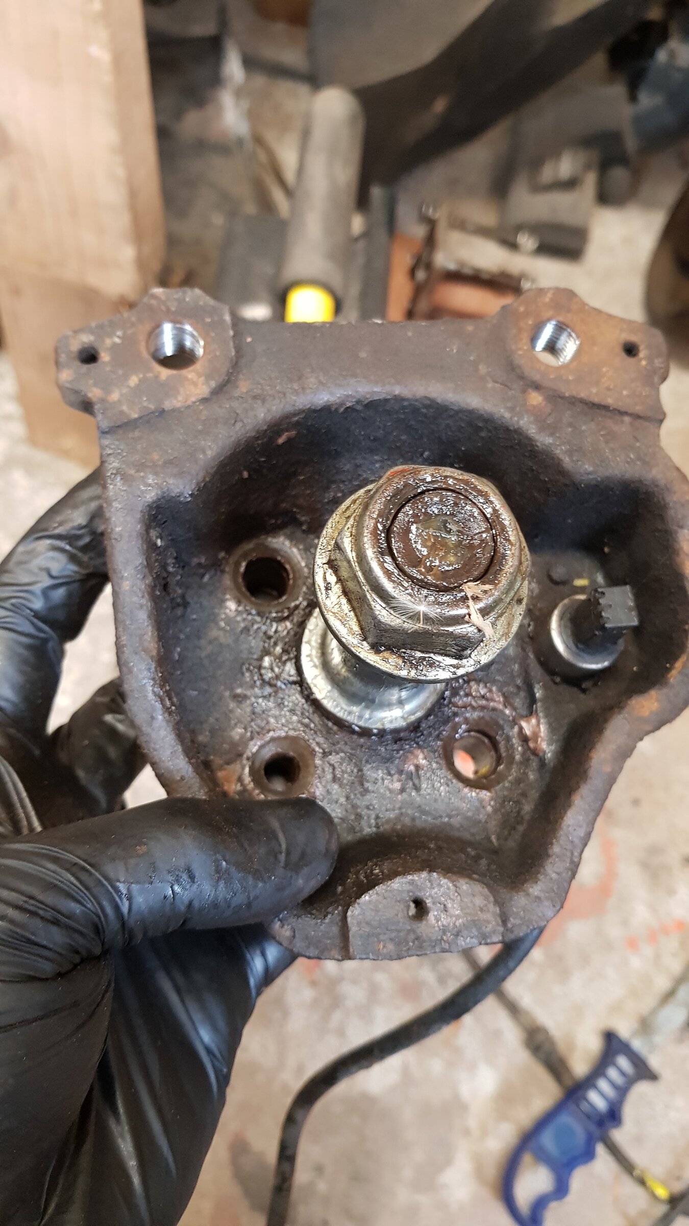

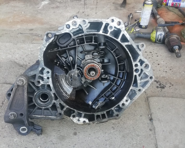

Had a customers car today which apparently had leaked oil on his drive, went round and recovered it to my garage. Turns out it was gearbox oil.
Proper job done on it
Sent from my SNE-LX1 using Tapatalk
td_dan
  Clio DCi
Looks that way, surprisingly still selected gears ok and actually drove lol

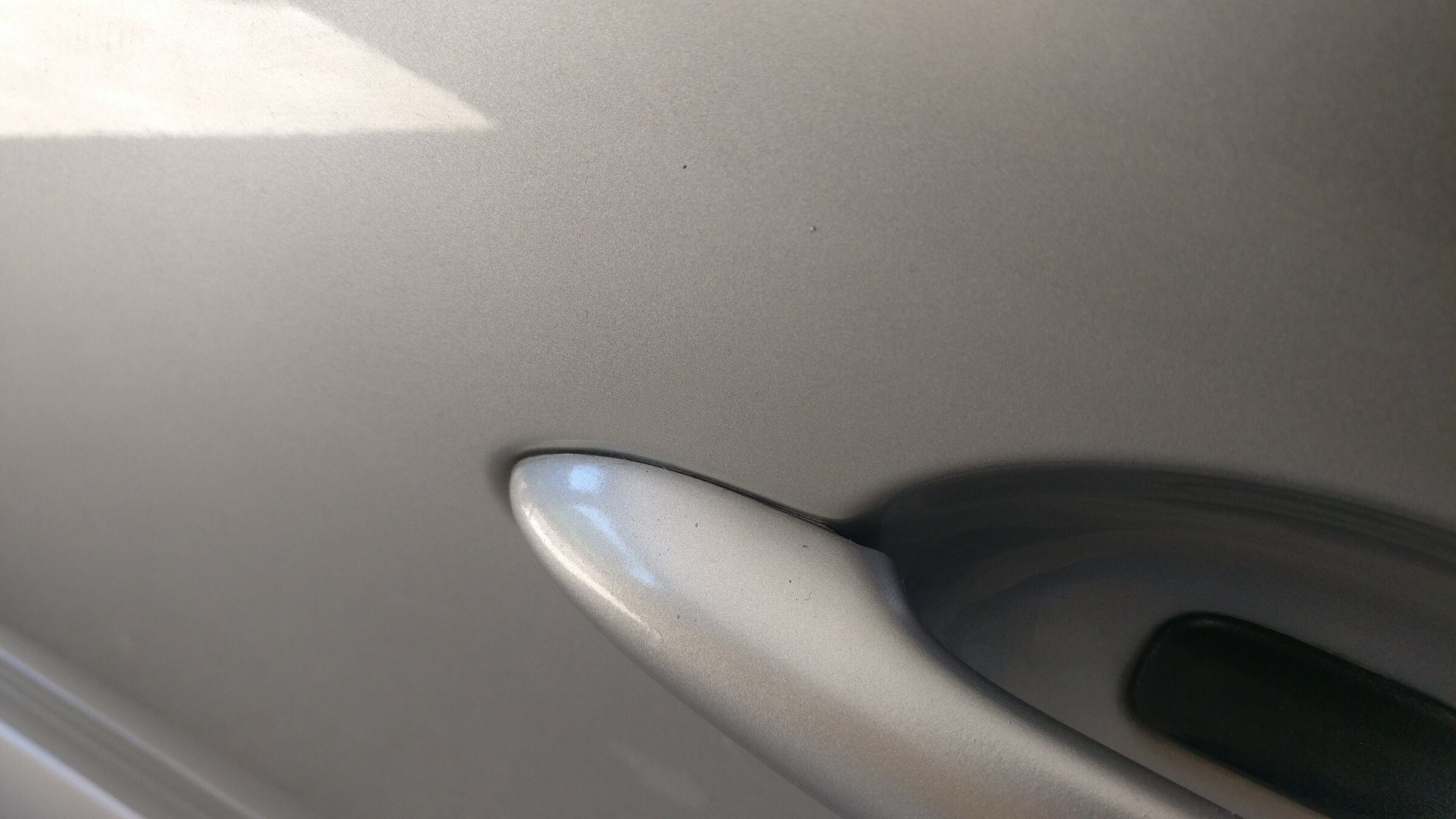

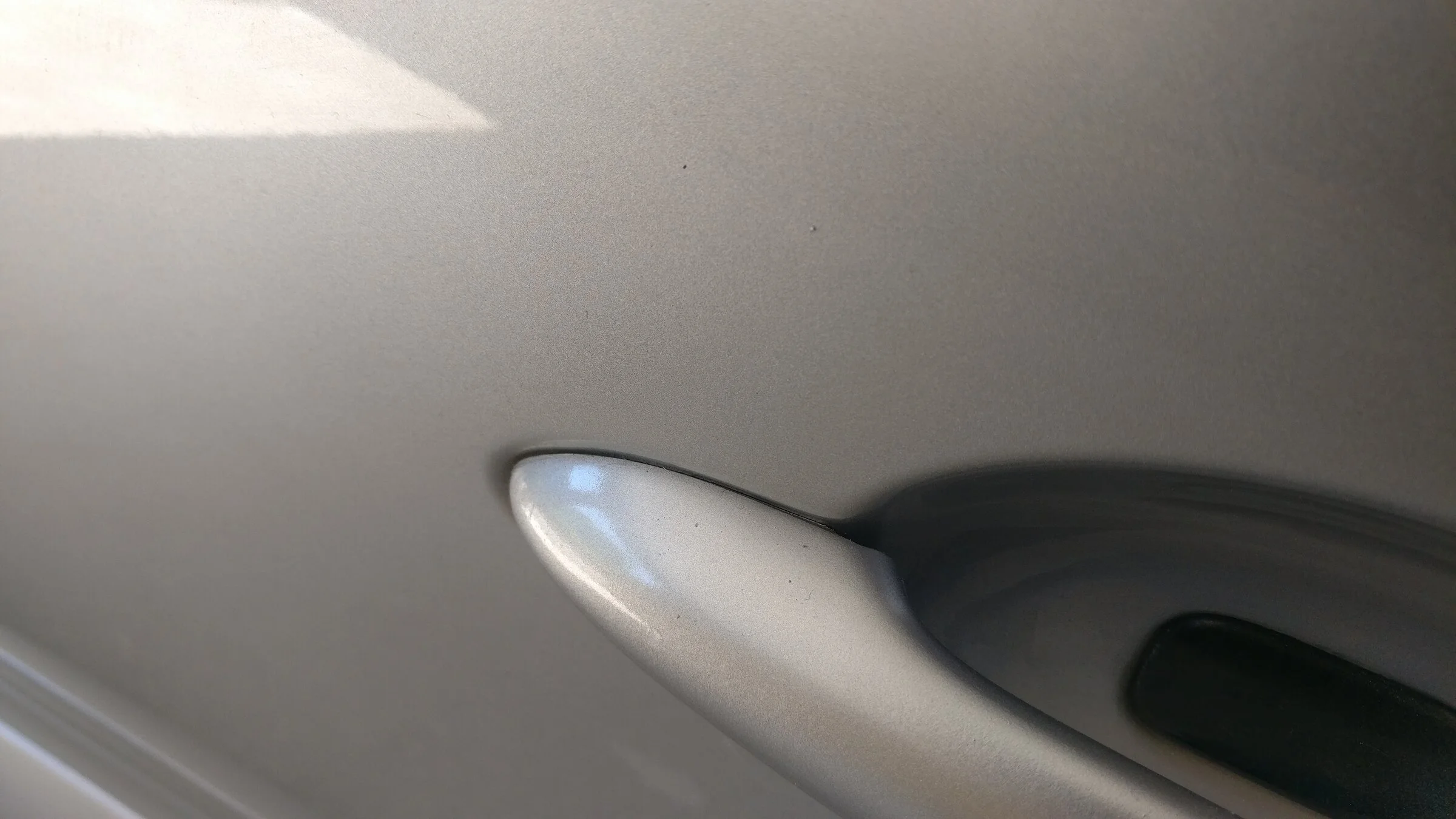

Painted the door handles. Controversial not in black 😳😳
But same color as the car!
Not bad for a rattle can, halfruards special
The little clip is missing because I cocked it up and it needs respraying

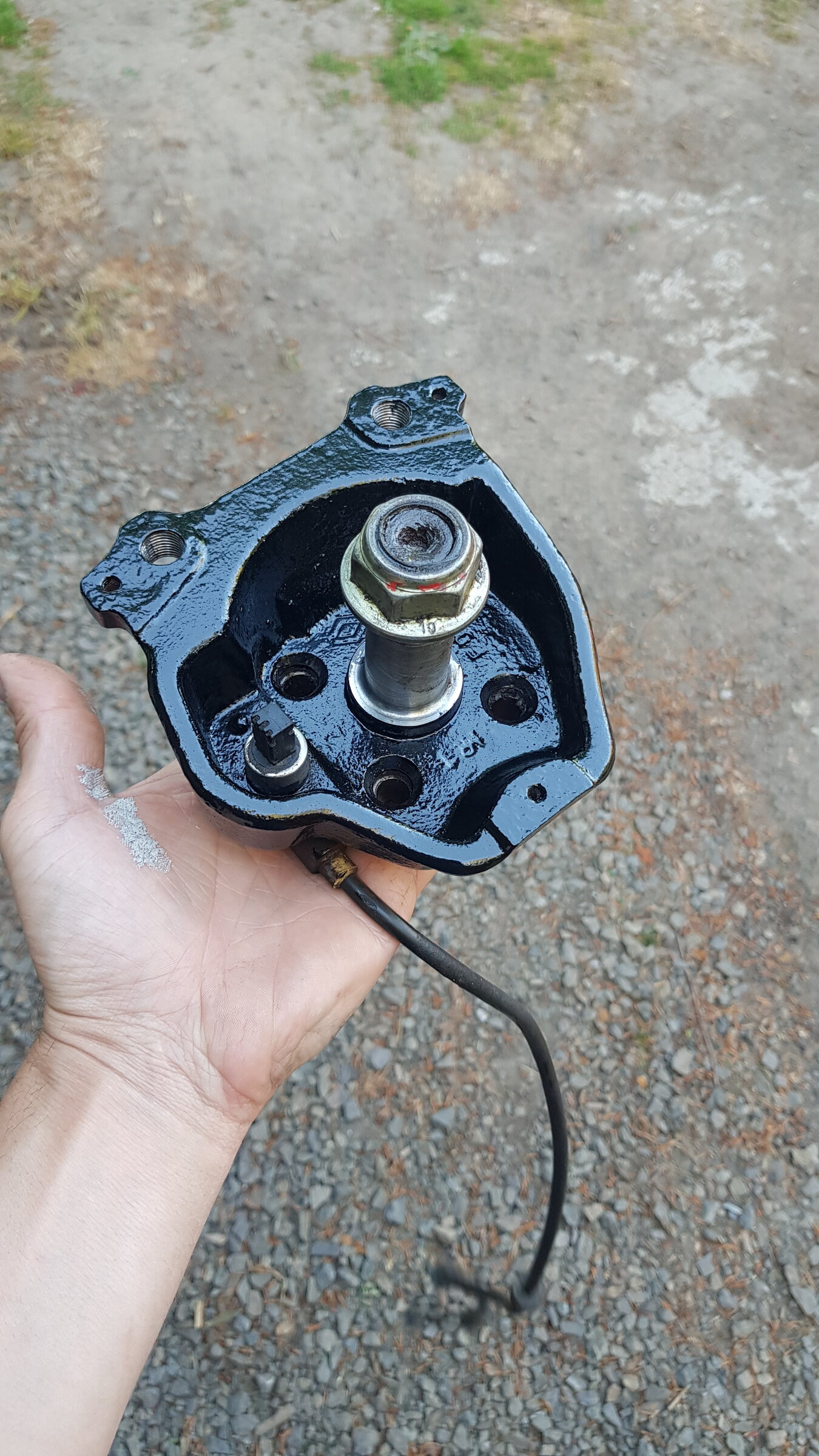

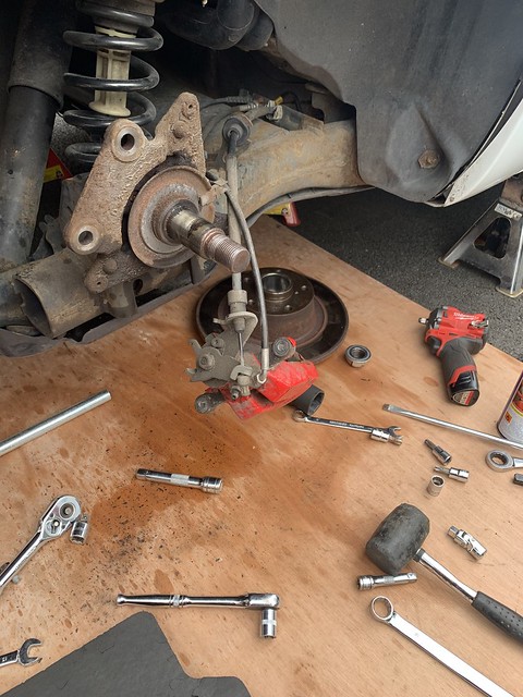

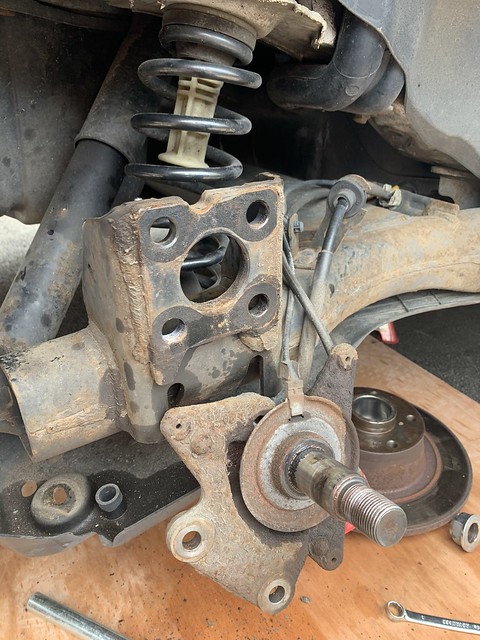

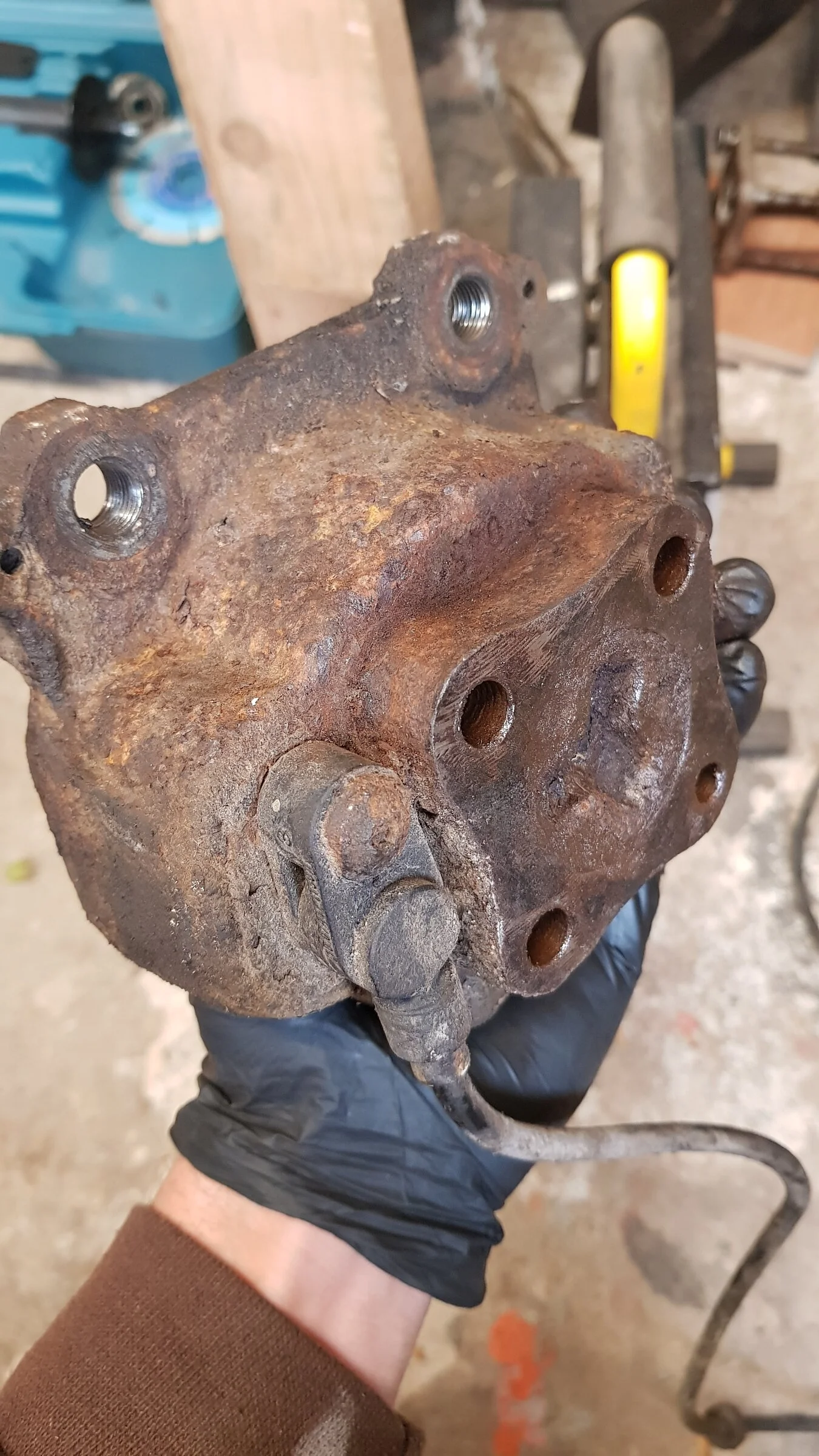

Dom, we are on exactly the same bloody page of ‘rescue a clio manual’. I refurbed my hubs last week! Got to remove my beam bushes tomorrow and drop the beam off at the blasters
Yeah I've been watching your progress, I need to order braided rear brake lines and a few clips for the heat shields then it's just waiting for the beam to come back.

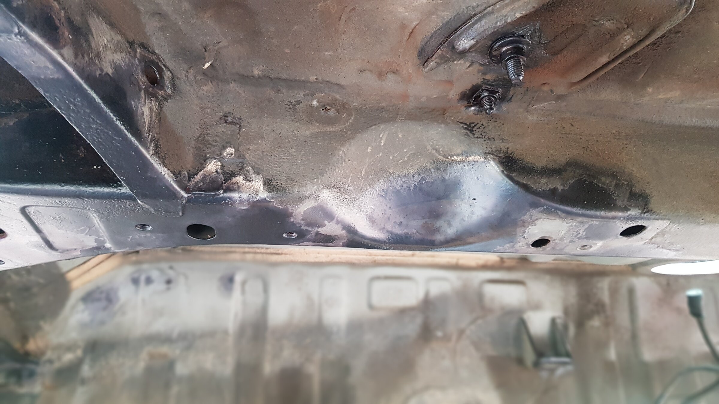

Yes mine is too, I've wire brushed, hydrate 80 and painted them with silver hammerite

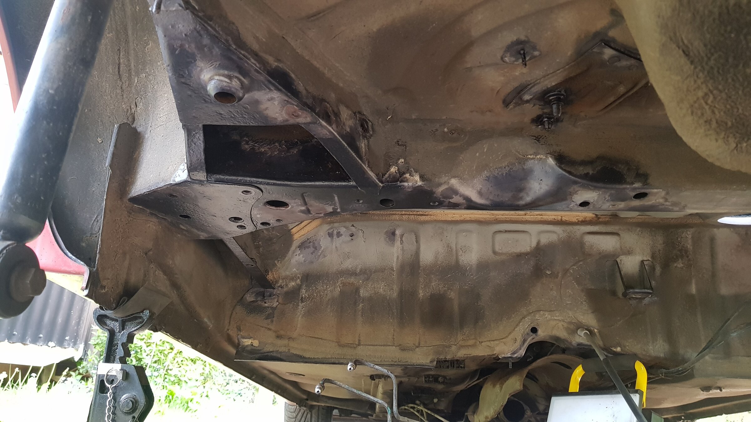

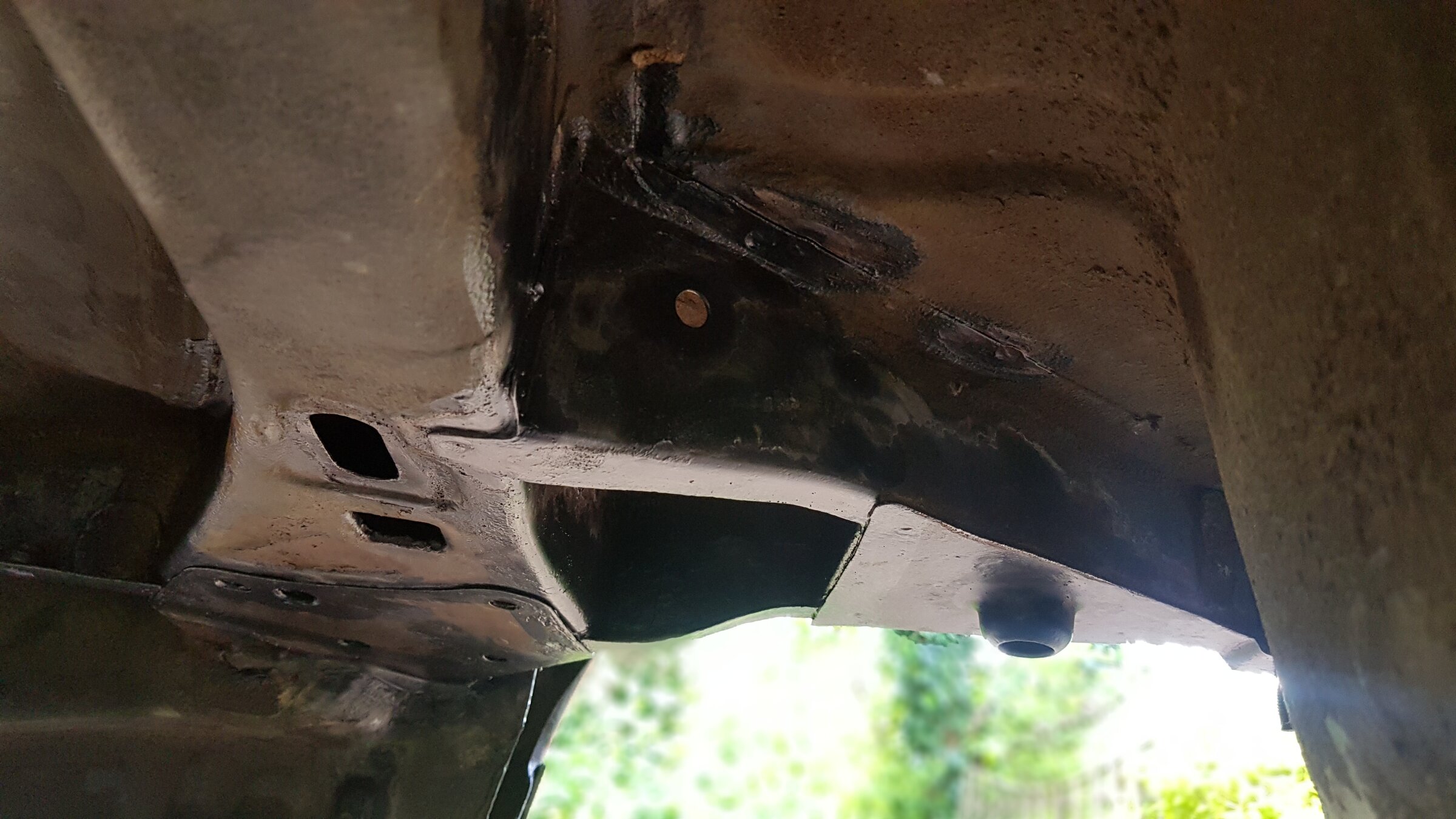

Refitted the fuel tank, heatshields and exhaust mount with stainless fixings. Fitted all fuel and brake line clips, just waiting for the beam to come back from powder coating.

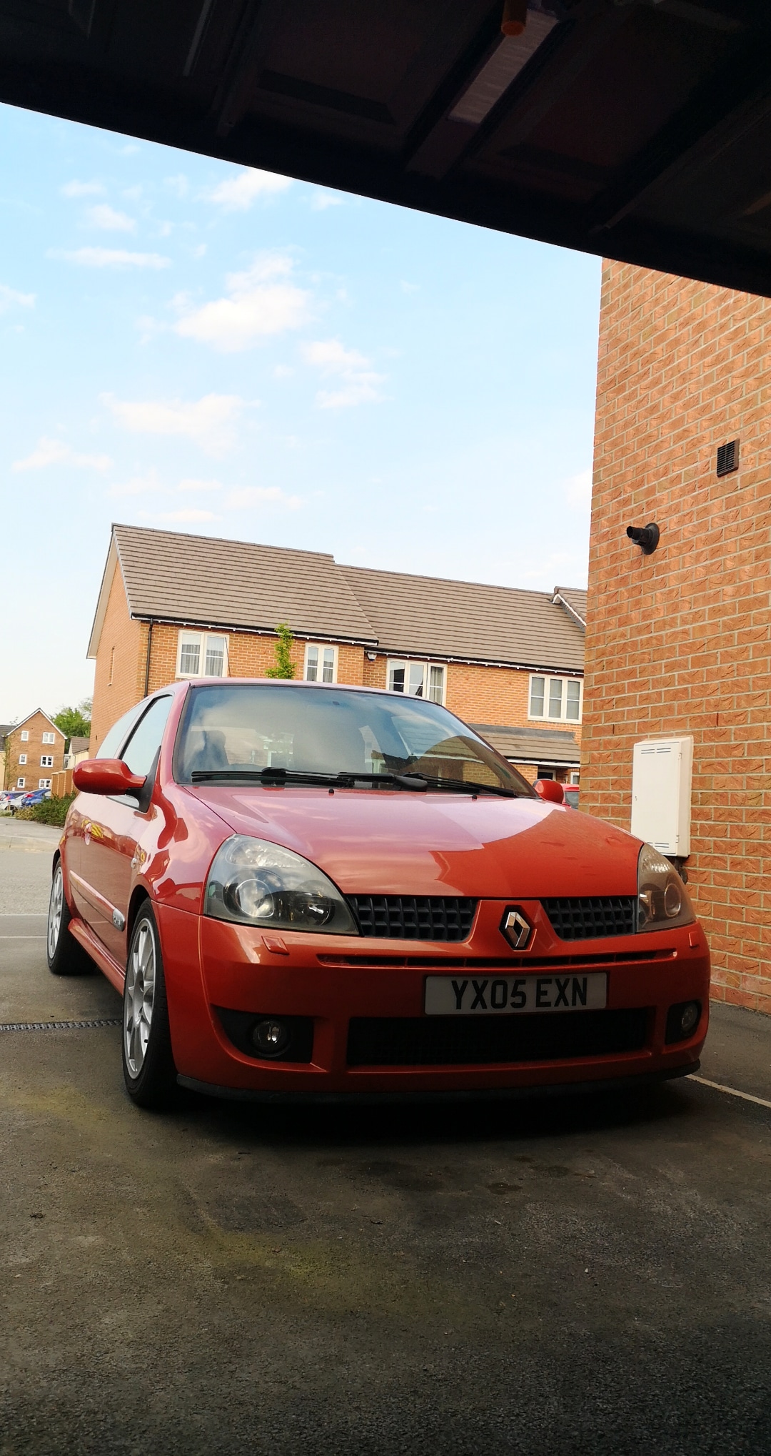

Just taxed my 182 ready for tomorrow! Will be up at 6am to go for a drive on the empty roads. Can’t wait.
Then it’ll be time for cleaning, polishing and making it look as good as new - photos to follow!
