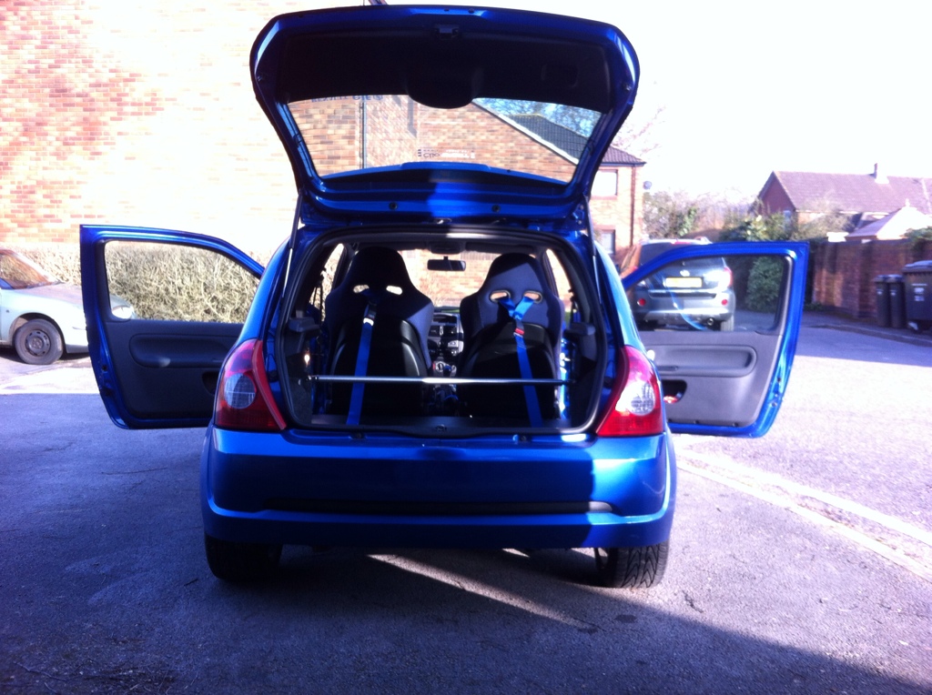

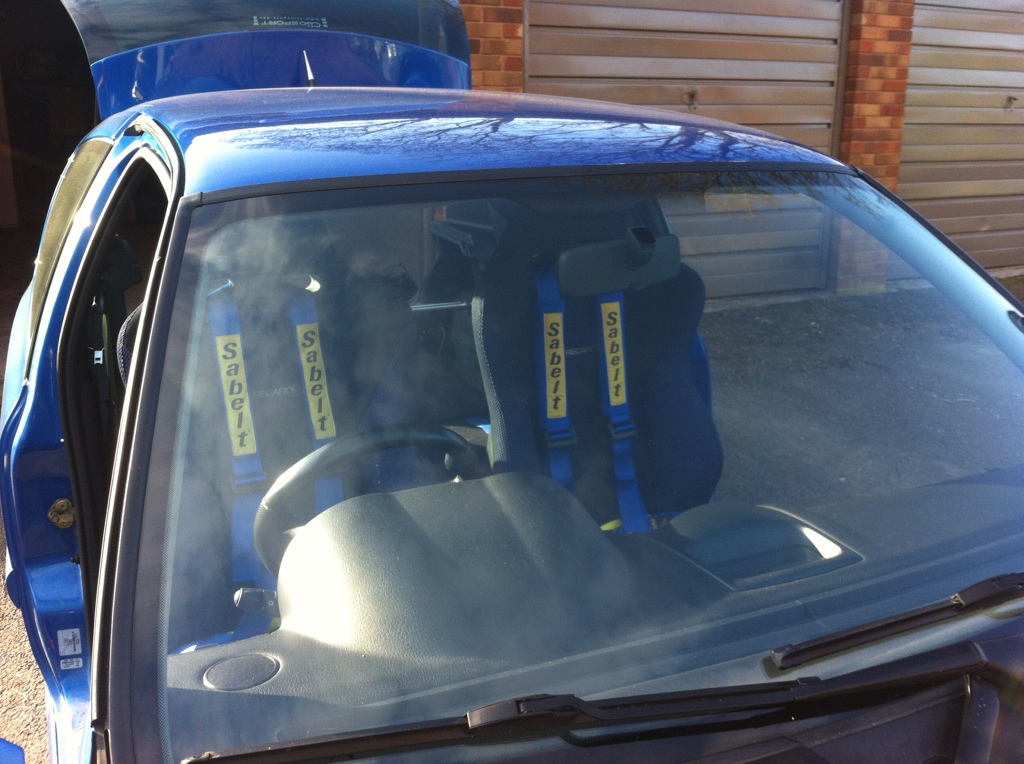

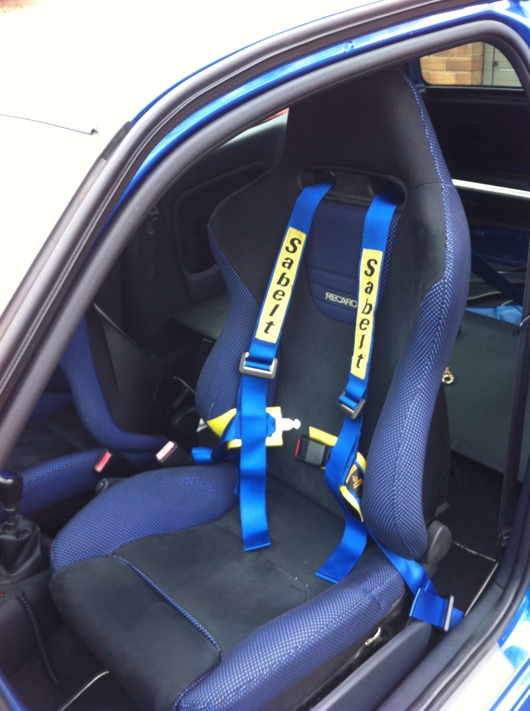

Harnesses
Be careful when wearing those harnesses that you adjust the lap straps so they sit down across your hips. So often what happens is the laps are left a bit loose and then you get in and pull the shoulder straps down tight , this pulls the buckle up to a point where it sits high , high enough that in a serious accident it can break your sternum .....
the other thing that can also happen if they aren't in the right place in an impact is you submarine downwards .
just a friendly pointer as the consequences are not nice
The passenger one hasn't been adjusted yet as no one has sat in it. The drivers one sits across my hips when I'm strapped in. Thanks for the advice
ok , just didn't want anthing nasty to happen and it was the passenger one obviously i could see :)

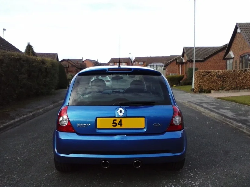

  Mondial 172Cup (A/C)

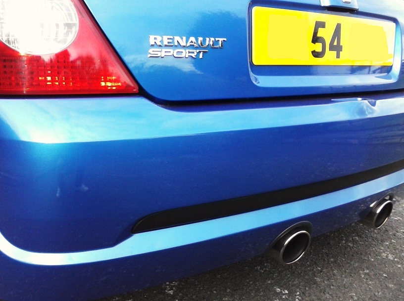

Yet another day of driving it with no rear silencer as K-Tec are playing silly-buggers with me and taking their time delivering my new Supersport system after over a week since I've ordered it!! :(

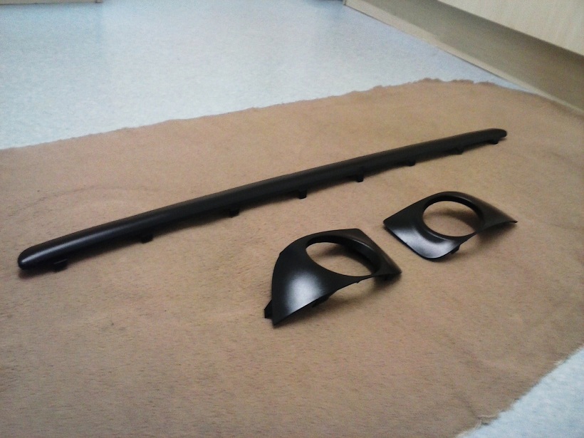

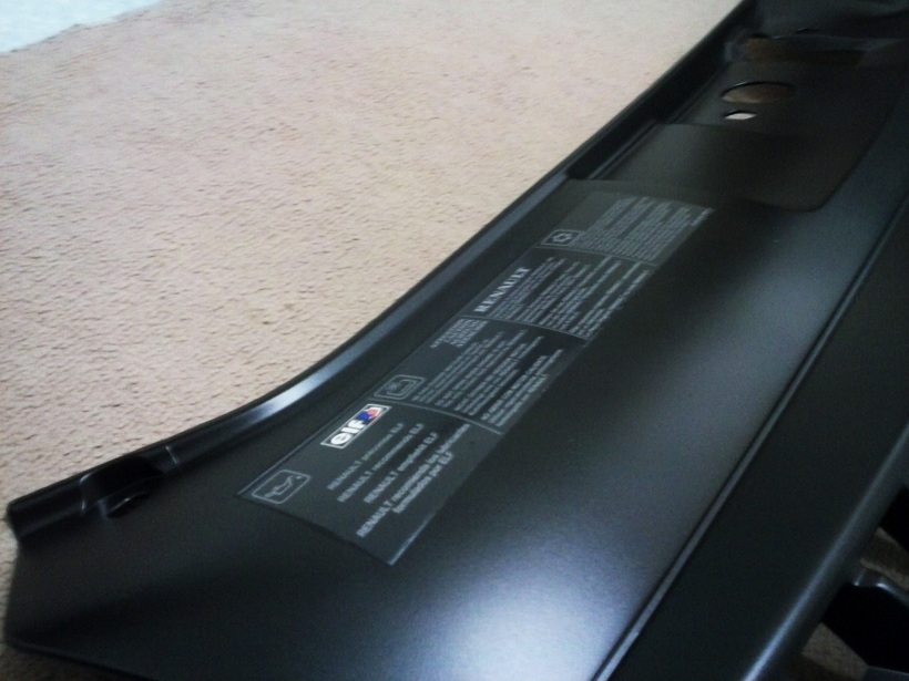

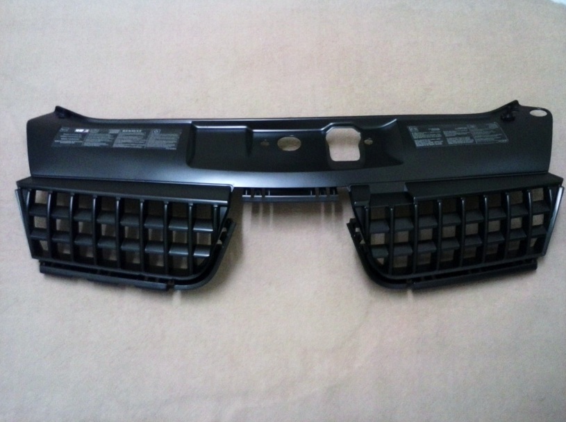

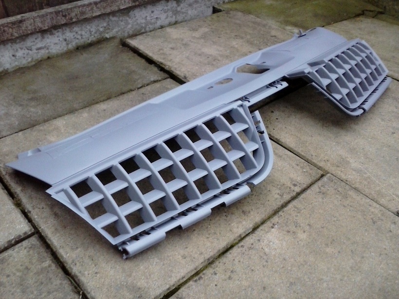

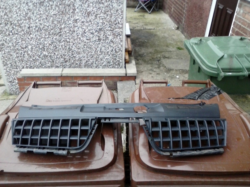

I might spray all mine this weekend as the weather is poor, what prep did you do?
The grill was cleaned, quick go over with 1500grade paper to key it as it was already smooth tbh, cleaned, dried, plastic primered then satin black which got a perfect finish so i left it at that.
The fog surrounds and bumper insert were cleaned, 600 grade paper, 1500 grade paper, cleaned, dried, plastic primered, satin black, then next day(today) i gave them another sand with 1500 grade paper to smooth them back down, cleaned, dried, satin black=smooth as silk.
I want to spray all my stuff as well, but im worried that it will all just chip really easily and quickly and then just look sh*t!
Buy some 2 pack paint which is harder, your local parts man might sell it then it wont chip as easy or probably not at all.
