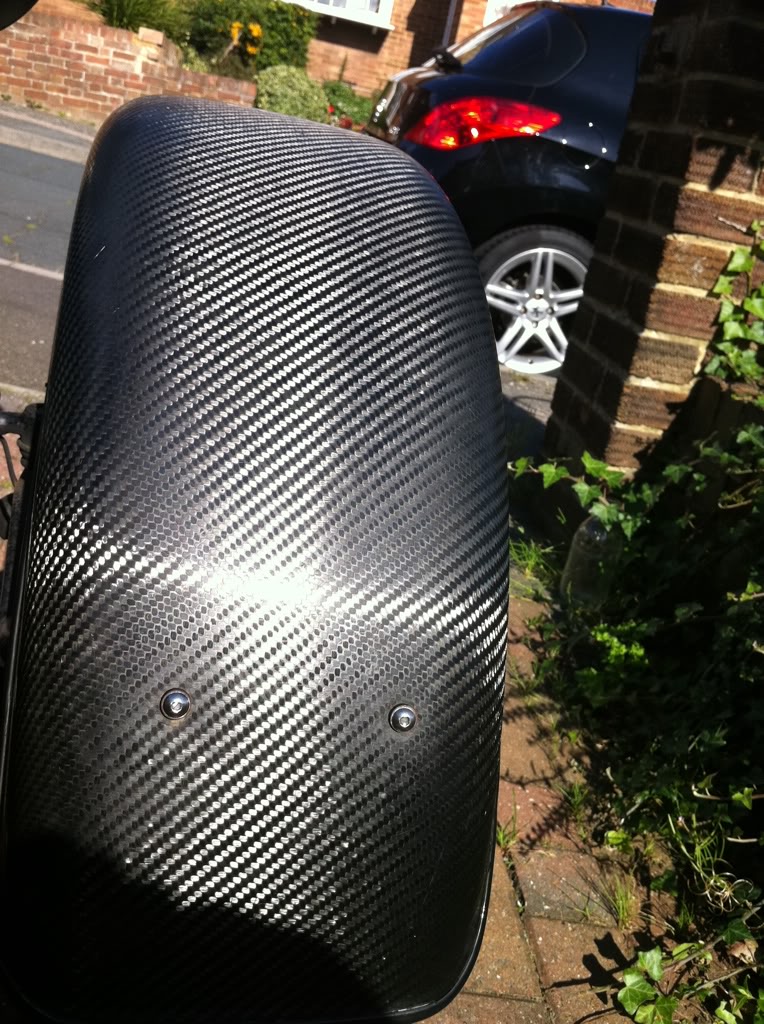

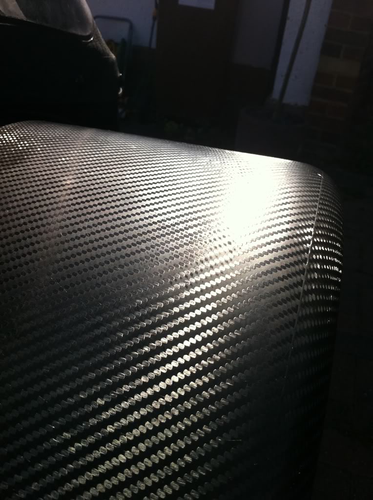

Seriously, try Mr. Muscle or Pledge.
Haters will hate, but always brings the carbon on my Caterham up a treat and lasts a good month or so.
