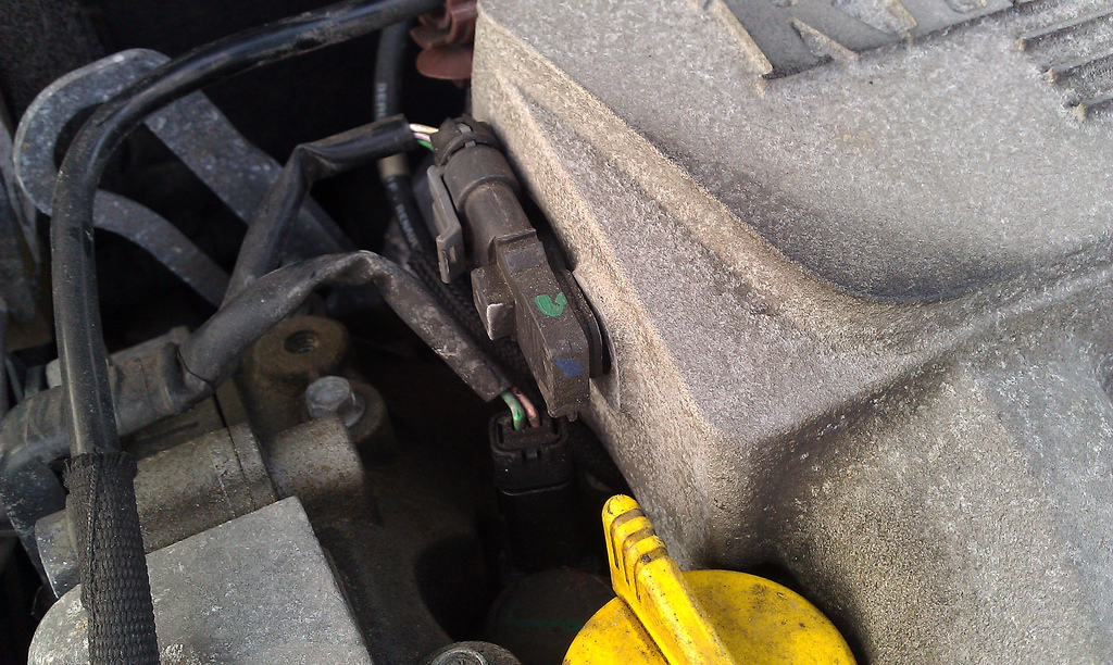

What is this Electrical Connection For
  Titanium Clio 182
I noticed it was off, plugged it in and now my ESP light has extinguished on the dashboard! It has been constantly on since my last service a month ago!
The connection i'm talking about is the one with the green paint on the plastic connection. (NOT THE ONE WITH THE GREEN WIRE)
That must have been running like a bag of nails for a month!
It's the Manifold Absolute Pressure sensor (as above: MAP). It tells the ECU the atmospheric pressure in Mbar dependent on the throttle position within the plenum chamber.
  Titanium Clio 182
Yeah it was and it has been stalling when first starting the car up!! I know I didn't un clip it so i'm wondering how its come off!!
Runs fine now!
