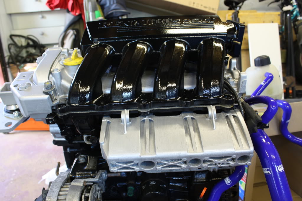

Where your finger is on the photo look down on the 'front' of the block of metal and you will see a number of holes.
The bolts are up two of them, you won't 'see' them as they are inside the guard.
You need a ratchet with a small extension bar on to get at them.
  225 Cup & Williams
There is holes on the front of it. There should be 2 13mm nuts inside 2 separate holes. Tighten them up and your sorted.
Below the metal face that your finger is pointing at there are 3 holes. 2 of them contain bolts... You will need a longer than average socket though!

You won't, your finger won't be long enough.
You can see the holes better on this picture:
  F56 MINI Cooper S
Right found it. One of the bolts has come off completly, the other one is almost come off hence it being loose as fcuk. Havnt got the tools to fix it though typically.
