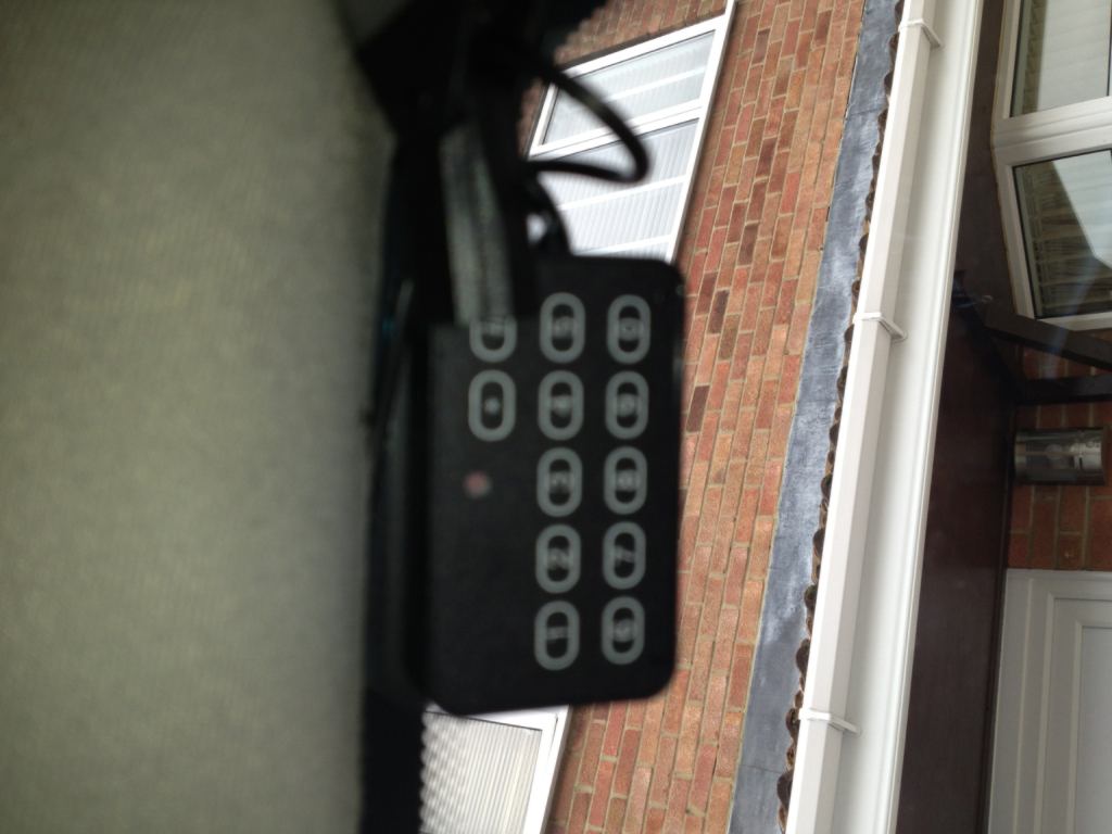

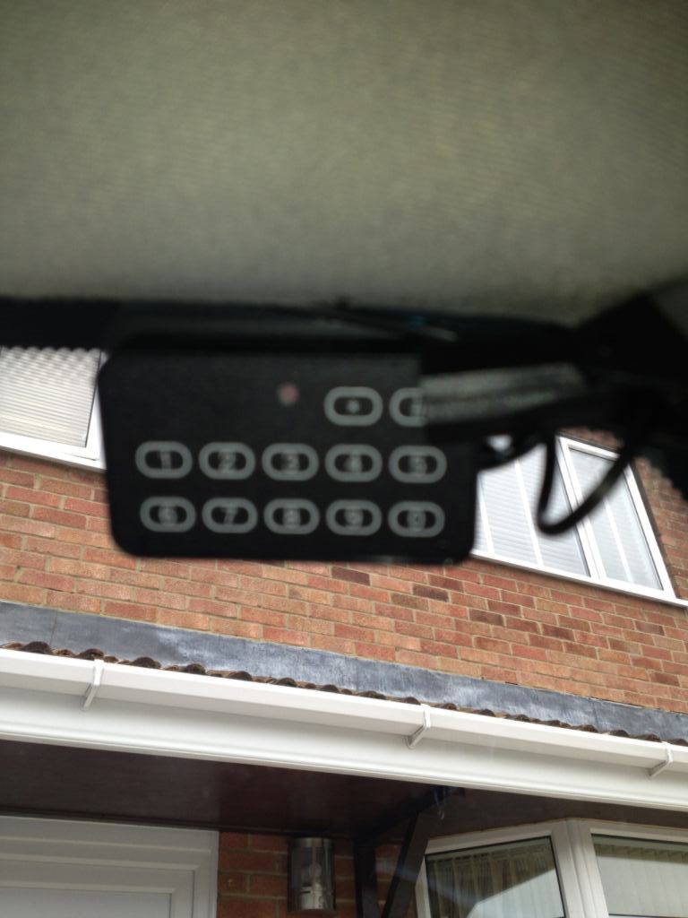

As above can anyone help me out, I have this block in the top right corner of my windscreen
And on my hazard light and in car central locking I have 2 wires, 1 going off each of them
Can any one tell what there are for?
My mate had one just like that in his 06 Astra. He has a manual its to do with the Alarm diffrent codes produces diffrent settings

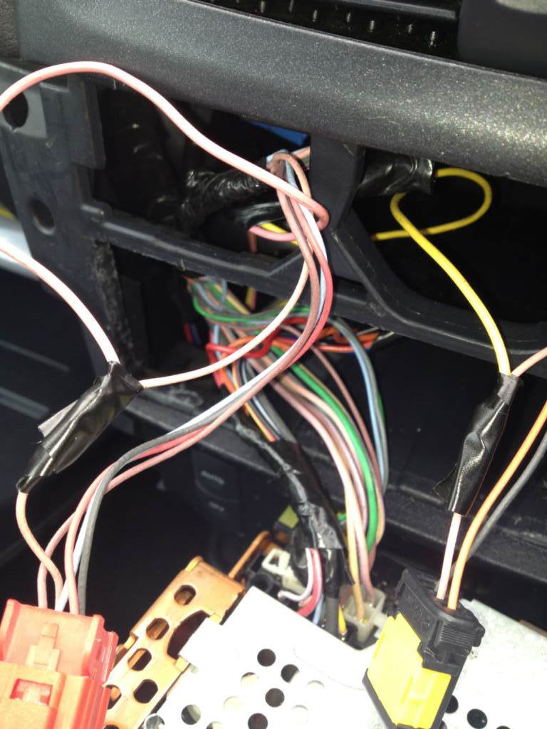

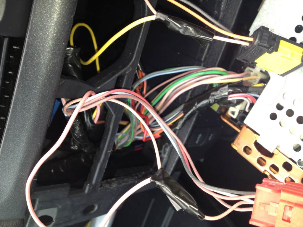

I would like to see what they used under that black tape to connect the wires ? If they used any
Citroen used a keypad immobiliser on some models for a few years but dropped them after a lot of complaints. Plus the built in alarm systems became more widely available.

We sell cars to people with poor credit. Part of the deal is that a tracker/immobiliser is fitted to the car. Everytime they make a payment, they get a pin number to put into the car and that de-activates the immobiliser for the next calender month. If they fail to make a payment they don't get a pin number and the immobiliser cuts in.
That looks like one of those.

Think someone got it right with the sigma. I've got a UK impreza turbo and they have these from standard in the glove box. It's like a pin pad over ride for the alarm/immobiliser. Sometimes the remote doesn't work (these specific sigma's get a lot of tetra interference) and you have to unlock the car manually and punch the code in to deactivate the alarm.
Same as mine I have a sigma alarm with the keypad in the top right , although mine doesn't work either , it's just working on the fob not the pad !
its a pain kn the arse don't know why it's been fitted they have a alarm standard ! Mines a UK car not a import I have the receipt for fitting ! Need to work it out though lol!

from what I can see it's the stanard loom pulled out of the dash to show two spliced wires ffs? All the 'wiring' that's not oe there are the two wires, which might very well be soldered on under the tape and may or may not even be anything to do with the alarm.
do people realise what the loom looks like behind the dash?
