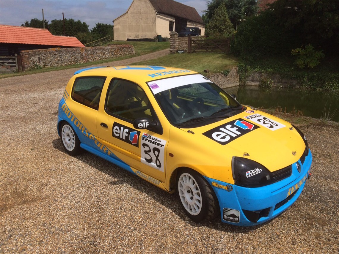

Interesting read. I've always wanted a cup car and after missing out on a mint one I jumped in feet first and bought a bad one. Car number #11 so I presume it should have the older bits.
I've just started a winter/spring rebuild.
I took it to Croft for a test and after 2 x 20min sessions had to retire.
Over heating and clutch packed in.
Did a leak test and there's an issue. no idea why the clutch won't engage, will investigate later.
I have started the rebuild and will no doubt be using the search facility on here. It will be interesting to if the parts are as described. It has had a few mods and some original stuff is no more.
Kicking myself that I didn't walk away but after forking out for the car I need to make something out of it.
