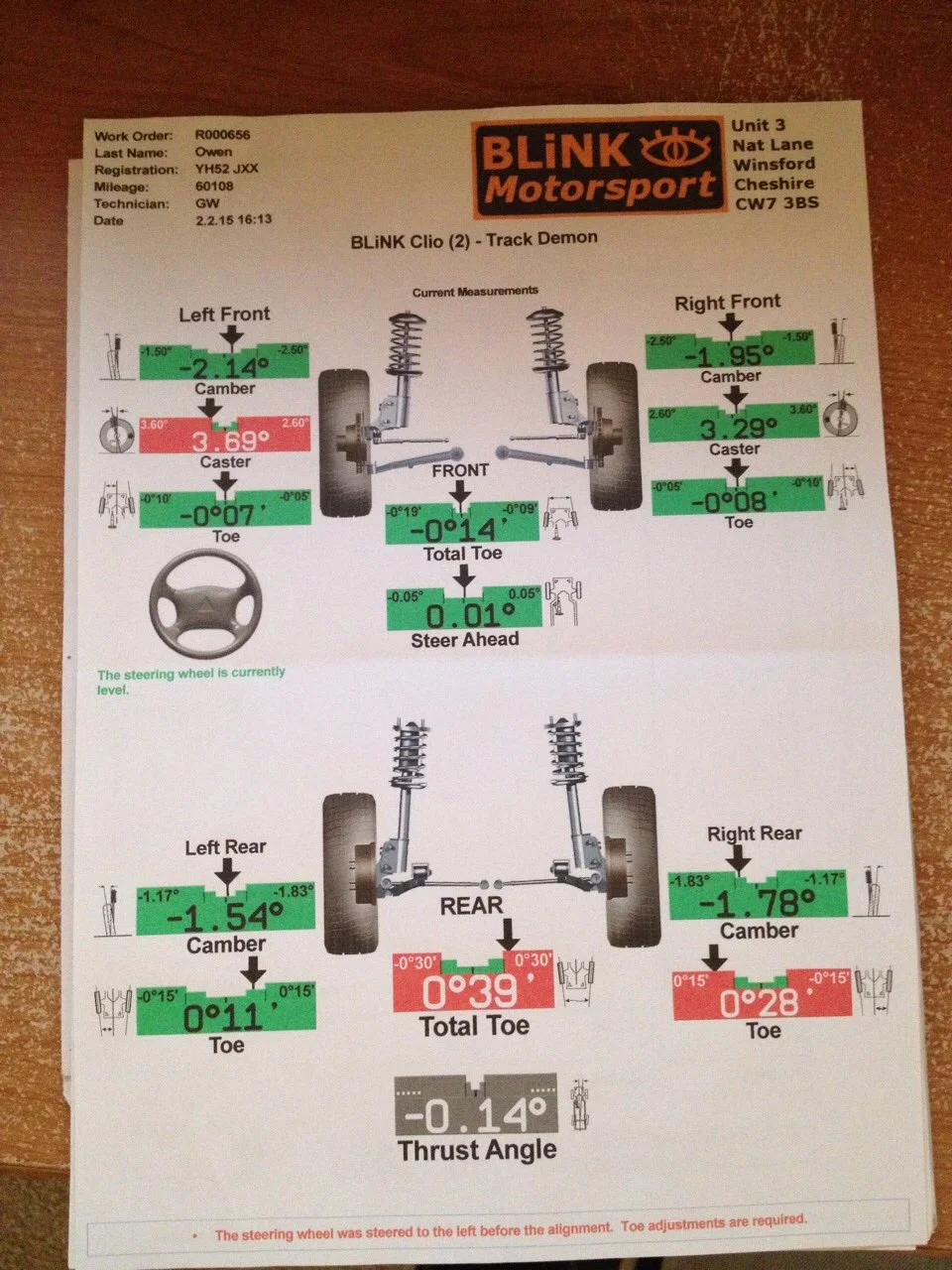

I had my car set up a while back at Blink and I needed some rear shims too sort out the toe but I'm looking for shims and don't want too buy the wrong ones. Below is my printout I was given and as you can see the rear toe on one side is out or in lol so I'm going too have it redone soon as I'm having new track rods/ends done on the front so may as well have the rear sorted and checked. So could anyone help me out as too what degree or percent shims I would need to correct that toe.

Either a 10 or 20 minute shim you need from Pure Motorsport.
Obviously 20 will bring it down to 0'08 and 10 will be 0'18.
20 minute being a closer match to the left side of 0'11.
