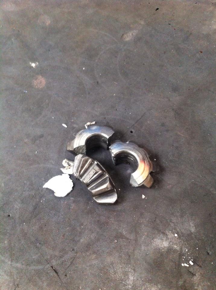

At the time we thought it was coming from the engine, possibly either the oil breather or crank seal. On driving home there was a quiet whine from 5th gear which I didn't like the sound of. When I drive it to the garage there was a loud bang and then no drive!!
Now it has been put up on the ramp there is a hole in the gearbox and the planet gear is in several pieces!!
So the gearbox is shot but i'm not sure what I should do next, as far as I can see there are 3 options:
*Get a second hand or a reconditioned gearbox and put a new clutch and slave cylinder in
*Sell the car as it is
*Break the car for spares
I know that it will probably cost £500-£600+ for labour, the box, clutch etc plus I also know that I need 1 rear shock so I might as well replace the rear pair, with the costs mounting up and the fact the belts will need doing next year on the engine i'm after some advice about what I should do and what people think the car is worth as it is etc etc.

Yeah I know the smoke was pretty bad and must have left a bit of oil! Think the oil was from the hole in the gearbox which got onto the manifold. The engine appears to be fine and the oil level is fine so just seems to be gearbox.

That is my problem as I have only just done the rear discs and bearings and ABS pump before the track day! Just difficult to know when to stop really and whether it is better to know your car & fix or buy another!

Gearbox's aren't the strongest if not looked after to be honest..
If you can do it yourself I would get a 2nd hand one send it to Agency to get it checked over and throw it in...
  Cup In bits
Shocks a gearbox and timing belt isn't exactly a huge deal but could understand breaking if you were paying garage prices for the work. They could easily need done on your next one too tbh, those faults are 3 of the most common things on a Clio sport to need replacing.

Yeah I have heard they are not the strongest boxes in the world and a pig to remove. Unfortunately I'm not a mechanic so won't be able to do it myself but do have some friends who are in the trade who would help me out a bit but will still cost! Who are agency? We have a gearbox specialist in Somerset not sure how much they would charge to look over a gearbox?
As above I will be doing it through a garage but will get some discount. I was going to leave the belts but I don't know if it is any easier to do if the box is coming out anyway? If I keep the car will put cup shocks on as they are the same price.
Ahh, ok. I didn't realise that.
​In that case then, i'd get your engine compression tested, make sure it's a good'un and do the box/belts. Like you say, better the devil you know!
Yeah that might be an idea to check first. Pulled 175.6bhp at Tipton with decat, V6 airbox, RS tuner map and powerflow decat back so I would say that was alright compared to others on the day

take the engine and box out in one replace the gearbox and do the belts whilst the engine is out its so much easier.
gez 172
  Defender 110
It's also a lot cheaper to have the belts done while the engine is out.

I would get the gearbox done and new clutch same time. Will cost you £500+ but nothing much else you can do. Either that or sell your car for under a grand!

Thanks for that, might give them a ring and see, would need to get the box up and back to them, which is additional costs, I assume they don't keep those boxes on the shelf or anything?
Yeah that sounds like if I keep it best to do the whole lot in one go then at least good for 5 years/75k
Yes, would do that if I keep the car as above :)
