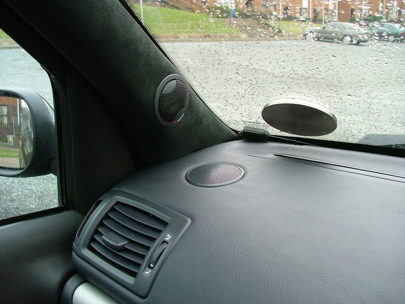

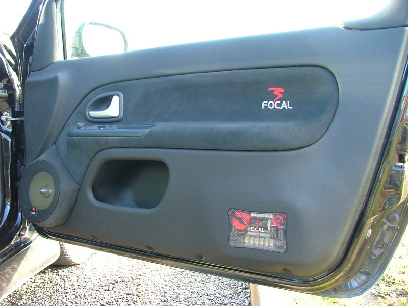

I see what you mean - I have pods built for my tweeter pillars & comps in the doors.
I know exactly what you mean about the soundstage etc - I'm always trying to explain it to mates who think Halfrauds can give them a great install with 6x9s blah blah blah :slap:
  "Navy" N17 TWO
the tweeters on the clio are just in a really bad position on the dash. they take your face off when there loud. on a decent hi fi system in a car the tweeter should be as close to the mid as possible to give a much better sound stage. the a pillars are ok but only work with very specific component sets. ie high end equipment which have been developed to work in that a pillar position. most just get a hideous sound reflection off the windscreen bein up there.
Professionaly set up & fabricated to produce the best SQ :approve:
  Mk2 172
looks good mate. could do with a tad more angle towards you but other than that they look pretty good :)
  Mk2 172
yeah look really good. looks well finished and trimmed. i taki there sixes in the doors. get much more mid bass with the sixes
